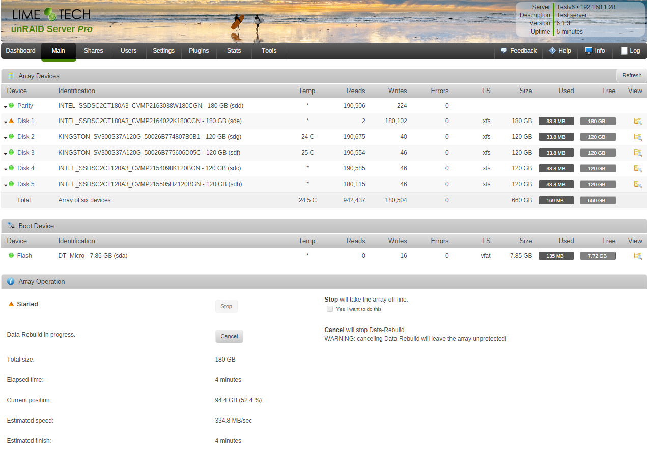

I believe the issue is not the driver or the controller itself, but for some reason the way a parity check works in Unraid does not go well with this card.
Using a script I found on the forum these are the results for simultaneous reads of 6 SSDs on the SAS2LP
 sdb = 391.98 MB/sec
sdd = 391.84 MB/sec
sde = 392.20 MB/sec
sdc = 392.18 MB/sec
sdg = 436.42 MB/sec
sdf = 427.27 MB/sec
So the card and driver are working ok and it has plenty of bandwidth.
Note that the parity sync speed is also normal:
Now a parity check on the same system:
For comparison here are the results with the same hardware but replacing the SAS2LP with a Dell H310
Bandwidth test:
sdd = 413.83 MB/sec
sdb = 441.63 MB/sec
sdc = 467.75 MB/sec
sdg = 435.47 MB/sec
sdf = 467.66 MB/sec
sde = 442.71 MB/sec
Parity sync:
Parity check:

VERY interesting results !!    Clearly the card & driver are working fine ... and indeed the parity check WORKED fine with v5.    SOMETHING has clearly changed in v6 r.e. the parity check that is causing these issues => I have to wonder if this is also the reason the parity checks are using so much more CPU % then with v5 (which is counter-intuitive, since the 64-bit OS should be more efficient) ... and thus causing slower parity checks in many cases [e.g. when I updated my oldest server from v5 to v6.1.3 the parity check time increased by 31%].
Particularly interesting that the parity sync is still at full speed.    Can you try one more test?  Do a drive rebuild and see if that's at the "good" speed shown with parity sync or the "bad" speed that a parity check displays.
FWIW, I did a drive rebuild when I first got the cards a couple weeks ago and it went at much higher speeds than the SASLPs that I replaced. After it made it up to the SATA III drives, I was getting in the 90s for MB/s.
I get phenomenally low parity checks for some reason as well. It went all the way down to 1 MB/s before I just canceled it.
Sounds like the rebuilds work fine ... but it'd be nice to see the results of doing this on Johnnie's setup, with an all-SSD array  :)
Disk rebuild speed is also normal, issue seems limited to parity checks.
Thanks for the extra data point => hopefully this will provide Limetech the clue they need to isolate why this issue is happening ... you've certainly exonerated the card and the driver, as clearly both are working just fine with both parity syncs and disk rebuilds -- and there's certainly not a different set of drivers used for the parity checks.

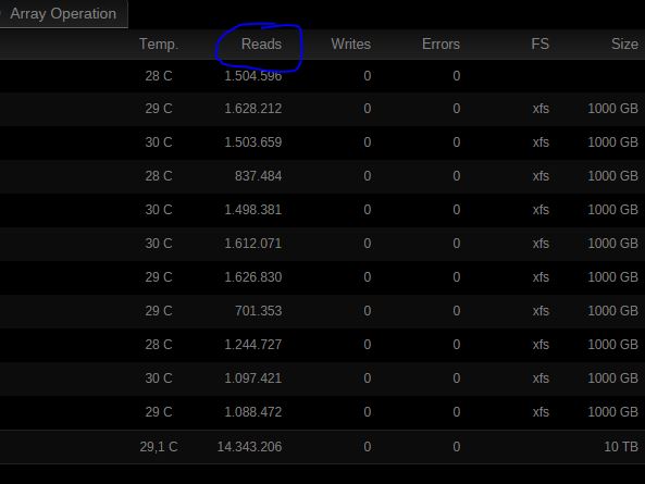

What I noticed and posted already some time ago is, that the read counts in UnRaid GUI are not counting up the same on parity checks. With V5.x, the counts ("Reads" in GUI) had been very close to be the same for all disks, which seems "logical" (assuming, nothing else accesse the disks except the parity check). With V6 they have big differences. Didn't get an answer from Tom yet, how and where those counts are taken in the software - maybe that could give a hint why and where the speed degradation is caused.
The read counts have been different for a long time ... starting with v5.  I think that simply depends on the controller, the interface (IDE vs. SATA) and the access mode (should be AHCI for all modern drives).    But in any event, that's not likely the underlying reason for the difference.    But there IS a notable difference -- as this thread notes, it's not just a difference in the CPU % in v5 vs. v6, but also a significant difference between parity syncs and drive rebuilds vs. parity checks.    Definitely strange -- and it'd certainly be nice to see it resolved.
