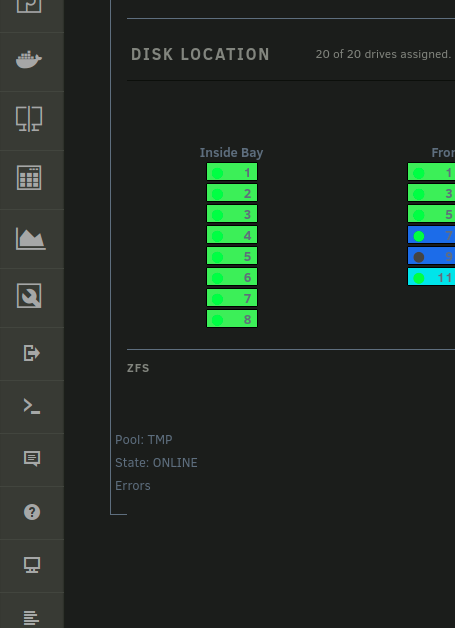

I've started to create a dashboard section for ZFS details. let me know if you can help me out with PHP/JSON/BASH
I don't really know what i'm doing just trial en error, modifying an existing plugin (corsaircpu, status.php & status.page)
https://github.com/ezraholm50/zfs-frontend-unraid
Edited by ezra

@ezra How do I actually install your dashboard?  Do I just put the files in the config directory somewhere?  Thanks.
Install the corsairpsu plugin from CA, then edit the files status.php and status.page in: /usr/local/emhttp/plugins/corsairpsu/
still working on it. Could use some help.
Edited by ezra

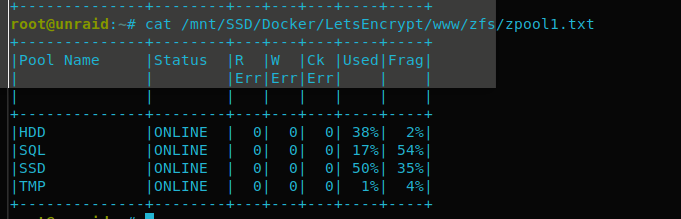

Here is an update for an overview of your pools. I use this with user scripts cron and paste the output to an nginx webserver, home assistant grabs that data and displays it:
logfile="/tmp/zpool_report.tmp"
ZPOOL="/mnt/SSD/Docker/LetsEncrypt/www/zfs/zpool.txt"
pools=$(zpool list -H -o name)
usedWarn=75
usedCrit=90
warnSymbol="?"
critSymbol="!"
  echo "+--------------+--------+---+---+---+----+----+"
  echo "|Pool Name     |Status  |R  |W  |Ck |Used|Frag|"
  echo "|              |        |Err|Err|Err|    |    |"
  echo "|              |        |   |   |   |    |    |"
) > ${logfile}
for pool in $pools; do
  frag="$(zpool list -H -o frag "$pool")"
  status="$(zpool list -H -o health "$pool")"
  errors="$(zpool status "$pool" | grep -E "(ONLINE|DEGRADED|FAULTED|UNAVAIL|REMOVED)[ \t]+[0-9]+")"
  readErrors=0
  for err in $(echo "$errors" | awk '{print $3}'); do
    if echo "$err" | grep -E -q "[^0-9]+"; then
      readErrors=1000
      break
    fi
    readErrors=$((readErrors + err))
  done
  writeErrors=0
  for err in $(echo "$errors" | awk '{print $4}'); do
      writeErrors=1000
      break
    fi
    writeErrors=$((writeErrors + err))
  done
  cksumErrors=0
  for err in $(echo "$errors" | awk '{print $5}'); do
      cksumErrors=1000
      break
    fi
    cksumErrors=$((cksumErrors + err))
  done
  if [ "$readErrors" -gt 999 ]; then readErrors=">1K"; fi
  if [ "$writeErrors" -gt 999 ]; then writeErrors=">1K"; fi
  if [ "$cksumErrors" -gt 999 ]; then cksumErrors=">1K"; fi
  used="$(zpool list -H -p -o capacity "$pool")"
  if [ "$status" = "FAULTED" ] \
  || [ "$used" -gt "$usedCrit" ]
  then
    symbol="$critSymbol"
  elif [ "$status" != "ONLINE" ] \
  || [ "$readErrors" != "0" ] \
  || [ "$writeErrors" != "0" ] \
  || [ "$cksumErrors" != "0" ] \
  || [ "$used" -gt "$usedWarn" ]
  then
    symbol="$warnSymbol"
  else
    symbol=" "
  fi
  printf "|%-12s %1s|%-8s|%3s|%3s|%3s|%3s%%|%4s|\n" \
  "$pool" "$symbol" "$status" "$readErrors" "$writeErrors" "$cksumErrors" \
  "$used" "$frag"
  ) >> ${logfile}
  done
) >> ${logfile}
cat ${logfile} > "$ZPOOL"
Edited by ezra

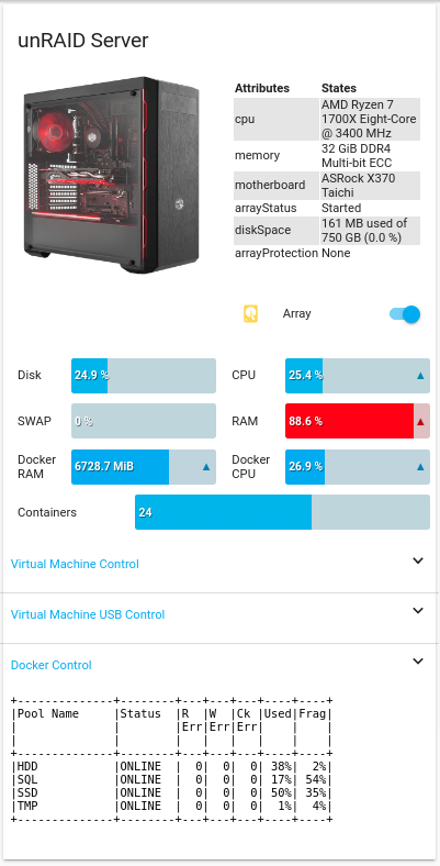

logfile="/tmp/zpool_report.tmp"ZPOOL="/mnt/SSD/Docker/LetsEncrypt/www/zfs/zpool.txt"pools=$(zpool list -H -o name)usedWarn=75usedCrit=90warnSymbol="?"critSymbol="!"( echo "+--------------+--------+---+---+---+----+----+" echo "|Pool Name     |Status  |R  |W  |Ck |Used|Frag|" echo "|              |        |Err|Err|Err|    |    |" echo "|              |        |   |   |   |    |    |" echo "+--------------+--------+---+---+---+----+----+") > ${logfile}for pool in $pools; do frag="$(zpool list -H -o frag "$pool")" status="$(zpool list -H -o health "$pool")" errors="$(zpool status "$pool" | grep -E "(ONLINE|DEGRADED|FAULTED|UNAVAIL|REMOVED)[ \t]+[0-9]+")" readErrors=0 for err in $(echo "$errors" | awk '{print $3}'); do   if echo "$err" | grep -E -q "[^0-9]+"; then     readErrors=1000     break   fi   readErrors=$((readErrors + err)) done writeErrors=0 for err in $(echo "$errors" | awk '{print $4}'); do   if echo "$err" | grep -E -q "[^0-9]+"; then     writeErrors=1000     break   fi   writeErrors=$((writeErrors + err)) done cksumErrors=0 for err in $(echo "$errors" | awk '{print $5}'); do   if echo "$err" | grep -E -q "[^0-9]+"; then     cksumErrors=1000     break   fi   cksumErrors=$((cksumErrors + err)) done if [ "$readErrors" -gt 999 ]; then readErrors=">1K"; fi if [ "$writeErrors" -gt 999 ]; then writeErrors=">1K"; fi if [ "$cksumErrors" -gt 999 ]; then cksumErrors=">1K"; fi used="$(zpool list -H -p -o capacity "$pool")" if [ "$status" = "FAULTED" ] \ || [ "$used" -gt "$usedCrit" ]  then   symbol="$critSymbol" elif [ "$status" != "ONLINE" ] \ || [ "$readErrors" != "0" ] \ || [ "$writeErrors" != "0" ] \ || [ "$cksumErrors" != "0" ] \ || [ "$used" -gt "$usedWarn" ]  then   symbol="$warnSymbol" else   symbol=" " fi ( printf "|%-12s %1s|%-8s|%3s|%3s|%3s|%3s%%|%4s|\n" \ "$pool" "$symbol" "$status" "$readErrors" "$writeErrors" "$cksumErrors" \ "$used" "$frag" ) >> ${logfile} done( echo "+--------------+--------+---+---+---+----+----+") >> ${logfile}cat ${logfile} > "$ZPOOL"
Cool integration. Custom card for home assistant?
I'm using the unraidapi plugin https://github.com/ElectricBrainUK/UnraidAPI with glances docker.
config:
  - type: custom:vertical-stack-in-card
    title: unRAID Server
    cards:
      - type: horizontal-stack
        cards:
          - type: custom:card-modder
            card:
              type: picture
              image: /local/images/freenas.png
            style:
              border-radius: 5px
          - type: vertical-stack
            cards:
              - type: custom:entity-attributes-card
                filter:
                  include:
                    - key: binary_sensor.unraid_server.cpu
                    - key: binary_sensor.unraid_server.memory
                    - key: binary_sensor.unraid_server.motherboard
                    - key: binary_sensor.unraid_server.arrayStatus
                    - key: binary_sensor.unraid_server.diskSpace
                    - key: binary_sensor.unraid_server.arrayProtection
              - type: entities
                show_header_toggle: false
                entities:
                  - switch.unraid_array
      - type: conditional
        conditions:
          - entity: sensor.glances_unraid_disk_used_percent
            state_not: "unavailable"
            state_not: "unknown"
        card:
            type: custom:bar-card
            align: split
            show_icon: true
            padding: 4px
            columns: 2
            card_style:
              border-radius: 5px
            severity:
            - value: 50
              color: '#3bb3ee'
            - value: 80
              color: '#e7a24a'
            - value: 100
              color: '#ff0000'
            entities:
                title: Disk
                max: 100
              - entity: sensor.glances_unraid_cpu_used
                title: CPU
                max: 100
      - type: conditional
        conditions:
        card:
            align: split
            show_icon: true
            padding: 4px
            columns: 2
            card_style:
              border-radius: 5px
            severity:
            - value: 50
              color: '#3bb3ee'
            - value: 80
              color: '#e7a24a'
            - value: 100
              color: '#ff0000'
            entities:
              - entity: sensor.glances_unraid_swap_used_percent
                title: SWAP
                max: 100
              - entity: sensor.glances_unraid_ram_used_percent
                title: RAM
                max: 100
      - type: conditional
        conditions:
          - entity: sensor.glances_unraid_containers_active
            state_not: '0'
        card:
            align: split
            show_icon: true
            padding: 4px
            columns: 2
            card_style:
              border-radius: 5px
            entities:
              - entity: sensor.glances_unraid_containers_ram_used
                title: Docker RAM
                max: 10000
              - entity: sensor.glances_unraid_containers_cpu_used
                title: Docker CPU
      - type: conditional
        conditions:
        card:
            align: left
            title_position: left
            show_icon: true
            padding: 4px
            columns: 1
            card_style:
              border-radius: 5px
            severity:
            - value: 50
              color: '#3bb3ee'
            - value: 80
              color: '#e7a24a'
            - value: 100
              color: '#ff0000'
            entities:
                title: Containers
                max: 40
      - type: custom:auto-entities
        filter:
          include:
            - entity_id: switch.unraid_vm_*
          exclude:
            - entity_id: switch.unraid_vm_*_usb*
        card:
          type: custom:fold-entity-row
          head:
            type: section
            label: Virtual Machine Control
        filter:
          include:
        card:
          head:
            type: section
            label: Virtual Machine  USB Control
        filter:
          include:
            - entity_id: switch.unraid_docker_*
        card:
          head:
            type: section
            label: Docker Control
      - type: iframe
        url: https://zfs.domain.nl:443/zpool.txt
        aspect_ratio: 40%

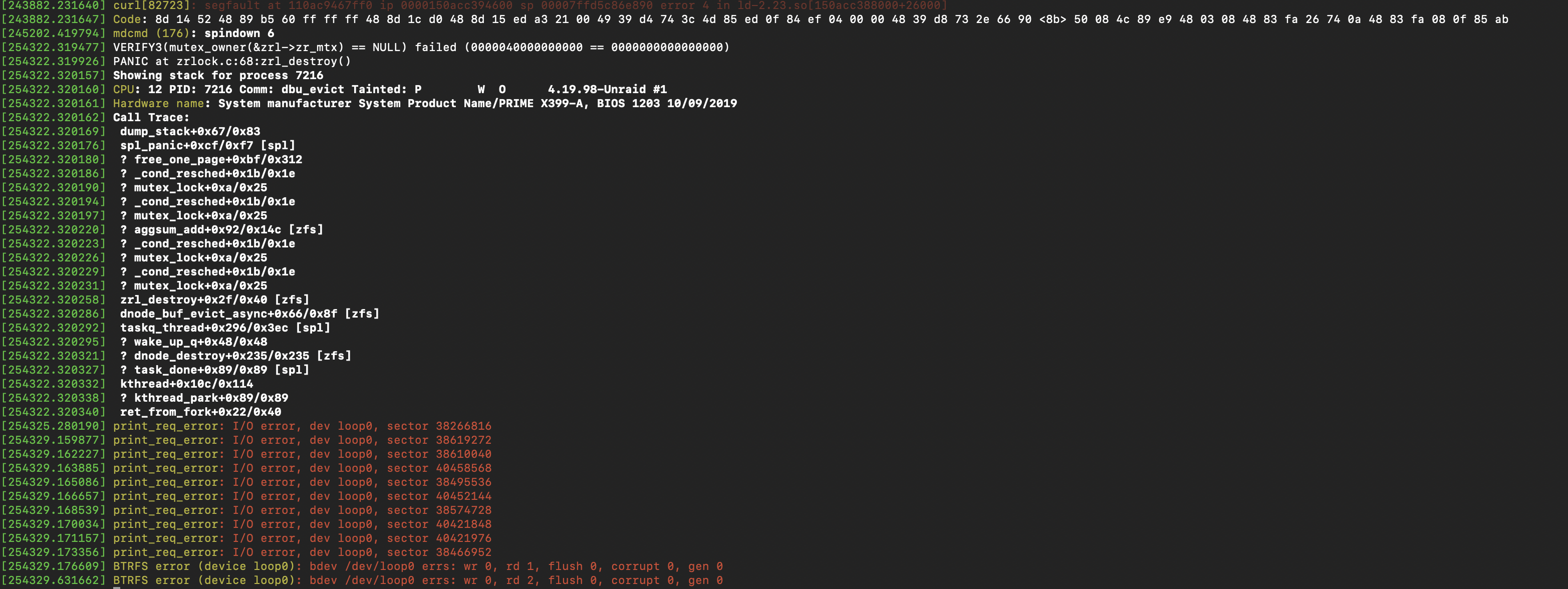

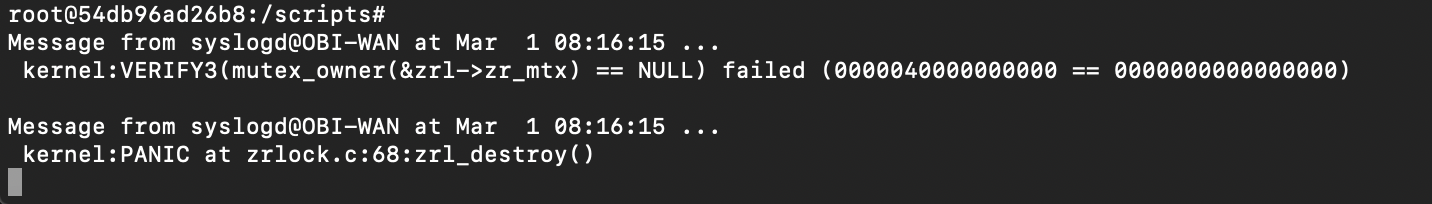

While sitting with an open console, I just had this:
1039115469_Screenshot2020-03-01at8_16_34AM.thumb.png.54a5dad554d9c9134e49718b57da4ba9.png
I understand the first one is ZFS related, I assume therefore the second is also.  Leaving a copy here for a record as I've been having a few issues and there's a chance this is the cause.
Edit - dmesg below, now BTRFS involved?  Maybe I do have faulty hardware.  Similar dev loop errors I found a few days ago, I had to repair filesystems and even rebuild all the BTRFS ones from scratch as it seems most susceptible to corruption.  So I'm going to go with not specific to ZFS for now.
Edit 2: Memtest confirms I have faulty, or possibly misconfigured memory.  There goes my morning....
