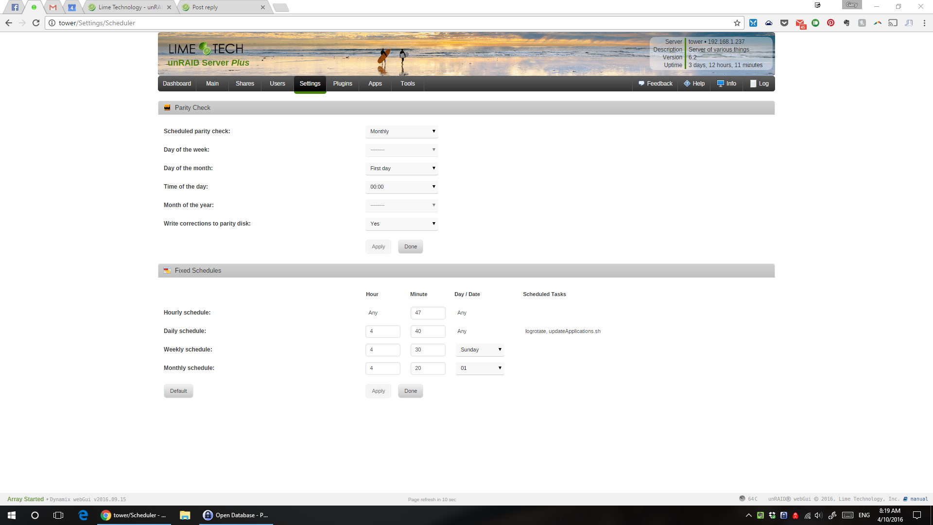

When you enable the parity schedule, do the settings "stick" after apply?
The settings stick on the Scheduler settings page, yes

Well, it's set to run which unfortunately puts this issue squarely in the hands of bonienl/limetech
I played around with the Scheduler settings page
I seem to have gotten it working now

I would guess that it's related to the way the Scheduler settings page refreshes when you select Scheduled parity check setting
i.e. when you select Monthly, the page refreshes to give the monthly settings, but you need to actually change the settings, for them to be updated.
Selecting Apply immediately after selecting Monthly, doesn't change the cron settings correctly.
Hope that makes sense?

I tested this but for me this is working correctly.
You can disable the scheduler which removes the cron file and setting, and after changing it to monthly it is added as expected when pressing Apply.
Are you running perhaps an adblocker, if so then whitelist the GUI.
