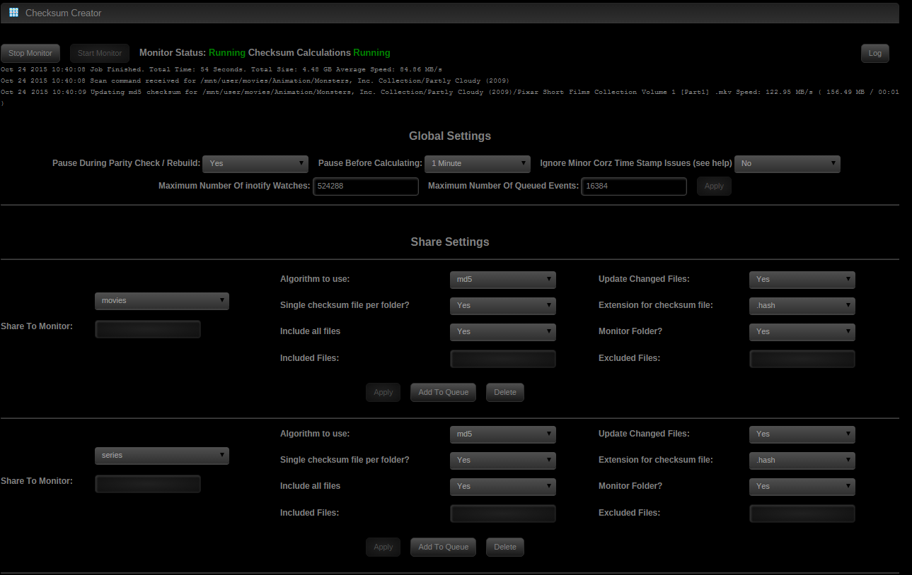

I've clicked the 'Sart Monitor' button three times over the last 20+ minutes.  Monitor Status is still 'Not Running'.  Nerd Tools is installed.  What else do I have to do to get the Monitor running?
Have you added any shares to monitor?  Does it say in the log setting up watches?  After hitting start monitor, does the button switch to being disabled (ie: you have to stop it then try and start it again)
The GUI as-is is also a tad counter intuitive since with each share section, you have to apply it separately for it to take effect (on my to-do list to set up an apply all button)
No, the instructions say that tou have to wait for the 'Watches Established' log message.
No, the Start button stays active, the Stop button stays greyed out.
Edit:
Ah, the message to wait relates to queueing jobs, not adding shares - sorry, my confusion.

Like I said, the GUI needs a little TLC.  After I finish up with the verifier, then that's going to get overhauled.

Simply put, you set a share to be monitored for changes.
If a change happens within a folder of that share, then the folder is hashed for items not already hashed.
Manually adding a share to the queue will hash every folder within that share.
This was originally designed for how I want it to handle my media collection.  Over the next month, things are going to become more general purpose and try and hit everyone's usage case (and a big part of that is scheduled hash creation, not relying upon a change queue).
At that point, I would think it should be bullet proof.  Changes to folders are picked up immediately, and in the off chance that something gets missed, then the scheduled scan will pick it up.  But, saving the queue (if anything is there) in the event of a shutdown is a good idea, and its something that I'll think about how to implement.  In the case of an outright power failure with no UPS to trigger a clean shutdown, there's probably not much I can do about it, because the queue is implemented as a linux pipe (to facilitate easy interprocess communication) and is not a file which is just "read" off the flash drive.  But, clean shutdowns can be handled because I can read all remaining queued items, save them, and then re-write them at the next startup.  Hopefully that made sense)
The basic routine for verifications is done and tested.  Next up is the GUI for it, for which it is also going to necessitate the frame work for scheduled cron jobs on verifications.
