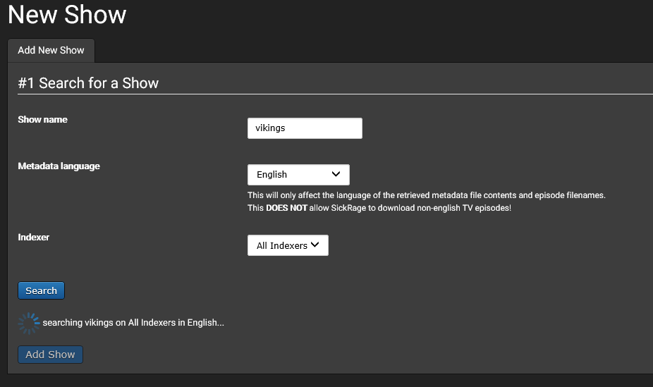

I was using Phaze Sickrage plugin, and I switched to the official docker after I started using the my unraid server again.  Upon installing the docker, everything seems to work fine, but when I try to add a show via "Add New Show" or "Add Existing Shows", when I hit Search, it never continues and just says "searching xx show on all indexers in English".  If I add show from IMDB popular list, that does work.  Please help, as I have a lot of existing shows I'd like to catch up on.  Please see attached screen shot.
