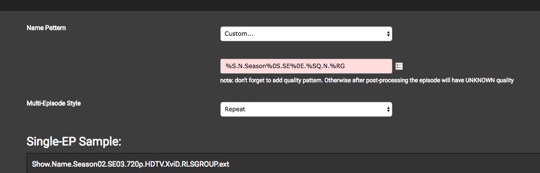

If I put it in there as you have it, its says its invalid and I can't save it.
Screenshot?
AH, I think my psychic powers just connected, You probably have one of the standard name patterns, choose custom and make one yourself.
Edit: I like using
 %SN Season %S/%RN
Edited by strike

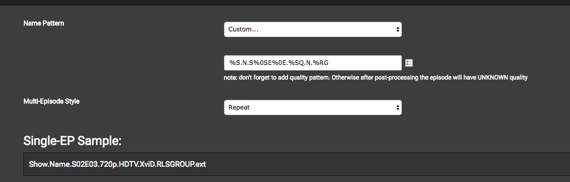

I am on custom. Here is what I have now and its not saving the episodes in their season folders.
Then I have what you are proposing, and as you can see its pink and I can't save it the way it is.

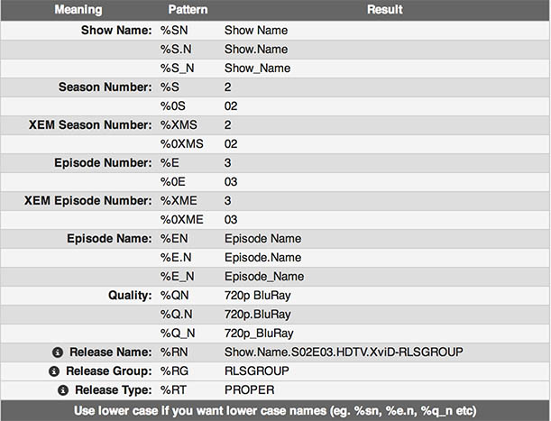

You didn't add what I said. I said add
Season %S/
Looks like you're missing "/" If you want Show.Name.Season02 as the season folder name you should add.
%S.N.Season%0S/
Then the rest you want after / And I would personally drop the 0 in %0S or else you will have Season 010 and so on for every season over 9.
I have switched over to using Medusa now, I will post in their support thread.
Thanks

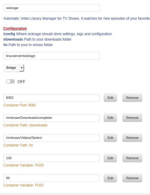

I changed it to 8083 - 8081 (standard) is already in use by CP.
Sorry, you had me at run command - I acces it with http://nas:8083/home - but that's probably not what you mean.

Where did you change it? I suspect you changed it in the wrong place, causing the issue.

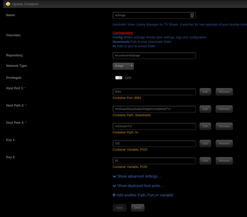

Can you post a screenshot of the docker config page showing the ports?
Edited by whauk
According to that screenshot, sickrage should be listening internally on 8081 and answering externally on 8083, so when the log for the app itself shows it's listening on 8083 that is wrong, and probably why you can't connect. It should show 0.0.0.0:8081
Oh shoot - I remember, within the Sickrage configuration there was another port mapping field that showed 8081 - which I (pretty much mindlessly) changed to 8083. Guess that's where I made the whole thing break.

29 minutes ago, whauk said:
unfortunately that clearly means to start from scratch as I can't access the inside of the container
Well, you could edit the port mapping in advanced mode and change the app port, or temporarily add a new port mapping pointing to 8083 for the app side.

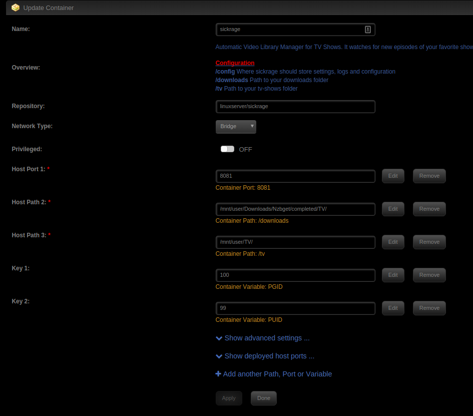

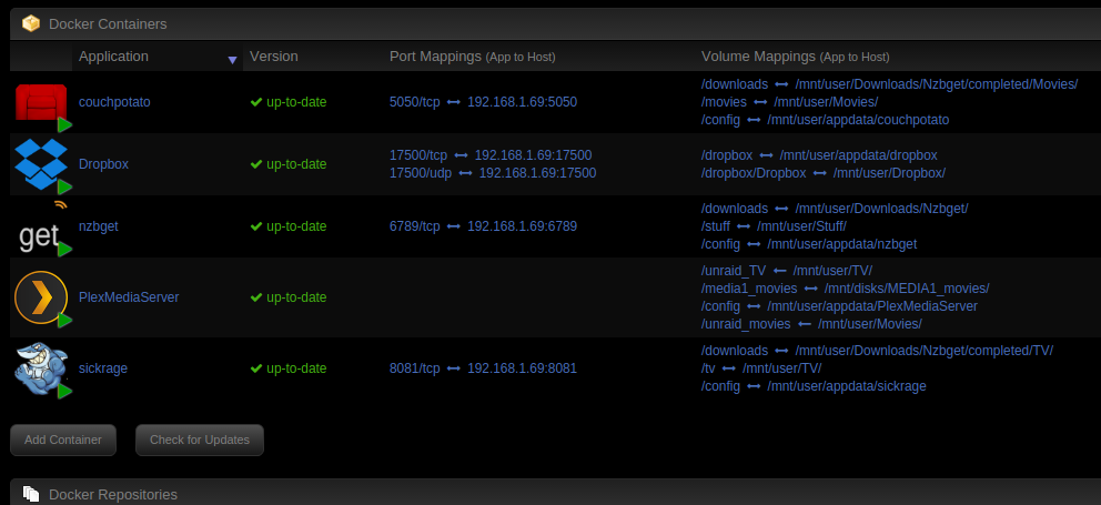

Hi i'm having issues...  I'm new to unraid, but i've successfully in the past few days got Nzbget, Couchpotato and plex running.  I'm slowly porting the services that i have installed on my PC to my Unraid server.
Now when I setup Sickrage (i also tried Sickbeard and i get the same issue...), I use the community app to set it up, and when i try to run the webui, it refuses to connect.
Ive attached a screenshot of my current containers and their settings, nothing else is mapped on the same port...  I<ve also attached a screenshot of the settings of the container itself.
And this is the command it runs  :
root@localhost:# /usr/local/emhttp/plugins/dynamix.docker.manager/scripts/docker run -d --name="sickrage" --net="bridge" -e TZ="America/Halifax" -e HOST_OS="unRAID" -e "PGID"="100" -e "PUID"="99" -p 8081:8081/tcp -v "/mnt/user/Downloads/Nzbget/completed/TV/":"/downloads":rw -v "/mnt/user/TV/":"/tv":rw -v "/mnt/user/appdata/sickrage":"/config":rw linuxserver/sickrage
fe51fe1dbae11d010448429af52d1c31f9e31be6892b00048e131e549c84ca1f
The command finished successfully!
Any idea ?  Thanks!
PS : this is what shows up in the container's logs :

DeepinScreenshot_select-area_20170721000306.thumb.png.52a6c8ba7be829a85b27d6c767e75c6e.pngDeepinScreenshot_select-area_20170721000112.png.1af1c0967065af1fca9b92db4fac644d.png
