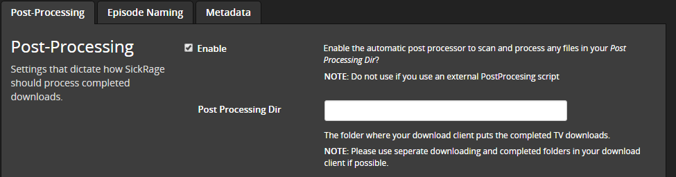

I'm having some trouble setting up post processing, I believe related to mapping the downloads folder. I apologize all the questions recently, but this week is my first time using docker instead of running these as standalone applications.
Sickrage searches my provider, grabs an nzb, tells sab to download it, sab puts it in the complete directory, and then sickrage just kind of sits there scratching its head going "Well I snatched it, what more do you want?"
I got this error in the log:
2015-10-31 12:33:02 POSTPROCESSER :: Automatic post-processing attempted but dir  doesn't exist
This is how I have it mapped in the Unraid docker menu:
sabnzbd
/downloads --> /mnt/user/Filedrop/nzb/complete
sickrage
Attached is what my post-processing screen looks like on the web interface for sickrage.
What am I missing here?
OK, final question (for now!). When I had this all set up on an earlier machine, I had a SABtosickbeard.py script. Is that script no longer necessary?
Nevermind, I got it. Problem was I was entering "downloads", not "/downloads" so it would just make a folder named downloads under the sickrage config folder instead of using the one named by the docker setup.
