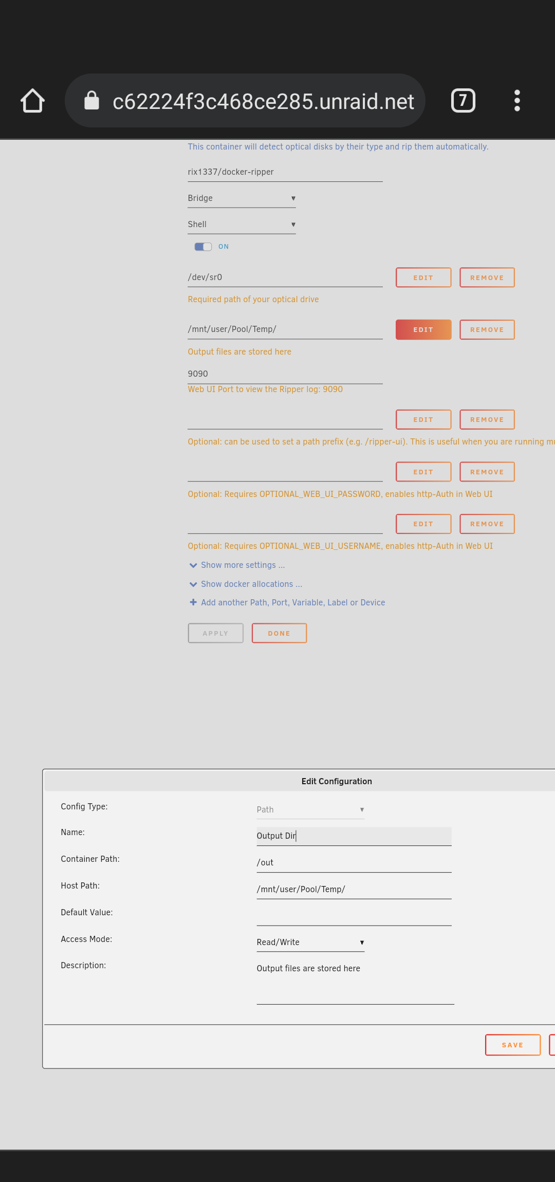

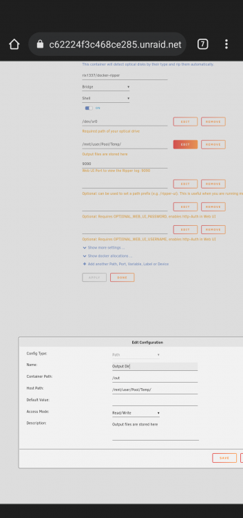

Ouch gotcha. Have you tried removing the docker and adding it back after erasing it's app data?
  • Replies 435
  • Views 111.7k
  • Any apostrophes or the like in the username / password?
  • Thank you for your response! It looks like that was a hardware failure on my end that appears any time I try to rip one particular CD. Thank you though! I'll look into ways to modify the .sh file to
  • This just needs to calm down here @stayupthetree, @rix before it gets out of control.   The "tag" of Community Developer is not handed out like candy here, and after the initial round of giv
1 minute ago, rctneil said:
Where do I check for this?
Also check your uppercase lowercase letters for accuracy on your folder names.
Ok,  allocation mode confirmed to be read/write.   Let me test delete and reinstall
Hey @wildfire305 IT'S WORKING!!!!
I think the deletion of appdata did the trick!
Many thanks for your super rapid replies!

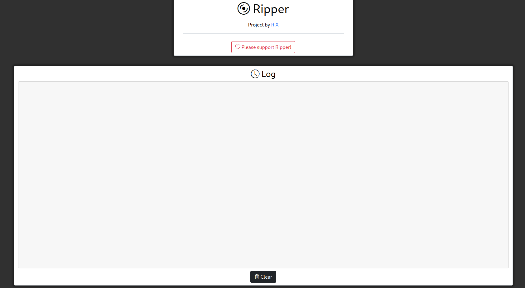

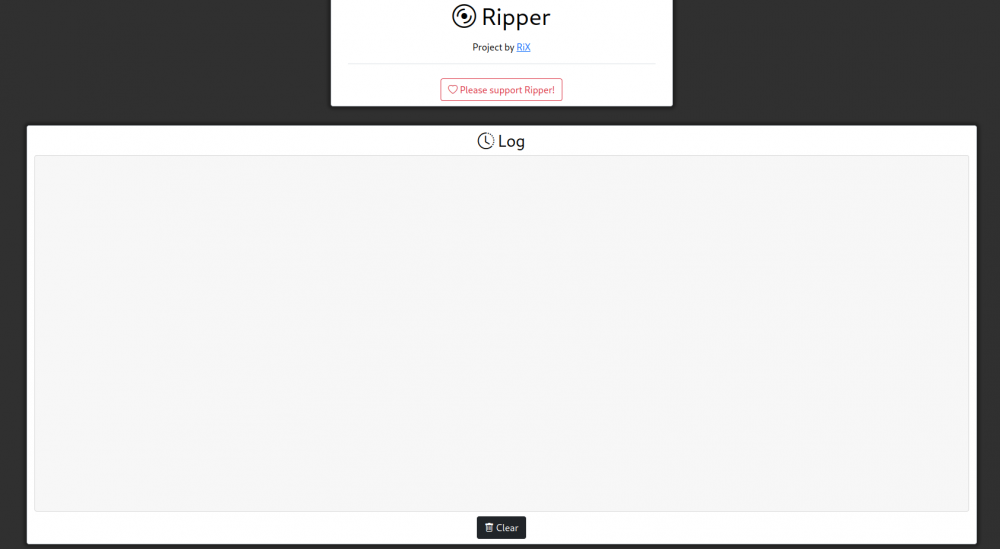

Hi and thx for that quick update.
I got good and bad news.
The good news: The webui is working. and my Slipknot CD and others are now being tagged correctly.
The bad news:  In the Webui the log window is empty and causes performance issue. Tested on chromium and firefox in private mode.
On chrome it crashes after a short while and on firefox nothing happens.
There is no error or warning in the logs. The log under /config/Ripper.log is running. So I guess thats some html related problems.
Post your Ripper.log here and screenshots from your browsers console
You might be the first to actually use this ;)
I hope I understand it right with the screenshot:
Unfortunately the log is with +140mb too big. Cant upload it.Ripper.log
Maybe the size could be the problem for the webserver.
Edited by W0nderW0lf
That size is definitely the reason for the failure.
In that case, maybe a "rolling" log would be a good idea to implement
That log size is insane, creating a unified log with rolling support is not trivial in bash. Ill gladly accept a pull request for that.
I still managed to fix this: using Stack Overflow codeTM the web ui now loads (up to) the last 100 lines from the logfile.
If the log is larger than 1 MegaByte a warning to consider clearing the log is shown as well.
This worked with a file of 400 MB size in my testing, so no more error should show in your case.
Enjoy and show some love for this project, if you can 😉

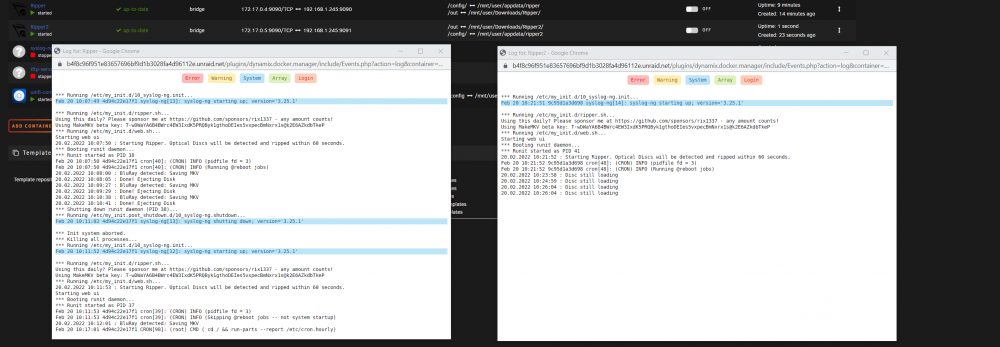

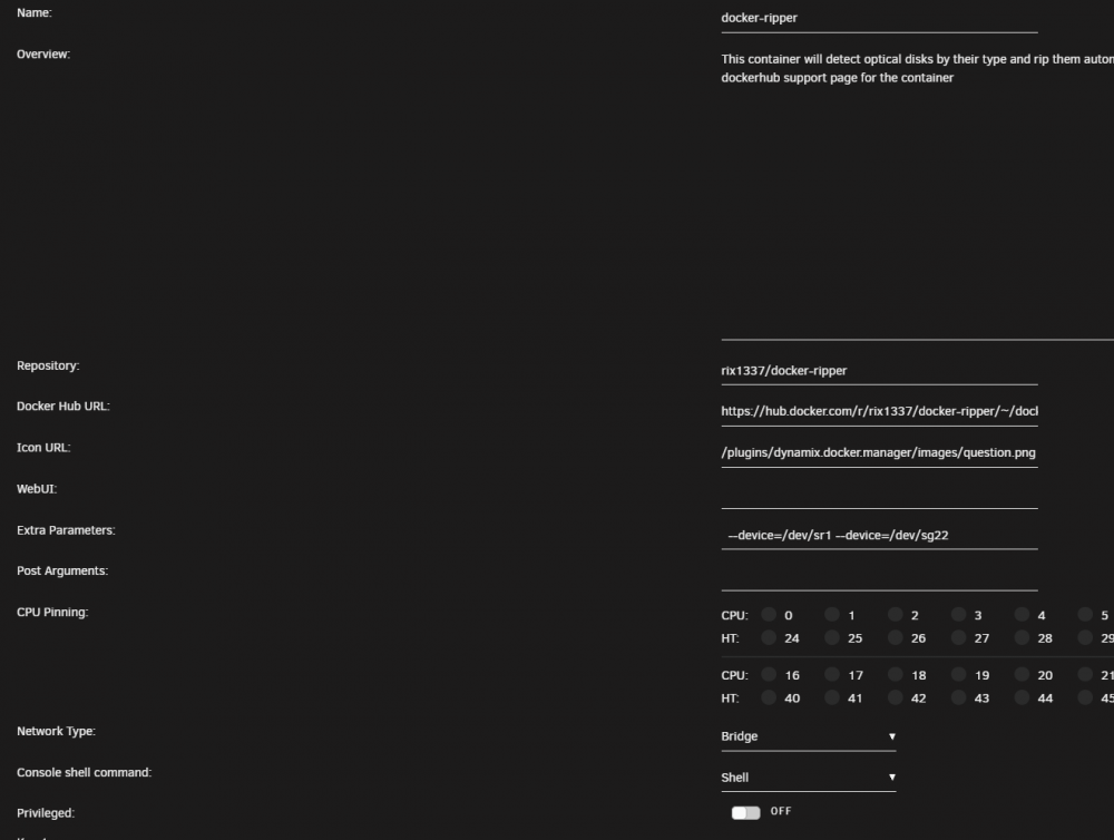

Hey guys. I've been having an issue and I'm not really sure if I'm just misunderstanding. I have two separate dvd drives that I'd like to use for ripping, so I've made two containers. Unfortunately, despite the fact that I've changed the parameters in the image config, both images want to rip from the same drive.
In my case, my drives are /dev/sr0 /dev/sg8 and /dev/sr1 /dev/sg9.
I've tried mapping both containers to the full paths I've shown above as well as formatting it the way it's formatted by default.
I've also tried switching it within the .sh file. I'm not sure if that's supposed to work because that's within the container but I still tried it.
Am I missing something?
Thanks!
Thanks!
The Github readme clearly states you need to run one container per optical drive.
Yes, I understand. I was saying that I made a second container, routed it to the second optical drive, and yet for some odd reason both containers try to read from the first optical drive.
