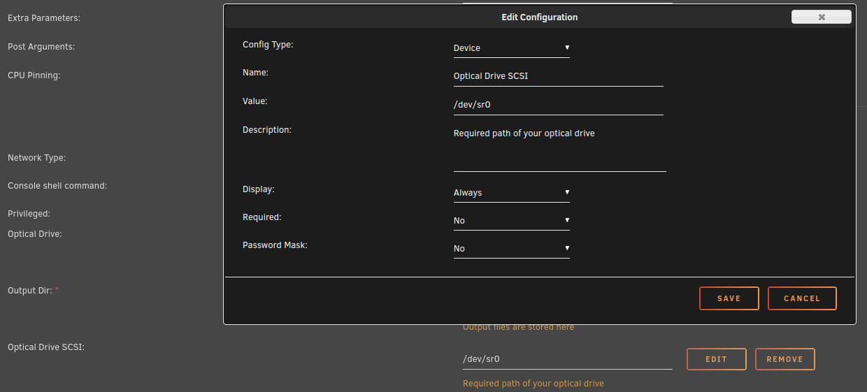

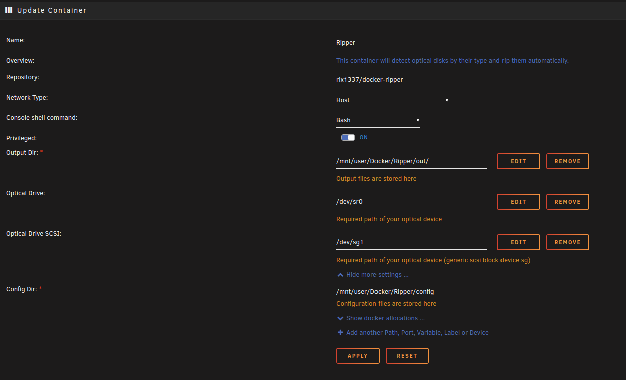

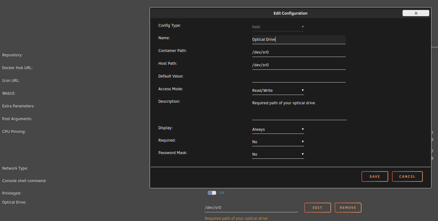

On 1/12/2021 at 4:27 PM, Darksurf said:
The ccextractor thing is still an issue as the location settings do not match. ccextractor wasn't installed in /usr/bin/ccextractor. Its been installed in /usr/local/bin/ccextractor .  So the errors still exist. I've not added that settings.conf.
Then you should add the line pointing it to /usr/local/bin/ccextractor. I have also updated the Readme to reflect this.
 What is should be doing is passing /dev/sr0 as a DEVICE. would it be possible to tweak the docker to do that?
I have since fixed the template. sr0 should now be passed through as a device by default.
Thanks for the heads up.

52 minutes ago, MakerDuck said:
Hello everyone,
I can't get the newest build with makemkv 1.16.4 somehow, maybe its just a rookie mistake but I cant think of a different way to get it.
I downloaded Ripper with the CA Template and which worked, it flawlessly detected my optical drive and the "test"-DVD, created the folder in the output DIR but never ripped anything while the log said:
Then i checked the log in appdata/ripper and found this:
So I deleted the docker and changed the repository to "rix1337/docker-ripper:latest" and then "rix1337/docker-ripper:1.16.4" but in either way ended up with the same results and the log saying that makemkv 1.16.3 is installed and an update is required.
Maybe someone can guide me in the right way because at the moment I am clueless what to do. Thanks in advance!
This has been answered https://github.com/rix1337/docker-ripper/issues/75
