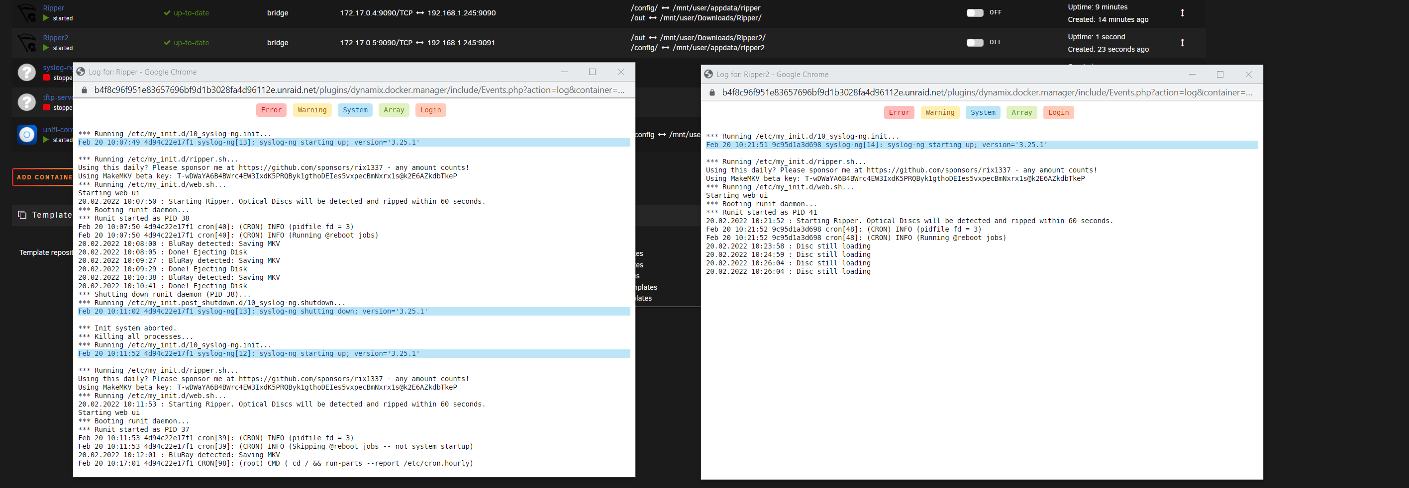

How do I rip from multiple drives simultaneously?
Simple: run multiple containers of this image, passing through each separate drive accordingly.
Clearly false, or multiple people here wouldn't be asking for help on the issue. Going through your issues on github, you couldn't even be arsed to have abcde.conf easily accessible for people to edit. Majority of it is "I'd be happy to review a pull request". Why would anyone sponsor someone who wants other people to do the work they wont/cant do?
Just be honest, you either 1) don't want to help or 2) can't help because you likely didn't make 90% of this
Good luck getting sponsors for a passion project with that attitude. ;)
People have constantly showed you that "2 containers" the 2 containers aren't working
In one issue we are supposed to go through ripper.sh and change a bunch of code to get it to work. Struggle with setting variables? Don't know how to do it. Bruh it's in the readme, how are you so dumb user?!
2 minutes ago, rix said:
I don't want to support you specifically.
All one needs to do is look at your github issues and see you don't want to help people. This SPECIFIC issue is 2 years old. People tell you it isn't working. And you just go "Its in the readme".
You do not seem to grasp the concept of "no support".
Does. Not. Work. Something. Is. Flawed.
If I make ONE container, and only passthrough ONE device. Why does the container still see both drives?

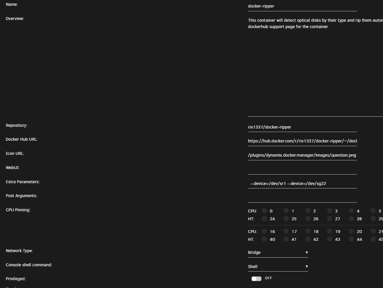

2 minutes ago, stayupthetree said:
Perhaps someone here can explain how with zero devices passed through to the container, the container still shows both drives?
That's where I got to with it. I couldn't understand how it was seeing sr0 as sr0 still when I intentionally tried to map it to a different sr(x) for testing purposes. This docker works excellent with one drive. My server has one built-in (laptop style) dvd burner. I have a usb bluray burner. In order to rip blurays I have to use the makemkv docker or a vm or my w10 laptop. I could never get ripper to ignore sr0 and go for the external. Mapping sr5 (external burner) to sr0 caused it to try to read from both drives simultaneously. I've been dabbling with Linux since 1999 Redhat 5.2, but only really got stuck in firm last year so I'm just chalking it up to my own inexperience. I can follow complex directions, but I need more directions.
6 hours ago, wildfire305 said:
@rixAre you in the USA? I have a spare internal sata or external usb optical drive (choose one) I'd donate and ship to you. DM me if interested.
Nope. You'll need to ship to central europe
The reason the container can see both drives is if the docker is running in priviledged mode it has complete access to all devices, so will ignore the device statements. I dont know any other effects of turning off privileged mode with the docker. @rix DM me if you want me to to any testing for you.

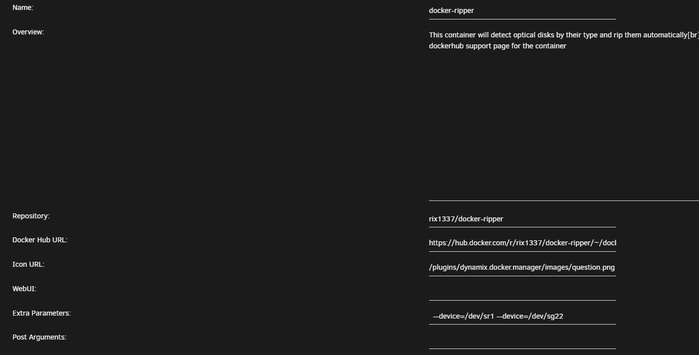

That makes sense. It's one of the reasons why the privileged flag is not part of the default config in the Readme.
Some users were unable to use ripper without the flag though so it's usefulness may differ between various use cases.
So what you are saying is it works for you if you don't run the container as privileged?
I have only tested the commands in my post to show it only finds the one dev with priv turned off. I have not ripped any discs as I have not completed the setup so cannot confirm at this point if it works correctly with priv turned off.
I will look at the setup and see if I can test further
Edited by SimonF
It is ripping a Blue Ray in non priv mode. Created two containers, second one found disk, but issue is my drive does funny things if not used for a while and needs to be reset hence the disk still loading and not able to reboot my server to fix, but looks like it should work as expected. Will test CD on the one ripping to confirm also.
