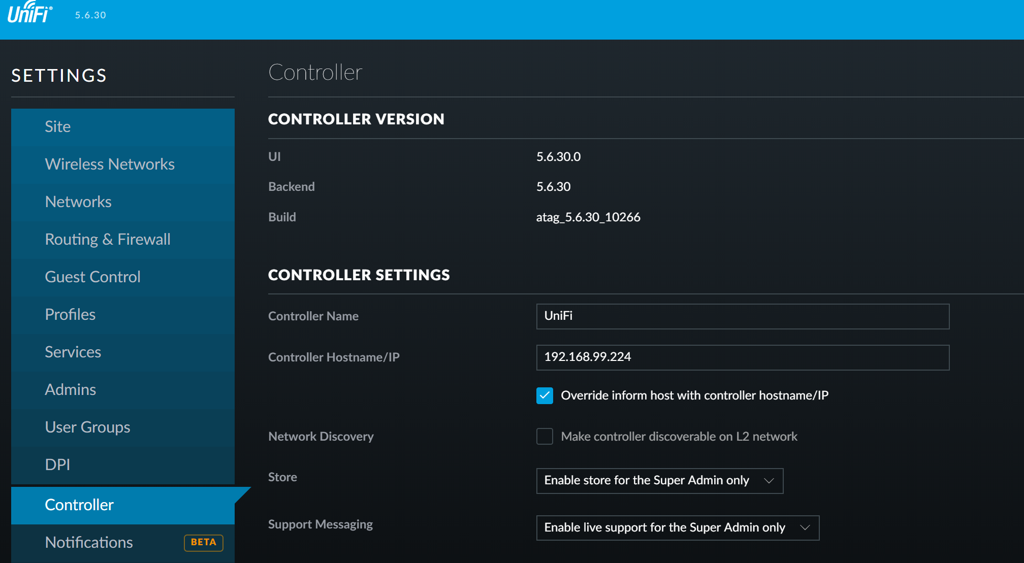

I know this might not be the specific issue you guys are discussing, but maybe it will be helpful for someone since you mention the override.
My Provisioning/Adopting/Disconnected Loop was fixed with the override in controller settings within UniFi 5.6.30 (older version than 5.7 you guys are discussing). Since checking the Override inform host with controller hostname/IP to my unRAID server IP I have not had any more loops.

4 hours ago, jedimstr said:
I've had this with all my AP's, two Switches and USGPro on the current 5.6.30 release, and the previous release update.  I didn't fix it by downgrading though.  I SSH'd to the individual devices and had to force the set-inform to my controller's specific URL (ssh to the device and type "help" for instructions on how to do manually set-inform).  This is actually a common problem with containerized versions of the controller software if you have it bridged because the internal IP of the controller is different than what the devices will see.
The longterm fix to this was provided by Ubiquiti in 5.6.30 under the Controller settings, but for some stupid reason isn't enabled by default.
Check the checkbox in this screengrab in your controller settings and set the domain name or external host IP for your unraid server if you don't have one dedicated to the docker container.  This is most definitely not a 5.7.20 issue, you just happened to encounter it with the 5.7.20 release.
How do you set a custom inform host port? That field won't accept X.X.X.X:XXXX syntax, it only will take the IP part. When I manually set-inform on the device, I have to enter the IP:PORT for it to work.
If you need a non-standard port for set-inform, you'll have to do it per device by SSH'ing in. If the IP set matches what the override at the controller level has, it shouldn't replace what is set on the device even if you use different ports.
