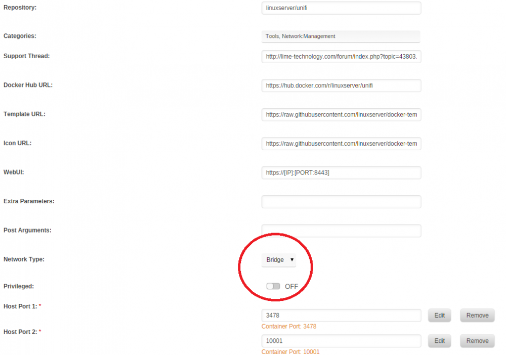

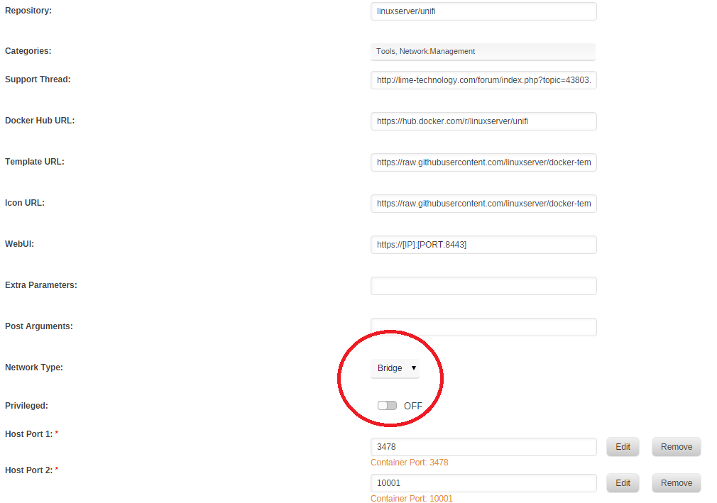

Bridge mode can not be used with Unifi because it uses network address translation (NAT) which interferes with the communication between app and clients.
Edited by bonienl
That's weird because that's exactly how mine is now, and working.  Plus it had to have been the default, because I blew away any and all traces of unifi and then re-added from the community applications list and reconfigured from scratch.
Mine too. Just installed a couple of weeks ago. Never used the docker prior to this installation. Seems to be working ok.
Dunno, maybe something has changed (for the better). As far as I can recall I had issues with bridge mode, but it has been quite some time ago when I installed Unifi.
Same here.  The UniFi docker has been running in Bridge mode since day one (other than when I tried assign it an IP Address and got the call traces).
I also installed the 6.5.1 RC2 on the server last night.  Pi-Hole currently has its own IP address and was generating lots of call traces on 6.5.0. So far, the syslog is free of call traces.
