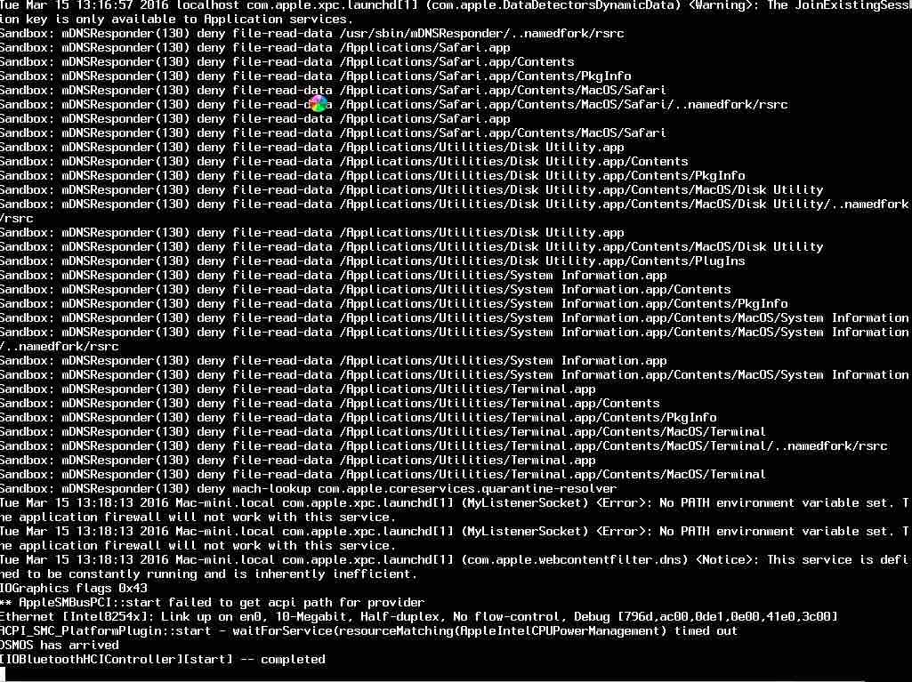

ElCapitan refuses to boot, Yosemite boots but unable to give the video output, neither via vmvga or cirrus. Stuck with spinning beach ball on verbose background.
Tried 10.11.1 / 10.10.5.

Yup. The best result is a verbose (if use -v flag) or gray background with half progress bar and spinning beach ball / cursor at the top.
The last message is "[iOBLuetoothHCIController][start] -- completed."
Using video "vmvga". Or I'm getting message that "Window manager exited with signal trap..." if set to "cirrus".
I never got to GUI.
Switched between qemu 2.4.1 / 2.5, q35-2.2 / 2.3 / 2.4 / 2.5, core2dou / Westmere / SandyBridge / etc (actually tried all available), enoch / chimera bootloader. With or without boot flags - makes no difference, same end.
There is always 2 results: 1) Immediate reset, or 2) Stuck with beach ball.
Using XML exactly as in guide, except network conf section and own paths to iso and virtual partition.

But it didn't resolve reboots (El Capitan) or beach ball (Yosemite) (see attachment).
