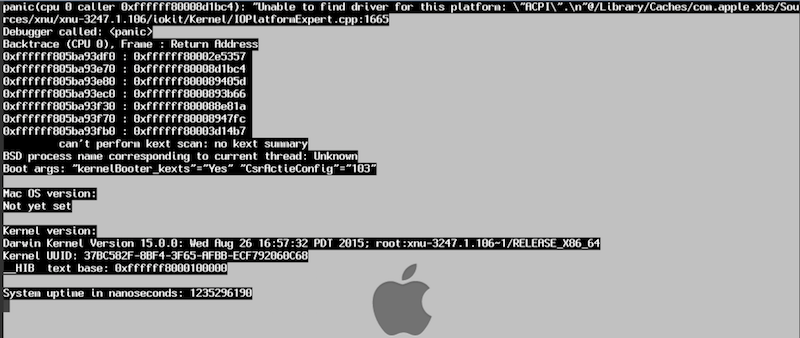

So, finally got the Apple logo but the i get this - see picture, what going on?  :-\
publicpreview.php?x=2022&y=1136&a=true&file=Sk%25C3%25A6rmbillede%25202016-03-06%2520kl.%252019.32.56.png&t=wDzGNI9wsc6XKlJ&scalingup=0
58aad7d9db8f3_Skrmbillede_2016-03-06_kl._19_33_22.png.cd53482bb5c6bd53e79b9cfc5e76699c.png
So i got it working, installing OS so far :)
Care to tell us what the problem was and how you fixed it? What is your hardware in your UnRaid vm, what are you passing through for video ?
Sure.
Did the guide, but when i tried starting the VM it came up with an error, did some googling and it seemed like an memory problem, so edited the VM to 2GB ram (i'm having 4GB total currently, 64GB on the way though), and the starteded the VM and the along came another error.
So got in the XML part at saw that the:
<type arch='x86_64' machine='pc-q35-2.3'>hvm</type>
<kernel>/mnt/user/VM/vm_images/enoch_rev2795_boot</kernel>
<boot dev='hd'/>
<bootmenu enable='yes'/>
Was missing, it was there before, so inserted it again, and then that screen appeared. So hours later i came back to my computer and thought of just editing the:
<memory unit='KiB'>xxxxxxx</memory>
<currentMemory unit='KiB'>xxxxxxx</currentMemory>
to 2GB and then it worked.
