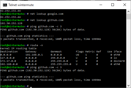

From console or telnet, what do you get with this?
ping github.com -c 3
Thanks, and your answer is:
3 packets transmitted, 0 recieved, 100% packet loss, time 1999s
:o
Well that's a good start to pin pointing the issue, how on earth can the server not hit it but I can open a browser to it?
I'm actually stumped, while I consider myself a tech head most of the time I can't think where to even start on this one!

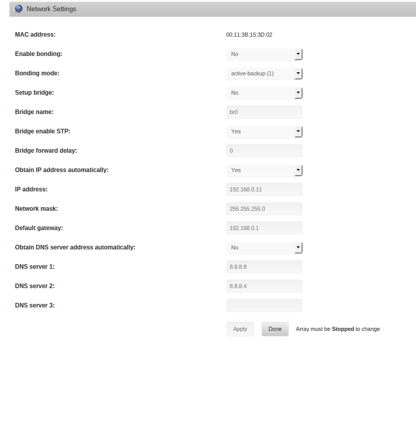

Try manually setting a DNS address in Settings / Network.  Try 8.8.8.8 and 8.8.4.4

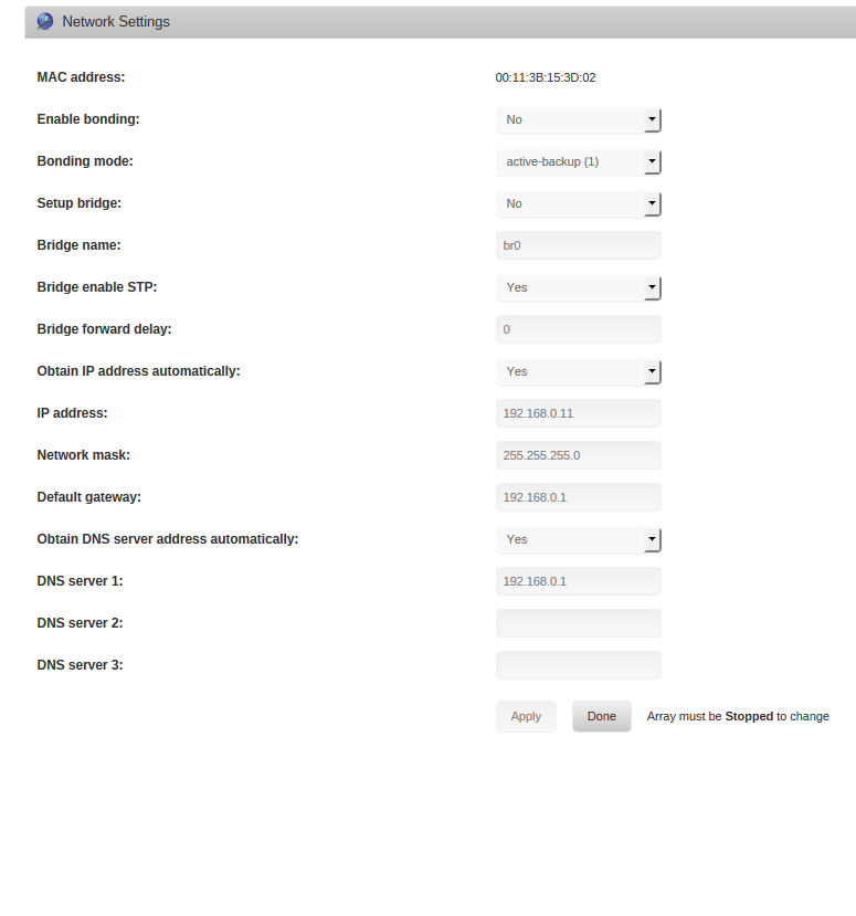

Hmm it was set as 192.168.0.1  :P And auto detect.
Just tried to ping again and got:
ping: unkown host github.com
Which is now more confusing
Screenshot of my settings/network.
I've probably not changed them since I first set up the server. Half wondering if I re-install Unraid 6 and wipe most of the original stuff if that would help.

Try deleting network.cfg from your flash drive (config) and reboot
Deleted and ping...same error message as above.
Docker still not giving any drop downs (assume it times out too)
It's gone back to the atached settings.

Also tried the above DNS change to my ISPs DNS server. Couldn't connect to github again. i.e. unknown host
netlookup for github brings me back 192.30.252.128 so it's picking it up!
Ping fails though!
