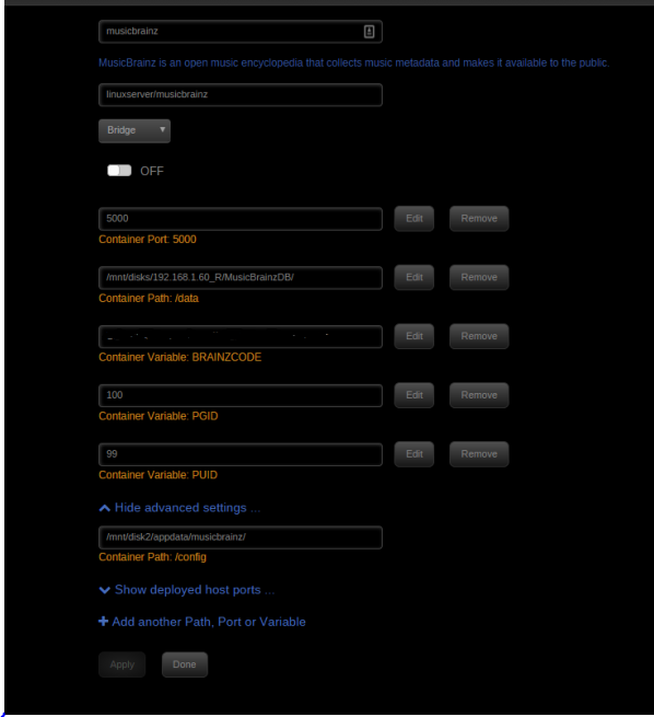

I'm having issues trying to install this fresh.
I set /data to a RW/Slave share I have on a separate file server.
appdata is mounted to /mnt/usr/appdata/musicbrainz

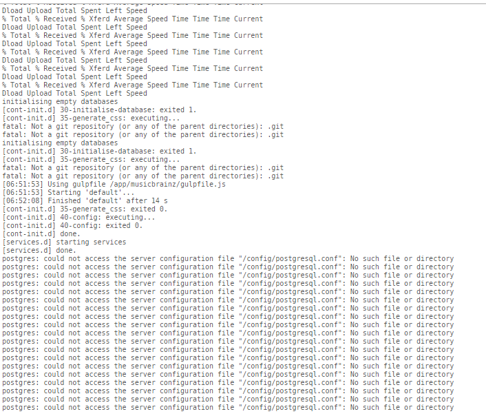

The log is endlessly spammed with below
postgres: could not access the server configuration file "/config/postgresql.conf": No such file or directory
I've tried re-installing a few times now.
Is there something I'm missing?
Thanks in advance for any help :)

Try using /mnt/cache instead of /mnt/user. If you don't have a cache drive you can use /mnt/diskX. X is the disk number you want to use.

Here's a fresh log from an install until the error:
ErrorWarningSystemArrayLogin
[fix-attrs.d] done.
[cont-init.d] 10-adduser: executing...
_ _ _
| |___| (_) ___
| / __| | |/ _ \
| \__ \ | | (_) |
|_|___/ |_|\___/
|_|
Brought to you by linuxserver.io
We gratefully accept donations at:
https://www.linuxserver.io/donations/
GID/UID
User uid: 99
User gid: 100
[cont-init.d] 10-adduser: exited 0.
[cont-init.d] 20-brainzcode: executing...
[cont-init.d] 20-brainzcode: exited 0.
[cont-init.d] 30-initialise-database: executing...
[cont-init.d] 30-initialise-database: exited 56.
[cont-init.d] 35-generate_css: executing...
fatal: Not a git repository (or any of the parent directories): .git
[15:11:25] Using gulpfile /app/musicbrainz/gulpfile.js
[15:11:25] Starting 'default'...
[15:11:48] Finished 'default' after 22 s
[cont-init.d] 35-generate_css: exited 0.
[cont-init.d] 40-config: executing...
[cont-init.d] 40-config: exited 0.
[cont-init.d] done.
[services.d] done.

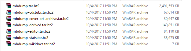

Is the config file there if you check it manually?
The config file is NOT there.
However, my data directory DOES have files. see below
dbase is empty
redis is empty
import has a folder in it with these below it
all my three folders are empty - dbase, import and redis

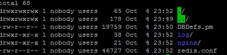

2 hours ago, saarg said:
Can you try using a local share for the /data volume and not a remote one?
Looks like it's working now with a local share.
Any idea why I can't use a remote one?
The share is completely open to everyone read/write/execute on windows server 2012.
It was also set to RW/Slave
Edited by Quiks
Definitively a permission issue. Not sure how to fix it though.
