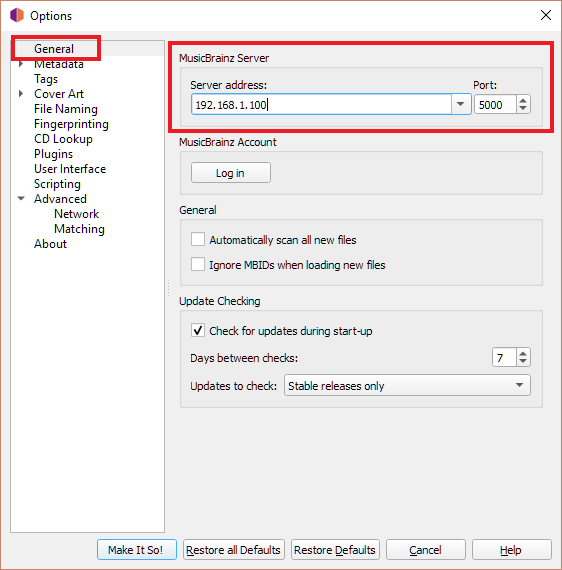

Hello!  I installed the Musicbrainz server locally on my unraid server.  The databases have updated, and I see that they are updating regularly.  My problem now is that Picard continues to ask for an authorization code to access the server.  I've authorized Picard to work on the Musicbrainz website, and added the auth code.  However, it still won't work with my local server.
The error codes are as follows:
E: 12:16:15,369 webservice._handle_reply:383: Network request error for http://10.0.30.200:5000/oauth2/token: Error transferring http://10.0.30.200:5000/oauth2/token - server replied: Bad Request (QT code 302, HTTP code 400)
E: 12:16:15,371 oauth.on_refresh_access_token_finished:125: OAuth: access_token refresh failed: b'{"error_description":"Invalid protocol, only HTTPS is allowed","error":"invalid_request"}'
E: 12:16:23,738 webservice._handle_reply:383: Network request error for http://10.0.30.200:5000/ws/2/collection: Host requires authentication (QT code 204, HTTP code 401)
E: 12:16:23,739 ui.mainwindow.set_statusbar_message:326: Error loading collections: Host requires authentication
I'm currently using Picard 2.1.3.
Is this a problem with Picard or my server install? If I'm reading the error messages correctly, it seems like it wants my musicbrainz server to be an https:// connection.
Any ideas?
OK I think I replicated your problem, you don't need to login with a musicbrainz account.
Just add the server address and port of you musicbrainz docker and "make it so" (apply) and it'll start using your musicbrainz docker, nothing else is required to get it going.
Yep, that got it!  Now, I've just got to get the file permissions squared away.  Now, I can't save the changes that Picard wants to make.  I'll figure it out eventually.
