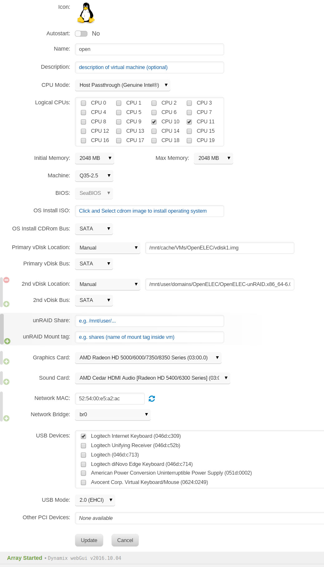

I'd like to run OpenElec or LibreElec as a VM in Unraid 6.2.1. I managed to get a Win10 install running after following the helpful YouTube video by Jon Panozzo and thought this would be fairly simple too.
I must be as dumb as a rock but this guide doesn't seem too resemble what I am seeing in the VM tab. Do I use one of the templates and if not how do I create a custom VM for this?
Sorry to be a PITA, I guess the guide assumes a modicum of intelligence.  :-[
Thanks.
Adam
The guide was written up when the VM Manager App had a different "custom" page for creating VM's. I'd suggest trying starting with the Linux template.
Thank you that helps.

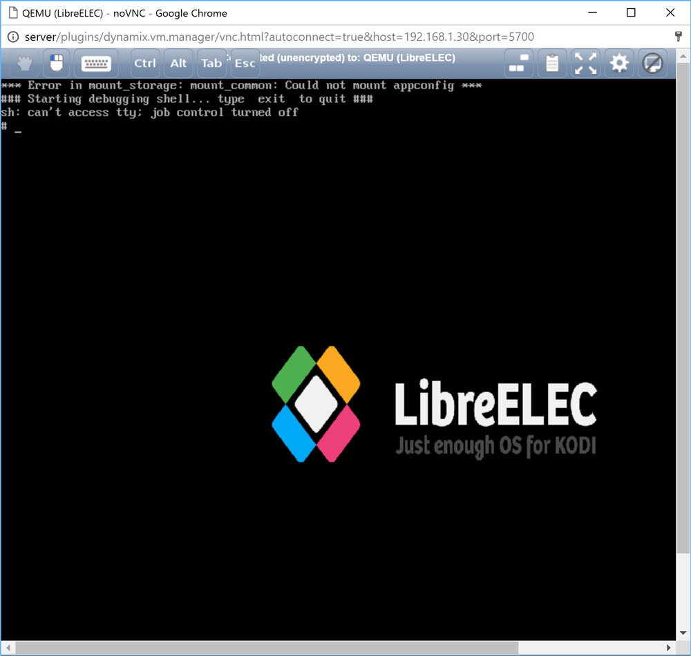

I get the feeling I am closer now. My XML looks a lot more like that in the OP. However when I run the VM I get the image load  up and then some error messages appear at the top of the screen. Some of it is cut off but the rest reads:
Error in mount_storage: mount_common: could not mount appconfig
Starting debugging shell... type exit to quit
can't access tty: job control turned off
Any advice would be very welcome :)
Thanks,
Adam
server-diagnostics-20161019-2150.zip
post the unraid vm config page and your XML.
Ok.
I get the feeling I am maybe missing a step, like creating an image or a share or something?

Your 2nd vdisk should be the os install disc
Ok, can you spell that out to me in baby steps please? :) Obviously I am not sure what I am doing.
Thanks.
Is this what you mean? Still same problem?
After it errors on the loading screen, I force quite and go to edit the XML and it shows the <address lines back in again even though I deleted them and updated prior to running the VM. Not sure if this is just happening because if fails or it isn't saving the update...
Anyway the error is:
Can't access tty: job control turned off
Thanks.

      <address type='pci' domain='0x0000' bus='0x02' slot='0x05' function='0x0'/>
    </memballoon>
  </devices>
</domain>
Anyone have any hints? :)
Thanks.
Adam
OK, this is all new to me since I haven't installed an OpenELEC / Libre VM in 6.2+ yet. Have you tried the built in template for OE?
Yes I tried that an LibreELEC as well. Both give me that error.
I keep wondering if I have something more fundamental wrong, although the Win10 VM works a treat.
This is as far as i get.
Me too.
