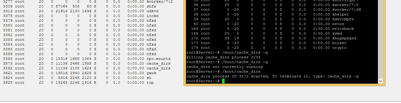

Is it normal for cache_dirs to show up as 2 PID's in the "top" listing? (see pic)
When I start it from telnet, I see 2 of them show up.
If I kill the one I started with "-q" it still has another 1 running.
I can run the -q option again and it states no cache_dirs is running.
If I stop the array the other one that was running is then cleared and no longer shows up.
Once I restart the array it is also still not running.
However once I start it in telnet 2 of them show up with different PID's.
I am using v1.6.8 Unraid 6.0b6
I'm confused...
You do not "start" cache_dirs with the "-q" option.  That is how you "stop" a cache_dirs process that is already running.
( the -q option has it look for a file the running process had created containing its process ID, the "-q" process then kills that original process via the ID it found.)
Cache_dirs in many cases DOES create one child process per mounted disk share.  (unless you supply an argument to cache_dirs to NOT perform that function)
These child processes are to purposely cause the mounted devices to be detected as "busy" when you attempt to stop the array.
It then allows cache-dirs to detect those "busy" file-system messages and suspend itself when you are attempting to stop the array so the array can be stopped cleanly.
The major issue people have had in the 64 bit world is the ulimit is set too low for many of them to fit their directory structure in memory.
You can fix that issue by simply commenting out the lines in the script that set "ulimit". (or deleting them entirely)
One person reported the newer version of the shell no longer sets $SHELL as /bin/sh when invoked as /bin/bash
I'm confused...
so therefore, cache_dirs could not be started from the "go" script.  To fix that, delete the lines at the top of the script as shown in "red" here:

I was not starting it with "-q" I was just saying that is how I was stopping it, but still seeing another running.
I was starting it just by running "cache_dirs".
Thanks for the input, and the fix for using it with the Go script.
I will add that in to my setup soon.
Glad you cleared up my confusion.  I've attached a new updated version  in the first post in this thread.  Hopefully it will work for you.
