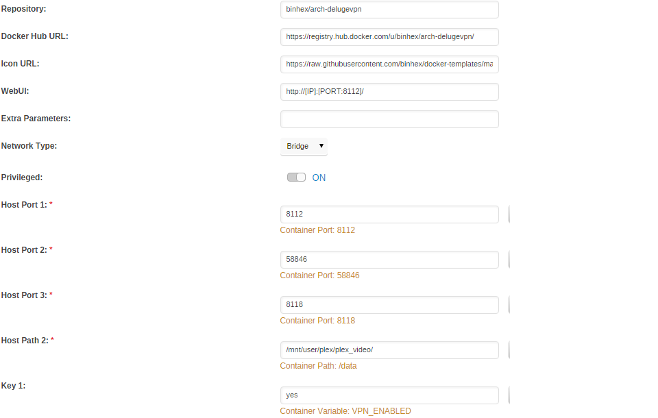

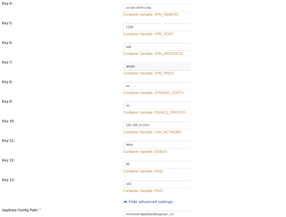

Please post a screen shot of the docker config.
See pics..  I left out my user & password, obviously..
Thanks...
First is see your appdata is "v2", is "v1" shutdown so ports don't interfere?
Second, please post the log from the container
There is no v1 present.

I dont think its a browser issue because I cant even telnet to port 8112
@binhex, there's been a lot of these 'cannot connect from LAN' posts lately.. I wonder if a change in unRAID caused this...
TO ALL USERS WHO CANNOT CONNECT FROM INTERNAL LAN, what version of unRAID are you running?
I finally got it to startup again but will only work when vpn is off.  Nothing I did should have had any affect though
I really hope your wrong but unfortunately there is no way I can test as I don't have a test rig to test out the latest rc
Sent from my SM-G900F using Tapatalk
