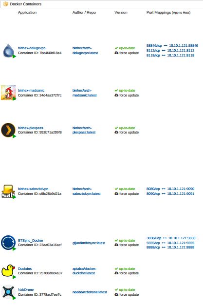

However, I'm having some trouble with a client app (Z-Subsonic) I just bought for an older iPod (6.1.6). It will not connect to the binhex Madsonic docker running on my unraid......but it WILL connect to gfjardim's Madsonic docker on the same server (obviously running independently).
The developer is silent on the issue. Probably abandoned it a while back. Last app store update was in 2012.
I'm hoping binhex might have some insight into this - why does it connect to one but not the other? The bin hex docker is better - since it comes with the transcoding pre-installed. The gfjardim docker does not.
Cheers
probably due to different versions of madsonic, im not running the beta version, possibly the app was built only to support the very latest bleeding edge version of subsonic/madsonic?
Could be. However Z-Subsonic is an old app.
Looking at the two docker apps:
binhex:
Version MADSONIC 5.1.5250.20150813.1155  MADSONIC REST API v1.12.0
License Madsonic Free Edition, for personal use only as described below.
Server jetty/8.y.z-SNAPSHOT, java 1.7.0_95, Linux (129.5 MB / 243.0 MB)
Size:        Database: 16MB, Thumbs-Cache: 0MB, LastFM-Cache: 0MB, Lucene-Cache: 1MB
                Spring.Framework v3.2.14, Spring.Security v3.2.8
                HyperSQL DataBase v2.3.2
gfjardim:
Version MADSONIC 5.2.5420.20141214.0251  MADSONIC REST API v1.12.0
Server jetty/8.y.z-SNAPSHOT, java 1.7.0_72, Linux 4.1.17-unRAID (amd64) (100.9 MB / 236.0 MB)
Size:        Database: 7MB, Thumbs-Cache: 0MB, LastFM-Cache: 0MB, Lucene-Cache: 1MB
                Spring.Framework v3.2.12, Spring.Security v3.2.5
                WARNING no transcoder found!
So gfjardim Madsonic version is newer, but other components (jetty / spring) are older......

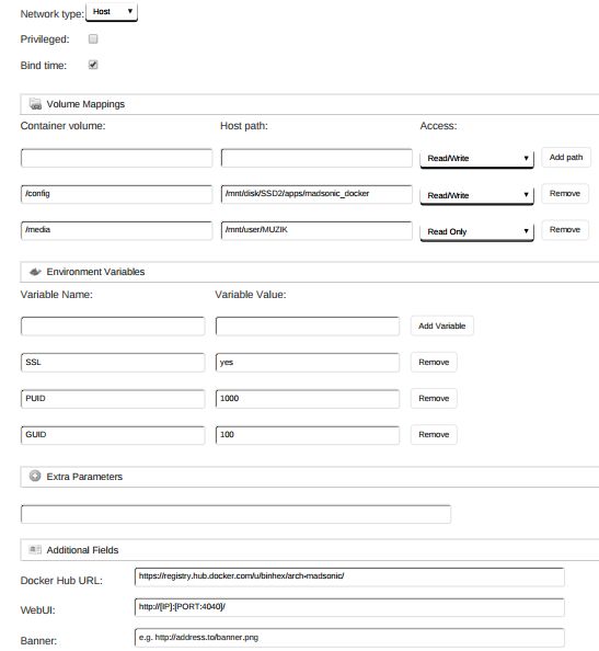

Just updated your madsonic docker and it no longer wants to start. Deleted container/image, to no avail. Deleted perms.txt and restarted, same. Java error of some sort.
2016-02-28 12:00:14,923 DEBG 'madsonic' stdout output:
Started Madsonic [PID , /config/madsonic_sh.log]
2016-02-28 12:00:14,924 DEBG fd 8 closed, stopped monitoring (stderr)>
2016-02-28 12:00:14,924 DEBG fd 6 closed, stopped monitoring (stdout)>
2016-02-28 12:00:14,924 INFO exited: madsonic (exit status 0; not expected)
2016-02-28 12:00:14,924 DEBG received SIGCLD indicating a child quit
2016-02-28 12:00:15,925 INFO gave up: madsonic entered FATAL state, too many start retries too quickly
rg.xml.sax.SAXParseException; lineNumber: 7; columnNumber: 66; schema_reference.4: Failed to read schema document 'http://www.springframework.org/schema/beans/spring-beans.xsd', because 1) could not find the document; 2) the document could not be read; 3) the root element of the document is not <xsd:schema>.

hmm odd, running fine here with latest docker image and up to date android client, just to rule out anything else, can you stop the container, then create a new /config folder on the host and edit the container and point it at this, i know you wont have any settings etc i just want to make sure the container starts with a blank db etc. If it doesn't start then there is something more fundamental going on, perhaps a disk space issue?.
Well prior to posting, I did the following; stopped the container, deleted and remove the image. Moved my old config dir, created a new config dir and re-added the container via the saved template. Tried to rule out things prior to posting. Yet the error is still there, db directory not created. Not a config folder issue. Have plenty of space left on my device. Docker image file:
devid    1 size 20.00GiB used 8.04GiB path /dev/loop0
Not sure what to make of it.
hmm im at a bit of a loss with this one, i just tried a blank /config folder and it boots up fine, i can login to the webui with no issues. can you screenshot and post your unraid docker settings screen for this docker?.
http://i.imgur.com/dz1orQb.png
Thanks for the help. I'm not too sure how docker works with other containers using the same base image. Perhaps I need to delete all other containers/images using the same base image or something. I'm using two other of your dockers sab and couchpotato.
EDIT: Guess not. Deleted all three of your images plus one marked as "<none>" with the "docker images" command. Madsonic refuses to start with the same error. Don't know...
no they do share the same base image, but if madsonic just happened to be using a different base then it would force it to be pulled down in any case. im still at a loss right now, just to double check things can you see what permissions are applied on the root of the /config folder for madsonic, let me know.
one thing i did spot from your screenshot is that /media is currently set to read only, this shouldnt matter tbh, but its the only difference between your setup and mine that ive spotted so far (other than diff host paths), might be worth a go setting this to read/write

host ran out of memory perhaps? how much ram does your host have?
hmm yeah 32GB of ram is a shed load, you def should have no issues there, so i would guess then its probably some corruption of the database, i dont suppose you take regular backups of your config data do you? (you should consider it if you dont), if you do i would recommend a stop of the docker container, then delete and restore the config data from backup for this docker.
binhex - Something strange is going on. I save weekly snapshots of both the docker image as well as the app config data. So I went back up to 2 months ago on both the docker image and the app data (I recall it worked about a month ago), it doesn't work. However when I initialize the app data from scratch, I get the gui and the media scanning starts.
My server has been up for about 60 days and I suspected whether something was eating away at the available memory/space. I rebooted my machine and madsonic worked fine. Now after about a day, I again cannot connect to the app. Logging into the terminal and looking at the log files I see a ".. out of heap space error" thrown by Java. I have few other dockers and all of them seem to be working fine. I am unsure what else to try other than disabling one docker at a time. The docker image is 15GB out of which 6GB seems to be in use (per docker settings). I have copied below some of the relevant logs. What do you think?
I have copied a snapshot of all the dockers in my container below for reference.
root@Tower:~# free
             total       used       free     shared    buffers     cached
Mem:      32712660   32348536     364124          0    1025308   12359960
-/+ buffers/cache:   18963268   13749392
Swap:            0          0          0
