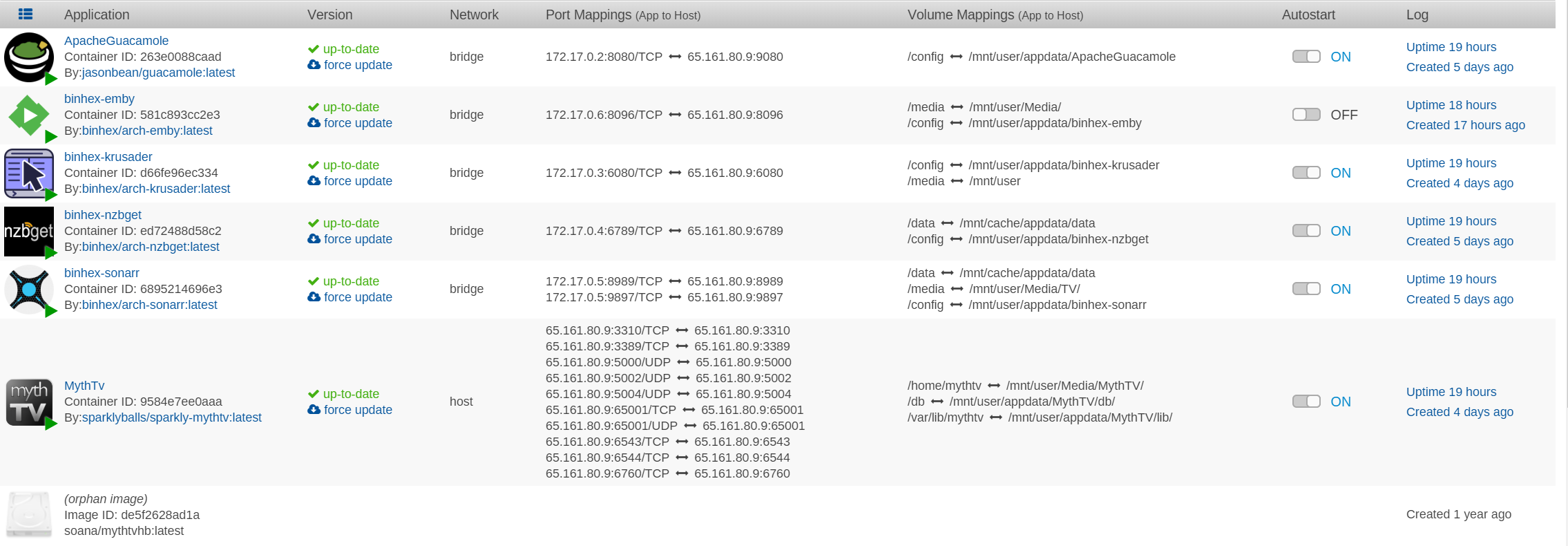

Guys,
 I gotta say as a noob to unRaid, I'm impress with both the software and the community. I have nzbget and sonarr set up and they seem to be working fine. Here is my issue. I can ONLY get sonarr to connect to nzbget on its internal (172.17.0.x) address and NOT the servers IP:Port address. Normally I wouldn't care, but the internal ports change on restart and I have to fix sonarr before it all works again. What have I done wrong and how can I fix it?

1 hour ago, Big Dave Diode said:
Guys,
ok could you post a screenshot of unraid web ui/docker tab/select advanced view top right and then screenshot the entire screen and post it here, that will tell me what ports you are running things on for a start. just to confirm you are correct, you def should not be referencing the internal docker network (as in 172.x.x.x) but instead should be using the unraid host ip and the port you specified when you first configured the container.
As requested. Thanks for your help.

It's very atypical to have an unraid box with a publicly routable IP. What is your network topology?
I used to own those IP's. I sold them, but never go around to readdressing my network. Last time I checked, they were in use by a mining company in Canada. Since I was highly unlikely to link to them, I didn't bother to change anything. Laziness is my middle name. I should address (ahem) the problem, but since it ain't broke, it keeps being pushed back.
This could be your issue, possibly nzbget/sonarr are coded in such a way as to expect private network ranges, so maybe thats causing the problem, i certainly would recommend sorting that out once and for all and get yourself on 192.168.x.x or 10.x.x.x range for your home lan its going to make your life easier in the long run.
I mean, maybe?
The only thing that makes this interesting is I can access the web interface of nzbget with no issues at all. The Host IP works fine. I can access Sonarr by its Host IP as well. Both tools work fine running as a daemon as well. I will keep digging. Thanks for replying I appreciate your work on this. It truly is amazing how smoothly it all works together.
I mean, maybe?
It is a maybe granted, all I can say is this does work out of the box for a vast majority of users, you happen to be the first person with this particular issue who just happens to be running their lan on a public IP range, coincidence, maybe [emoji16]
