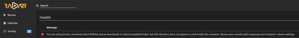

I have a very strange problem
So I have NzbGet, Radarr & Sonarr working perfectly for months but recently I noticed nothing is being downloaded so when I checked
I found out that Radarr cannot connect to NzbGet
When I tested the connection in Radarr I got the following error message "Test was aborted due to an error: Unable to connect to NZBGet. Error getting response stream (ReadDone2): ReceiveFailure"
So can anyone tell me how to solve this?
Keep in mind this setup was working perfectly for months.... I have changed nothing in my server... All I did is I setup deluge and started using it as a torrent downloader but no VPN and no Proxy.
please post a screenshot of the configuration for nzbget in radarr
