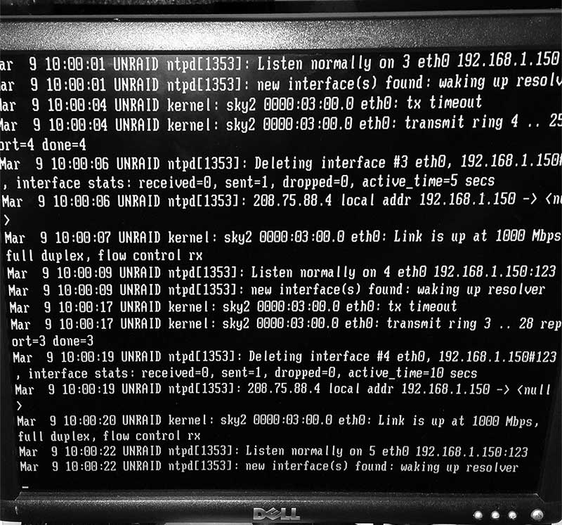

When I went to take a photo, the lines were changing pretty quick, so I missed a bunch of them -- should I do it again -- maybe shoot video?

As far as I can tell that at least confirms it is something at network level that fails.. New interfaces are beiing created.. Must be because they became unavailable somewhere before in the log.. See what johnie.black posted below... This will get you a complete diagnostics set.. I was not aware that could be done from console, it should make stuff clear (at least we then know what the issue is, a little bit of googling then mostly finds a solution..)

So, very strange...
It only took a moment to make it freeze before -- just accessed a few files and hadn't even begun the Parity Check.
This time, with a video camera recording the screen, I have transferred dozens of GB's of data and been running a Parity Check concurrently and it hasn't failed. I even tried accessing identical files.
It seems that the fix is to keep a video camera recording the screen -- that was easier than I thought.

I originally thought you were getting a complete system lockup where even the console was not working. These problems can be particularly hard to resolve as at the point of failure you can no longer get access to diagnostic information.  However if the console remains working then the problem is elsewhere.
If you have a working console session then you should be able to use the
diagnostics
command to get the full diagnostic ZIP file put into the 'logs' folder on the USB stick.  This would include the full syslog amongst other things and other information useful in diagnosing problems.  As long as that command completes OK then it should mean that the unRAID server is basically functioning and the problem probably then comes down to trying to resolve why you are losing access via the network.
Okay, I've collected some video -- I'm hoping that this helps. I've edited it down to a 4-minute file and added a few notes and I'm hoping that for somebody, it will be clear what is going on.  I can't attach a video here, so this is a link to the video on Dropbox...

please use the diagnostics command as mentioned, makes it a lot easier..
Are you using an Marvell 88E8053 gigabit ethernet interface ?
There is an issue that (as far as I can understand) confirms to what you are experiencing... Pretty old issue though... Probably not the same but pointing to the network interface card..
Yes, the dual NIC's are the Marvell Yukon 88E8053's. I have the some issues no matter which is being used.
Is there a HIGHLY recommended GB LAN card that I could purchase and test with? I'm asking because the Marvell Yukon's are on the hardware compatibility list.
