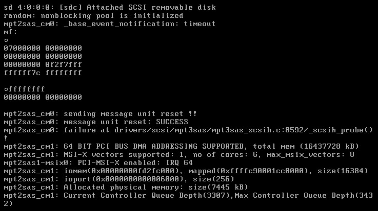

All my disks are missing now (all on M1015 IT mode)
i've got 2 of those in my server and no issues here.
Super weird.  I reverted back to beta18, same deal no disks.  I reverted further back to 6.1.9 and my cards were detected then upgraded to beta19 with no issues....
Diagnostics attached.
I currently haven't added a disk for the 2nd parity slot.
Thanks for the diagnostics.  See my previous reply - same issue.

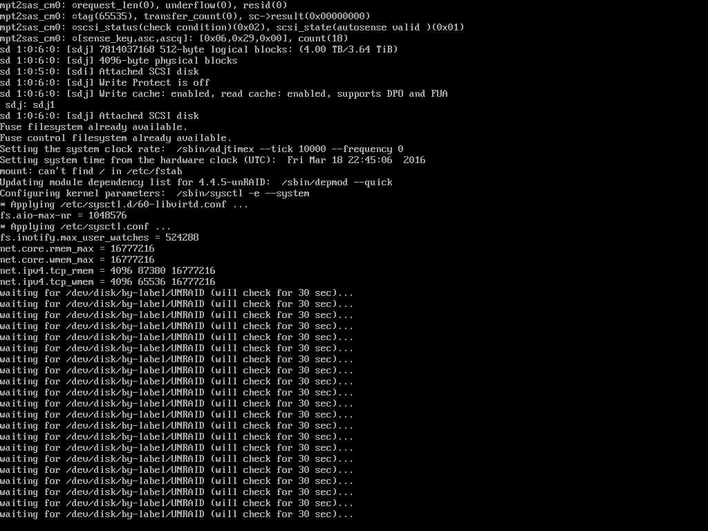

Same issue here with b19 as 18, flash does not mount and therefore OS doesn't load.  I've attached a copy of the log dir which should hopefully highlight the issue.
Attached file is .tar.bz2
unraid_6.2b19.No_unRAIDlabel_logdir.txt

In reference to the bug report above, here's the capture from ipmi console.
Edit: This is with a freshly formatted usb which was formatted and labelled as per spec using windows epxlorer and not rufus as I was previously using.  Reverting back to 6.1.9 fixes the issue so must be kernel or driver related.  Motherboard is a SuperMicro  X10SL7-F (http://www.supermicro.co.uk/products/motherboard/Xeon/C220/X10SL7-F.cfm) and the usb stick is connected to a USB2 port which is as far as I'm aware connected to an Intel® C222 Express PCH controller.
