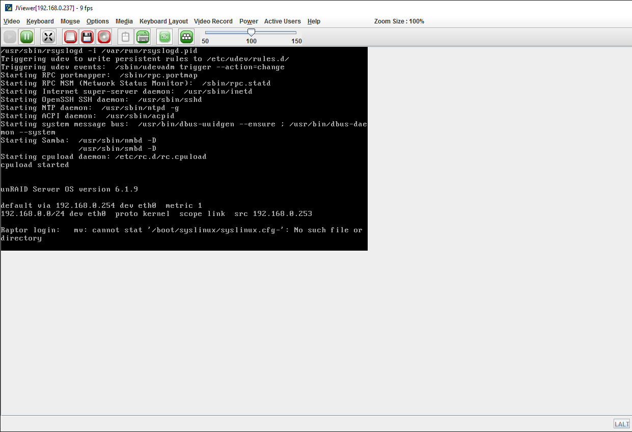

In reference to the bug report above, here's the capture from ipmi console.
Edit: This is with a freshly formatted usb which was formatted and labelled as per spec using windows epxlorer and not rufus as I was previously using.  Reverting back to 6.1.9 fixes the issue so must be kernel or driver related.  Motherboard is a SuperMicro  X10SL7-F (http://www.supermicro.co.uk/products/motherboard/Xeon/C220/X10SL7-F.cfm) and the usb stick is connected to a USB2 port which is as far as I'm aware connected to an Intel® C222 Express PCH controller.
The problem is happening earlier than your screenshot shows, and your system log attached in previous post is too garbled to read  :o  btw: how'd you get that log if you can't mount the usb flash?
Did you try some of the other usb ports?
Core linux os is loading so ssh is enabled, logged in and scp'd it across - garbled how?  File is a tar bz2 of the whole log directory.  Attached is the syslog extracted out the archive.
Tried all the usb ports, 1 on motherboard for hypervisors, 4 on back, 2 on front and 2 usb3s
Right didn't realize it was .tar.bz2.
Do you see messages like this on the console during boot?
waiting for /dev/disk/by-label/UNRAID (will check for 30 sec)...
The syslog doesn't really shed any light.
At console, what do you get for output of these commands?
lsblk
v /dev/disk/by-label
Finally, does this work?
mount /dev/sda1 /boot
ls /boot
<should see files on your usb flash>

The whole "waiting for /dev/disk/by-label/UNRAID (will check for 30 sec)..."
I'm running 6.1.9, tried updating via the plugin update and saw this! (attached screenshot)
That's what happened as soon as I tried to update the plugin
