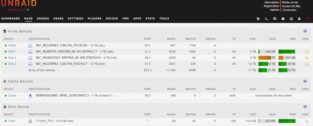

Since I have written about formatting many times in the forum, I thought I would make a FAQ for it so I can just post a link to it in the future. I am posting my thoughts here for feedback, especially wrt the reformatting steps, since I am not going to test them. I would also be willing to put this in the Wiki (where?).
Formatting Disks in unRAID
The word "format" means "write an empty filesystem". That is what it has always meant in every operating system you have ever used. You must let unRAID format any data disk it will use in the array or cache pool.
Note that format is a write operation. When you format a disk that is part of the array, unRAID treats this write just as it does any other, by updating parity. So, after the format is done, parity agrees that the disk has an empty filesystem. Format is NEVER part of the process of rebuilding a data disk.
Sometimes, unRAID does not need a formatted disk. The parity disk does not need to be formatted since it has no filesystem.
A disk that will be used to rebuild another disk does not need to be formatted, since it will be completely overwritten with the original disk's data.
A formatted disk is not a clear disk, since it has a filesystem written to it. When you add a disk to a new slot in the parity array, it must be clear so parity will remain valid. If you don't preclear it, unRAID will clear it.
Changing the format of a disk in the array
If there are any files on the disk you wish to keep, copy them somewhere else. Then, in the webUI:
Main - Array Operation - Stop.
Main - Array Devices - click on the disk you wish to reformat to get to the settings page for the disk.
Select the File system type.
Main - Array Operation - Start will start the array and format the disk.
To change the format of any disk in the array:
A tad misleading since you don't outright say to copy the data off of the disk prior to formatting.  Although you do say in the main body that formatting erases everything, I'm worried that people will ignore the body (who reads nowadays?) and go straight to the step by step.
Updated post to help keep people who don't bother to read from reading the wrong parts and making a mistake. Yes, I know it has happened many times with other instructions around here. ;)
It seems my Formatting FAQ tells about reformatting, but doesn't say a lot about actually formatting in the webUI. And it should probably also include something about not formatting when you have an unmountable disk. I will be away for a few hours so can't get to it right now, just looking for some more feedback.
*edit* I have moved it from the FAQ to this thread until I can gather enough information to finish it properly.
