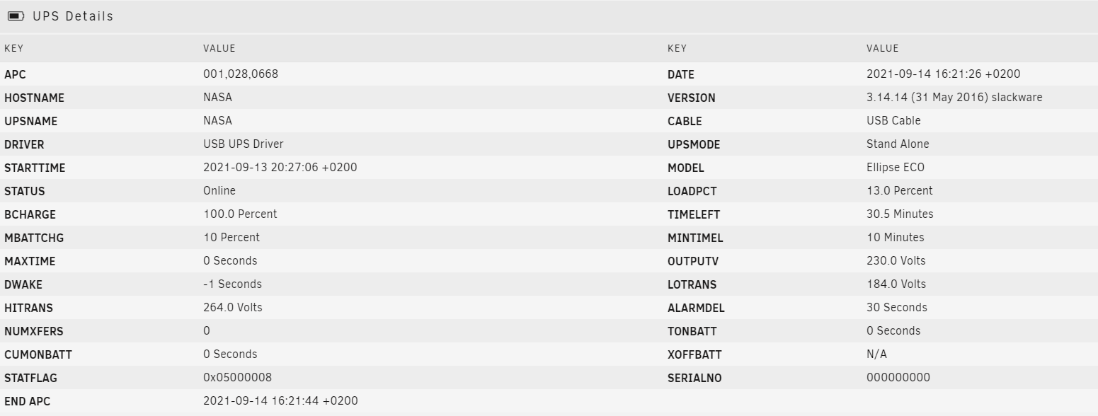

September 14, 20215 yr I can also suggest the Eaton Ellipse PRO 650 USB. Working with UnRaid now and with Synology before pretty good. It can stand or lay and you get replacement batteries easily. http://powerquality.eaton.com/Products-services/Backup-Power-UPS/Ellipse-PRO.aspx?cx=75&GUID=1C985AF1-CE32-404A-B39F-3D9116038A6E http://powerquality.eaton.com/ELP650DIN.aspx?cx=75
