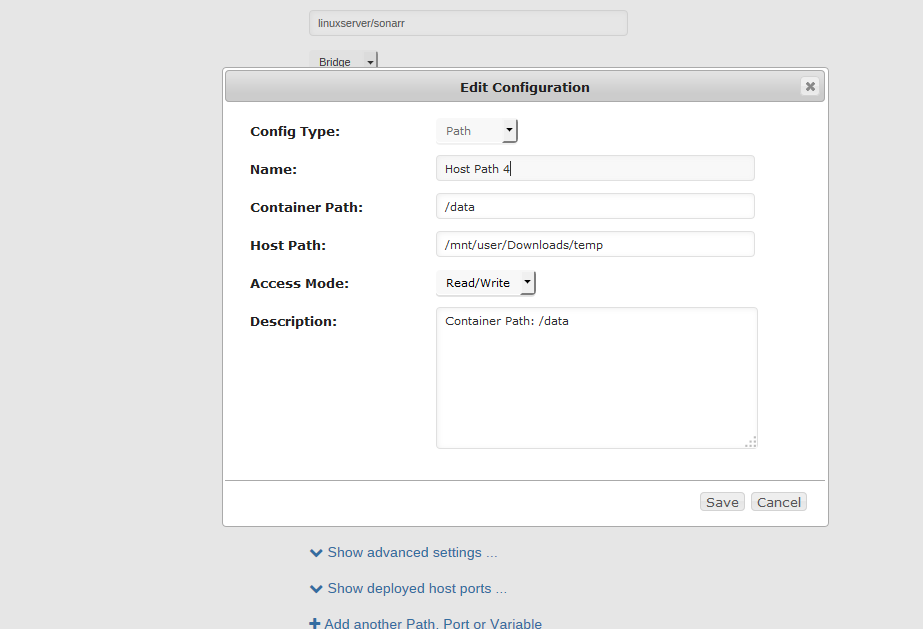

Yep. Pick either /data or /downloads and change them all to be the same. Since you are changing the app side you will need to hit the edit button on the mapping to change it. After you change the mapping, be sure to change the app itself to look in the correct folder.

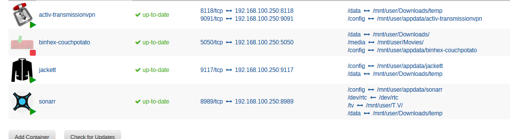

Hi jonathanm, thanks for the response. I have done as you said above and changed all the container path's to  /data and host path's to /mnt/user/Downloads/temp creating a temp file in Downloads. Still no sign of any download files in the new directory.

In sonarr and Trasmission I have tried
/data --> /mnt/user/downloads/
/downloads --> /mnt/user/downloads/
I can see in the unraid gui under share's a new share called "downloads", but I cannot see it in windows explorer. I have changed the container path from "data" to "downloads" to no avail. I am not using the cache for this folder, . Its quite frustrating as I know its close to working.

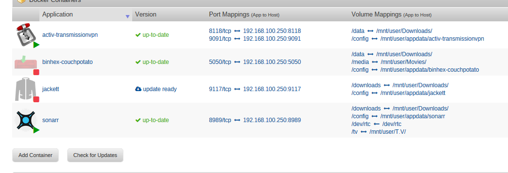

Anyways, if you're using this in Transmission now:
"download-dir": "/downloads/complete",
"download-queue-enabled": true,
"incomplete-dir": "/downloads/incomplete",
"incomplete-dir-enabled": true,
Its looking for a folder "downloads" (with a lower case "d") in the docker container:
If you already have a downloads share created named "Downloads" with a capital "D", then use this for Transmission (you should also have "Downloads" referenced in Sonarr):
/downloads --> /mnt/user/Downloads/
When you set it as this:
It created the share "downloads" with a lower case "d"
Make the changes above to reference "Downloads" with a capital "D" and then delete the "downloads" share with the lower case "d"
If you're using Windows to find the share on the network, I don't think it can distinguish between "Downloads" and "downloads".
I think that should do it!

Would you mind posting your settings.json and a screen shot of your docker configurations?  Maybe we can spot the problem.
