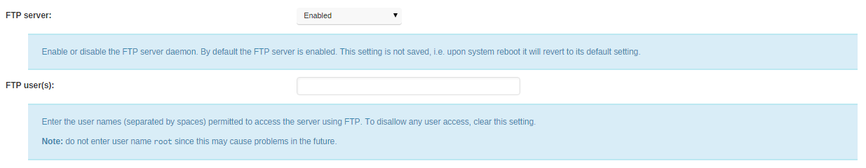

What you describe above is actually intended behaviour and not a defect report. See also the help which goes along with FTP (see attachment).
The FTP daemon is always started upon system start up, but as long as no users are defined it is not possible to do any FTP transactions. Agreed, this is a debatable situation, hence the possibility to completely stop the FTP daemon from the webGUI.

FTP is always enabled after a reboot (=FTP daemon is started), if you had users entered then FTP transactions are allowed too. Again this is intended behaviour.
It will correctly show that the FTP server is "enabled" and "running" in the status bar.

I can partly explain how it came about, which is not a justification as you are asking, but may give you more inside.
The original design of unRAID - dating back to the 4.x versions - always starts the FTP daemon after a system reboot and the only way to allow or disallow FTP transactions is by entering or clearing the users field. This implementation hasn't changed over the 5.x and 6.x versions as far as I know.
There is no "state" variable defined within unRAID to tell whether the FTP daemon should start or not upon a system reboot.
I found it questionable to have a running FTP daemon (active ports), while not using the service, hence the possibility was added in the webGUI to at least stop the daemon when not needed, but since it can't be linked to a state variable, this setting won't survive a reboot.

If the ftp daemon respected permissions I'd have a use for it but
All user names entered above are permitted to access the server via FTP and will have full read/write/delete access to the entire server, so use with caution
makes it almost entirely useless and quite a liability. I'd rather have a decent ftp daemon built-in than have to use a Docker - it wouldn't have to be especially configurable; just give the appropriate access to the registered users to the files in the appropriate shares, and certainly not give blanket access to private shares.
