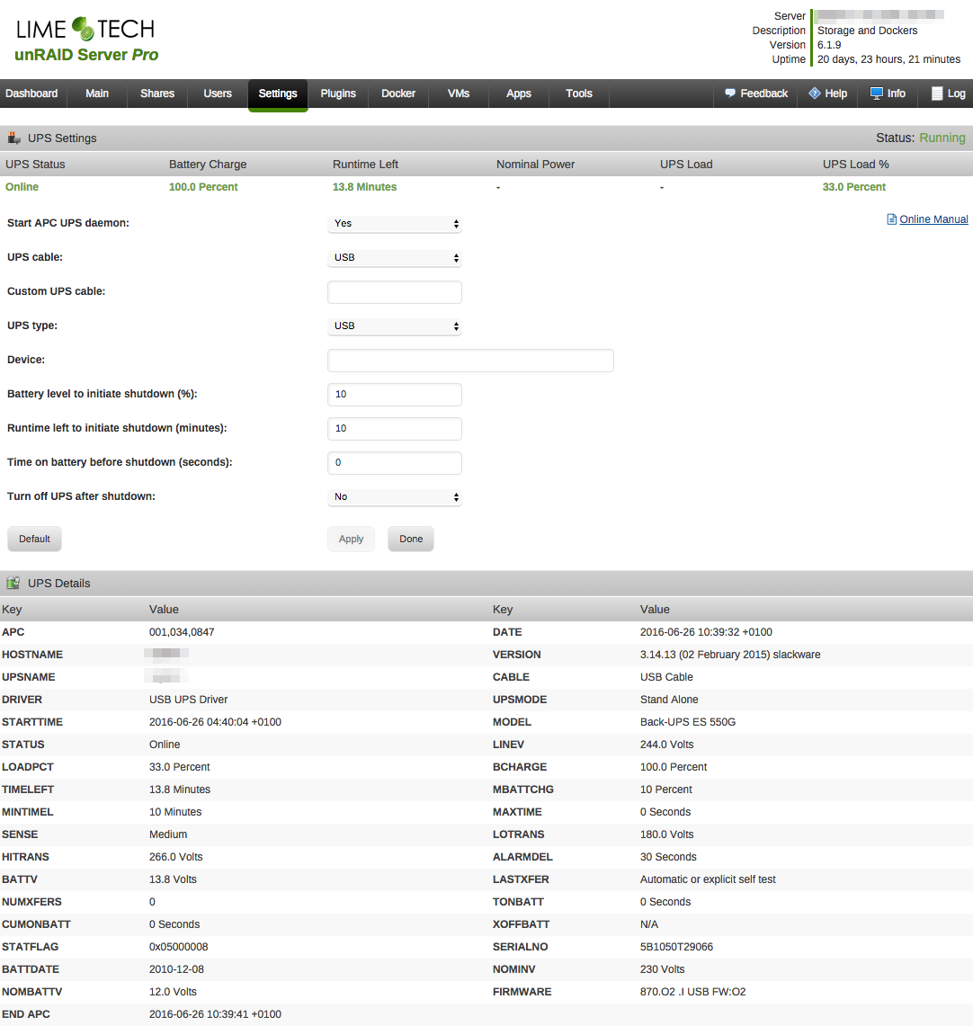

I have a really annoying loud beep that lasts around 10 seconds coming from my unraid box, the syslog tells me the Battery Backup is disconnecting but I have no idea why? I've changed the battery in the UPS to rule that out.
Jun 26 08:25:57 bigbird apcupsd[17593]: Battery disconnected.
Jun 26 08:26:08 bigbird apcupsd[17593]: Battery reattached.
Jun 26 09:59:39 bigbird apcupsd[17593]: Battery disconnected.
Jun 26 09:59:50 bigbird apcupsd[17593]: Battery reattached.
Jun 26 10:08:52 bigbird apcupsd[17593]: Battery disconnected.
Jun 26 10:09:03 bigbird apcupsd[17593]: Battery reattached.
Jun 26 10:22:01 bigbird apcupsd[17593]: Battery disconnected.
Jun 26 10:22:12 bigbird apcupsd[17593]: Battery reattached.
Does anyone have any ideas that I can test / try?

The UPS has run fine for 2 years, this is a recent problem. I initially just figured it was the UPS battery failing so I replaced it. The cable is the standard APC cable, USB at one end and proprietary connector at the UPS end.

Hmmm I think you're right, but having tested the shutdown process by pulling the plug it works as expected.

Update: I shutdown my server in the hope of finding a removable speaker on the motherboard (there wasn't). Anyway I removed the APC end of the USB cabled and cleaned the contacts with alcohol, rebooted the server and everything has been just fine for the last 12 hours.
