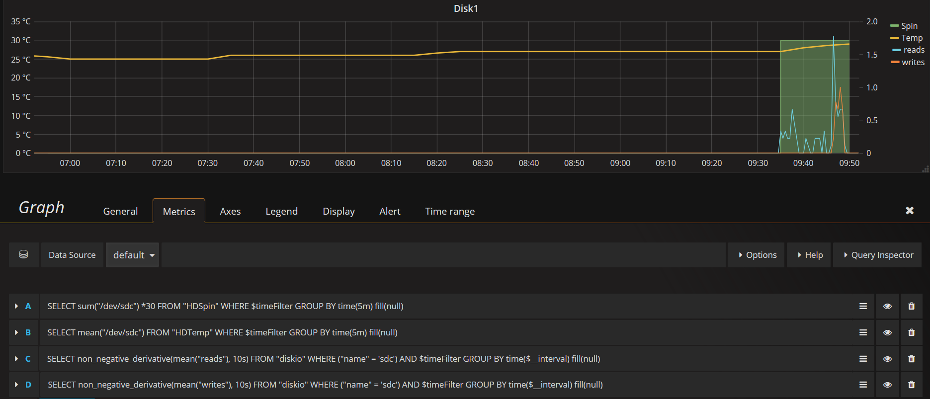

Ran into an odd problem.  I've had to rebuild my Grafana server and since I built it on Ubuntu 16.04, I followed the guidance and install the Grafana 3.0 beta and the latest version of InfluxDB.  I updated the Unraid script for the new DB.  Something is unhappy with the setup though and I suspect it has to do with how the scripts are writing data to InfluxDB.
All of the Unraid metrics are doing the same thing.  They will not display by default.  I have to change them to points instead of lines.  Then, they only work for 5 metrics at a time.  If I add a 6th metric, such as for drive temps, it won't display it unless I hide one of the others.  This is the case for any of the Unraid reported stats using these scripts.
Telegraf gathered stats work fine and don't behave in the same way.  Anyone run into this and know a fix?  Is this a problem with how the scripts write to InfluxDB?
As soon as I posted this, I figured it out.  Change the "Fill" from null to none.  Working well now.

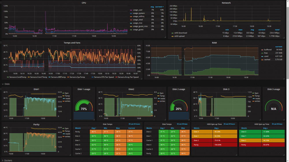

On 02/06/2017 at 3:02 PM, Lynxphp said:
n attachement, a preview of a part of my grafana dashboard. It doesn't illustrate my problem, i just post it as eye candy.
How do you get the disk spin state to plot like this? Seems like you have three Y-axis?
I'm trying to plot a thermostat like this where temp/humidity are Y1 and Y2, but I want the on/off state of heater to be plotted like your spin state here :)

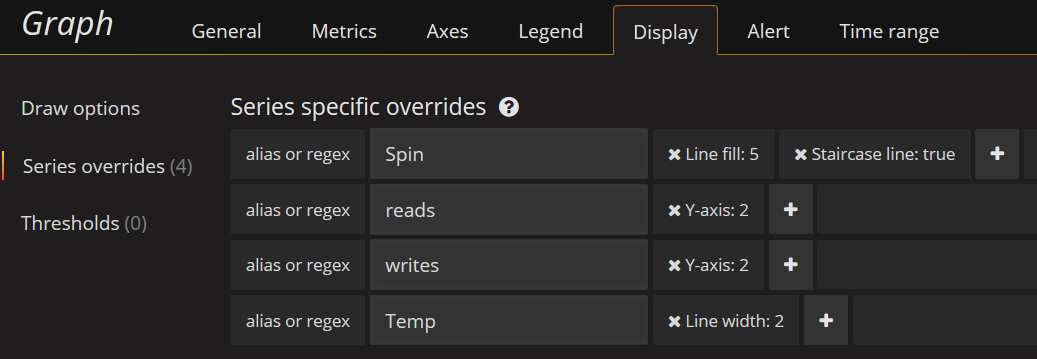

I think that what you are looking for is the "staircase" display type combined with "line fill" (see attached screenshots). I have it in the series override, because I only wanted the HDD spin to be displayed like this, but you can also specify it in the draw options -> Staircase checkbox & FIll.
I hope that helps!
Edited by Lynxphp
But that means you have it on Y-axis 1, how does that work when its using temperature? Spin seems to be "30" when its spinning, did you just multiply it to make it look like this?
