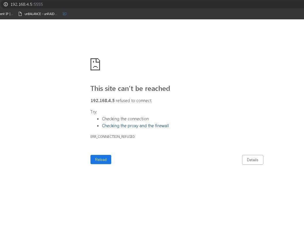

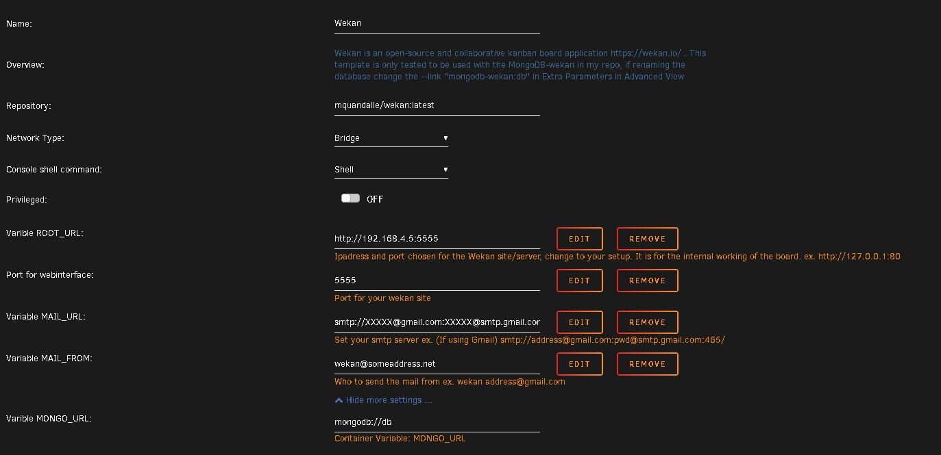

Hi Kru-x,
This docker looks amazing and I have been trying to get this up and running but haven't had any luck. I know I am missing something easy but being a complete novice I'm not sure what I am missing so any help / guidance would be appreciated.
Currently when I start the wekan app I get the following error,
These are my settings
I am using the following link to add the Wekan and Mongo DB dockers.
https://github.com/Kru-x/unraid-docker-templates
Hi and yes it is a great program I use it all the time, you have to link the DB container under Extra Parameters, have you done this? If not flick the switch "Advance View" and in the field add --link "mongodb:db" this will link (connect) the two containers together.
Let me know if it works for you,

Sorry for any inconvenience there was a change that I didn't take in to account, I have now updated my repo and are using the container from the wekanteam/wekan.
Until the Community Application has merge the changes you can install the container by:
Installation Go to the unRAID control panel -> extensions -> Docker In the textarea for Template repositories add https://github.com/Kru-x/unraid-docker-templates and press save.
Use the MongoDB container from Taddeusz' Repository, can as well be found in Community Applications.
