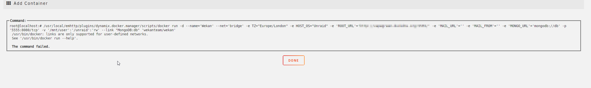

Forgive me as I am completely new to unRAID so I am probably missing something completely simple.
I am not able to get this container running.
I am trying to get the container running behind a reverse proxy (NPM) and have the following settings:2123344659_Annotation2020-07-05175847.png.0e5c7974cd20cab876a69d5479441922.png
I am getting this error:
/usr/bin/docker: links are only supported for user-defined networks.
See '/usr/bin/docker run --help'.
The command failed.

For Varible MONGO_URL use:  mongodb://192.168.1.121:27017/admin, witch is the admin login for MongoDB. Also if you are behind a revers proxy the varible ROOT_URL should be https://yourdomain.com, else if you are only using it internally it should be http://192.168.0.37:5555

It errors for me as well, telling me links aren't supported. Can you please make a version where MongoDB is integrated into the package? This would certainly avert a lot of problems (see above) and would make it easier to get started.
The way I understand Docker, is that a docker should be self-contained. So it should contain everything it needs to run, and only go to the "outside world" for file system storage, and configuration files.
If you are unable to do this, could you at least make an easy to follow "getting started" guide? Docker being Docker, and unRAID being unRAID, it should be more or less identical for nearly everyone.
Hi thany,
You are right, I should probably do a "getting started" guide as it all change a few years ago making the --link option redundant and that the unraid team rightfully deleted my MongoDB that was setup for wekan in lieu of the official newer MongoDB container that has different credentials, but its all there in the latest post's how to set it up today. The reason I have not bother too much with it is that wekan is more for companies and organizations that probably would have an IT guy to figure out the setup. For me as a nob, I have moved away from wekan even if it is a nice system. I have gone for simpler systems and more all around like nextcloud (not that NC is a simple system, very powerful) that has the similar functions and more other goodies to choose from.
As for integrating the MongoDB, not sure if it is a docker out there to do that, but the main reason not to, is that it is better to separate the program from the DB and have two separate instances for easier and safer retention of the data. Most and many containers are doing this and it is just to get the head around it, then most containers are working in the same way with similar setup.
Kru-x

Can't figure what I miss...
I got to do something with mongoDB docker, or just install?
MongoDB:
Wekan LOG:

MongoNetworkError: failed to connect to server [192.168.1.10:27017] on first connect [Error: connect EHOSTUNREACH 192.168.1.10:27017

can somebody help me?
thanks!
MongoDB:
Wekan LOG:
thanks!
Sorry I answered a little bit too quick and now when I have read your post properly: I have seen several time that when people uses custom networks it fails, I would set it to bridged and remove the custom IP, next remove the link option and try. Ones you got it working then try with custom networks, but I think that is the problem.
Kru-x
oh ... I was convinced that I read that it was mandatory ...
my fault...
thank you so much! now works!
Please can you just point me in the direction of a step by step guide....I cannot get this to work
Edited by kyphos
What's the problem? Check this post screenshots:
 but leave the network to bridged. And remove the --link property.
Kru-x
Hi everyone,
I am totally new to this and if you get an install error, ensure you delete the "orphan" docker container under Docker Containers; see first picture. After you delete it, go to apps, search for Wekan, and toggle the advanced view slide. Then delete --link "MongoDB db"
I hope it helps someone to get the last picture.
Please anyone can you explain this step by step. I know I maybe dumb but I cannot get this to work. Not even close.
