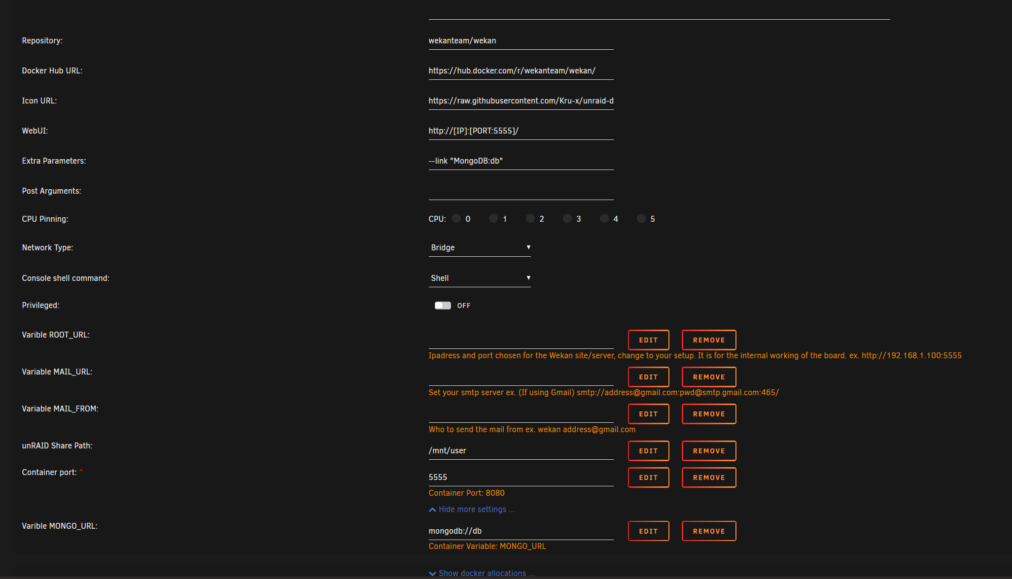

Hi Kru-x,
Thank you for responding so quickly, much appreciated.
I did make sure that the, --link "mongodb:db" was included in the Wekan Container.
I believe I do have the right settings but I still get the message above indicating the site cannot be reached. I change the port to 5000.
MongoDB Settings,
Wekan Settings,

  • It's not much to show, the key is the --link "mongodb-wekan:db" in Extra Parameters in Advanced View this links the DB to the wekan container. The rest should be straight forward, the variables ex. RO

Hi, it was that I had used an template that should have been used with my mongoDB container, that changed. I have update the template, so try this.
Leave the mongo db as it is and delete the wekan template and the container when asked, add go to community applications and add the template from there, make sure the template are using from https://hub.docker.com/r/wekanteam/wekan/ (you see it in advanced settings).
Then adjust your settings as per your settings above, you don't have to use "mail url & mail from" just leave them blank until you want wekan to send mails. You can leave port 5555 if you have not assigned it to another container.
That should do it, let me know,
Kru-x
Edited by Kru-x
Spelling

Anybody got this working with a reverse proxy? As soon as I switch it over I lose the database.
I did notice that `--link` has (will be) been depreciated and tried to use the URL optionbut wasn't able to link it.
```- MONGO_URL=mongodb://wekandb:27017/wekan```
It works fine, used it for years.
The -- link (if you mean in the setup, is a docker function ) and is used to link the two containers together. it should say --link "MongoDB:db" if "MongoDB" is your  mongo container. And where did you get the "Mongo_URL" from? My template is using  "ROOT_URL" and that should be set to "http://yoursite.com" to make it work behind your proxy.
Hope it helps,
Kru-x
I have it working fine locally, once I switch networks to the proxy network on both containers Wekan is unable to connect to the Mongo database.
I looked up the documentation for the docker being used and saw the "MONGO_URL" variable there. When I could not get the DB to link properly I looked up the --link documentation on docker and saw there that it is being depreciated (but will still work for now)
Root URL I have set, I might delete everything and try to start it again with reverse proxy from the start. Thank you Kru-x.

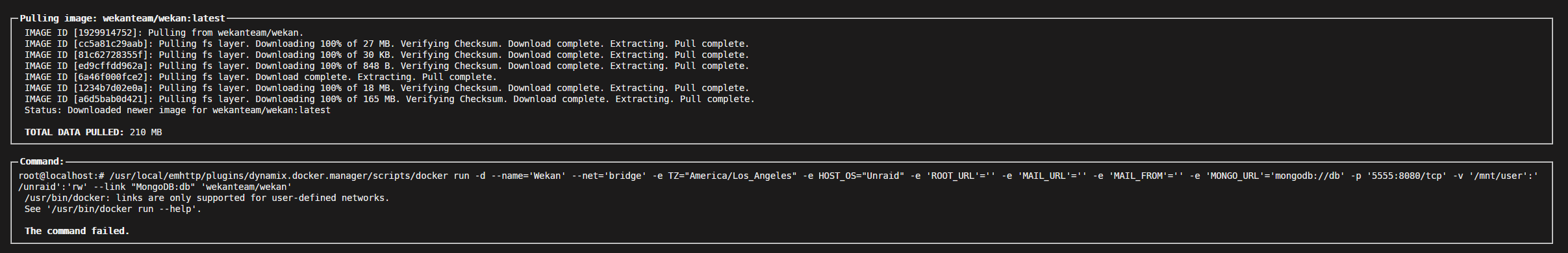

well it was working great til i pulled down a docker update.
now the docker barfs with this and wont start:
MongoError: database name must be a string
at Function.create (/build/programs/server/npm/node_modules/meteor/npm-mongo/node_modules/mongodb-core/lib/error.js:43:12)
at validateDatabaseName (/build/programs/server/npm/node_modules/meteor/npm-mongo/node_modules/mongodb/lib/operations/db_ops.js:720:22)
at new Db (/build/programs/server/npm/node_modules/meteor/npm-mongo/node_modules/mongodb/lib/db.js:181:3)
at MongoClient.db (/build/programs/server/npm/node_modules/meteor/npm-mongo/node_modules/mongodb/lib/mongo_client.js:268:14)
at packages/mongo/mongo_driver.js:186:25
at runWithEnvironment (packages/meteor.js:1286:24)
any ideas?

I also am having this issue: "MongoError: database name must be a string"
Unfortunately I am currently using Wekan for a time critical project :(
I'll try rolling back any updates...
EDIT:
Switching from the "latest" Wekan image to the "devel" image under the mquandalle repo worked: https://hub.docker.com/r/mquandalle/wekan/builds
Edited by archerkg
fwiw i was able to finally the docker started by making a change to MONGO_URL variable in the wekan docker.
i should note that the --link mongodb:db which was populated in extra arguments (and was there on the docker update last night) has been removed completely.
HOWEVER IN MAKING THIS CHANGE IT CREATED A NEW DATABASE AND I LOST ALL PREVIOUS WORK
it may still be somewhere in mongo, but i dont know mongo like i know mysql, so who knows.
my dockers are set up in such as way so as they do not all share a proxynet, but instead have their own IP addresses.  for example mongodb docker is on 10.720.140
to make the wekan docker start, i changed the MONGO_URL to be:
mongodb://10.72.0.140:27017/db
instead of the previous MONGO_URL of
mongodb://db
I realize this change was not advisable as per one of the messages above, but this was the only way i could get it all to start.
i am almost positive this is not the correct way to do it, but this way it starts and the log files are all nominal
mongodb://db
See the above answer or my first post in this thread, the --link mongodb:db should be included. That's a docker function for the containers to link the containers to each other.
In your case I am not sure as I don't use separate networks but the MONGO_URL is for the the internal working ex. if you access wekan from a different ip address eg. if you are behind a reverse proxy.
How did your configuration look like b4 the "crash" as the data resides in the DB saved in your wekan DBfolder, in your case I would delete both containers (NOT the wekanDB folder) follow the instruction on the updated versions. And try to put your "mongodb://10.72.0.140:27017/db" in front of the --link. But if you got it to work, great.
mongodb://db
I bet your old db/data are still there. On  your case, try changing to: mongodb://10.72.0.140:27017/admin

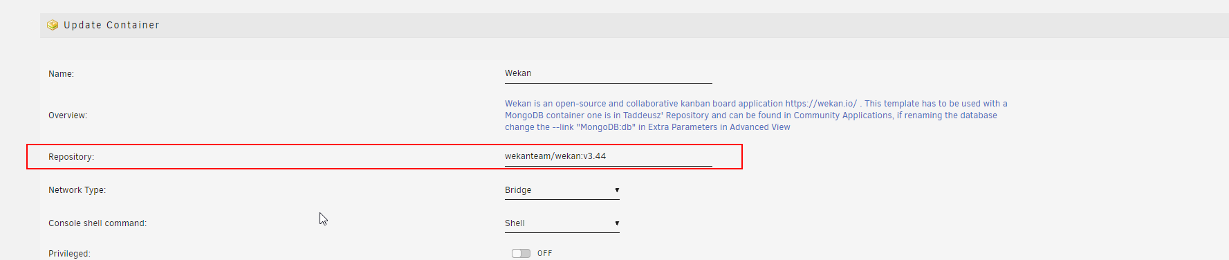

After updating today 30.09.19 we can no longer move cards by dragging them. Big issue for us, I was hoping to request that the docker version tot change to the "old" 3.44 as this new version has drag handle changes.
Lesson learned if nothing else, if it is working do not update.
more about this new "bug" can be read here - https://github.com/wekan/wekan/issues/2739
Hi Nik82,
Yea you are right and it is a bug that the wekan team would be aware about, sure it is going to be rectified within days. Meantime if you don't want to wait just put the version tag on the "repository" you want to use. ie, revert to the older container. Just add the version number after the repository like "wekanteam/wekan:v3.44". You can see all he version numbers in wekan teams image in docker hub.
Just keep an eye on it and delete version number to use the lastest build when the problem is fixed.
23 minutes ago, Kru-x said:
Hi Nik82,
Thanks for the reply :)
Unfortunately I am to dumb to figure out how to do this, not a problem though we will just have to wait a couple of days until this has been resolved.
EDIT: Spoke to soon, found it and it works :D
Thank you!
If anyone else is as dumb as me here is the setting that Kru-x so nicely provided :)
just click edit on the docker and change this field.
Edited by nik82

imageproxy.php?img=&key=e5eec7c5c933ca16I try to install this docker follow you guide. However, I get The command failed at the end. Any idea how can i fix it. I am on unraid 6.8.
image.thumb.png.4605161c6a6064d7e5021b0fefa8b025.pngimage.thumb.png.83a385f5db08b42dc68908bb36d940e8.png
