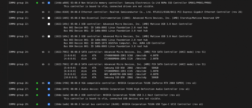

Hi there,
sadly I got the same error after some rebuilding.
I got a new CPU + board + RAM and I need to reboot a lot of times due to bios settings.
The first tries nothing happens, but now - as I finished my bios settings - the disk shows the message
Device is disabled. Contents Emulated
I attached my diagnostics. Can someone please help me out?
Thanks in advance.
v1ew-s0urce-diagnostics-20201024-1614.zip
Since you rebooted before getting diagnostics, we can't tell anything about why the disk was disabled. Also, those diagnostics are without the array started so there are many things we can't tell about your situation, most especially whether or not the emulated disk is mounted.
Start the array and post new diagnostics.
ahh.. ok. I deactivated "Auto Array Start" due some problem in the past when a cache drive is not available and the array just started.
And now I was not sure wheather or not it's a good idea to start the array - just wanted to wait for some replies
Here is the new diagnostic file - in the meantime a runned a SMART test - everything fine.
he mentioned HDD is just a couple of months old.
Thanks for your help, @trurl
v1ew-s0urce-diagnostics-20201024-1858.zip
