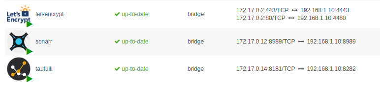

July 20, 20188 yr 1 hour ago, zyphermonkey said: Okay so I got that part fixed. I have no idea how it happened but the "container ports" got changed to match the "host ports" and obviously nothing worked after that. Now I'm trying to set up some subfolder services and the only way I can get them to work without getting a 500 error is to have the following with a lot of the default settings commented out. I don't think I should be doing this. Is there something I need to configure in proxy.conf to get the default way to work? # first go into tautulli settings, under "Web Interface", click on show advanced, set the HTTP root to /tautulli and restart the tautulli container # to enable password access, uncomment the two auth_basic lines location /tautulli { # auth_basic "Restricted"; # auth_basic_user_file /config/nginx/.htpasswd; include /config/nginx/proxy.conf; # resolver 127.0.0.11 valid=30s; # set $upstream_tautulli tautulli; # proxy_pass http://$upstream_tautulli:8181; proxy_pass http://192.168.1.10:8282; } Did you read and follow the readme in that folder?
July 20, 20188 yr So I missed the section at the bottom that mentions making a new custom network and moving all your containers over to it. Is that really necessary or is it enough to just have them all on the same network? All my dockers are on the same internal docker network (bridge). The issue appears to be with the resolver setting. If I disable it and set it statically in the .conf file it works fine. location /tautulli { auth_basic "Restricted"; auth_basic_user_file /config/nginx/.htpasswd; include /config/nginx/proxy.conf; # resolver 127.0.0.11 valid=30s; set $upstream_tautulli 172.17.0.14; proxy_pass http://$upstream_tautulli:8181; # proxy_pass http://192.168.1.10:8282; } I also can't resolve docker names from within the docker and there is nothing static in the hosts file except for local info. root@dcb925741e00:/$ nslookup tautulli nslookup: can't resolve '(null)': Name does not resolve nslookup: can't resolve 'tautulli': Name does not resolve root@dcb925741e00:/$ cat /etc/hosts 127.0.0.1 localhost ::1 localhost ip6-localhost ip6-loopback fe00::0 ip6-localnet ff00::0 ip6-mcastprefix ff02::1 ip6-allnodes ff02::2 ip6-allrouters 172.17.0.2 dcb925741e00 root@dcb925741e00:/$ cat /etc/resolv.conf # Generated DNSv4 entries: nameserver 208.67.222.222 nameserver 192.168.1.1 # Generated DNSv6 entries:
July 20, 20188 yr 8 hours ago, zyphermonkey said: So I missed the section at the bottom that mentions making a new custom network and moving all your containers over to it. Is that really necessary or is it enough to just have them all on the same network? All my dockers are on the same internal docker network (bridge). The issue appears to be with the resolver setting. If I disable it and set it statically in the .conf file it works fine. location /tautulli { auth_basic "Restricted"; auth_basic_user_file /config/nginx/.htpasswd; include /config/nginx/proxy.conf; # resolver 127.0.0.11 valid=30s; set $upstream_tautulli 172.17.0.14; proxy_pass http://$upstream_tautulli:8181; # proxy_pass http://192.168.1.10:8282; } I also can't resolve docker names from within the docker and there is nothing static in the hosts file except for local info. root@dcb925741e00:/$ nslookup tautulli nslookup: can't resolve '(null)': Name does not resolve nslookup: can't resolve 'tautulli': Name does not resolve root@dcb925741e00:/$ cat /etc/hosts 127.0.0.1 localhost ::1 localhost ip6-localhost ip6-loopback fe00::0 ip6-localnet ff00::0 ip6-mcastprefix ff02::1 ip6-allnodes ff02::2 ip6-allrouters 172.17.0.2 dcb925741e00 root@dcb925741e00:/$ cat /etc/resolv.conf # Generated DNSv4 entries: nameserver 208.67.222.222 nameserver 192.168.1.1 # Generated DNSv6 entries: Please read the manual. We put a lot of time and effort into them: https://github.com/linuxserver/docker-letsencrypt/blob/master/root/defaults/proxy-confs/_readme#L21 It needs to be a "user defined" bridge network, not the default
July 22, 20188 yr On 7/20/2018 at 7:36 PM, aptalca said: Please read the manual. We put a lot of time and effort into them: https://github.com/linuxserver/docker-letsencrypt/blob/master/root/defaults/proxy-confs/_readme#L21 It needs to be a "user defined" bridge network, not the default Gotcha. Doing that and reverting all my .conf's back to their default settings worked. I feel like this should be in the 1st post on this thread. Everything else was straightforward for me without digging into any manuals except for this. Could just be me though. 1. Create new docker network a. docker network create my-bridge 2. Install letsencrypt-docker using new network 3. Move any dockers you want to proxy to new network. Edited July 22, 20188 yr by zyphermonkey
July 22, 20188 yr 1 hour ago, zyphermonkey said: Gotcha. Doing that and reverting all my .conf's back to their default settings worked. I feel like this should be in the 1st post on this thread. Everything else was straightforward for me without digging into any manuals except for this. Could just be me though. 1. Create new docker network a. docker network create my-bridge 2. Install letsencrypt-docker using new network 3. Move any dockers you want to proxy to new network. You read it and still ignored it the first time. I doubt putting it in the first post would make a difference.
July 22, 20188 yr 7 minutes ago, aptalca said: You read it and still ignored it the first time. I doubt putting it in the first post would make a difference. I didn't ignore it (but did ask a valid question about it) because it didn't make any sense to me at the time and honestly still doesn't. Why do docker names resolve via an internal docker dns server on a custom network, but not the default unraid bridge? There's no explanation as to why it's necessary to switch all your containers to a new network and the requirement to do so isn't listed on the 1st post or default landing page for docker hub or github where almost all other instructions and requirements are listed. I only made a suggestion to help improve the experience for others who might run into the same issue I had. Everything else during the setup I expected, but this wasn't one of those. I wasn't trying to criticize anyone's work and really appreciate the container.
July 22, 20188 yr 51 minutes ago, zyphermonkey said: I didn't ignore it (but did ask a valid question about it) because it didn't make any sense to me at the time and honestly still doesn't. Why do docker names resolve via an internal docker dns server on a custom network, but not the default unraid bridge? There's no explanation as to why it's necessary to switch all your containers to a new network and the requirement to do so isn't listed on the 1st post or default landing page for docker hub or github where almost all other instructions and requirements are listed. I only made a suggestion to help improve the experience for others who might run into the same issue I had. Everything else during the setup I expected, but this wasn't one of those. I wasn't trying to criticize anyone's work and really appreciate the container. https://docs.docker.com/network/bridge/#differences-between-user-defined-bridges-and-the-default-bridge And here: https://blog.linuxserver.io/2017/10/17/using-docker-networks-for-better-inter-container-communication/ Github page tells you to read the preset conf readme: https://github.com/linuxserver/docker-letsencrypt/blob/master/README.md#site-config-and-reverse-proxy Edited July 22, 20188 yr by aptalca
