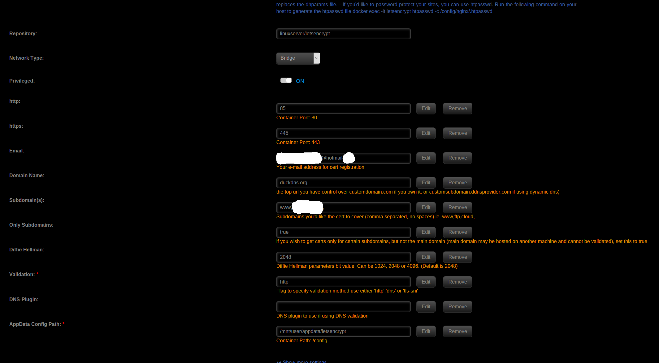

6 hours ago, Odessa said:
@CHBMB Thank you very much, here is my LE run command:
https://pastebin.com/sTnfSFkk
My LE log:
https://pastebin.com/9DawkVww
[personal info obfuscated]
I see the error regarding port in the log, but 443 does not show as used in my docker mappings. Note I cannot currently access the default web page from outside, I get "ERR_CONNECTION_REFUSED" in browser.
Issue 1: you are redirecting from www.yourdomain to yourdomain, however you have the option only_subdomains set to true, so your cert only covers www, but not yourdomain
Issue 2: are you using ldap for authorization? How is that set up?
Issue 3: nginx isn't even starting for you because you have another site config enabled somewhere with a server block that contains the "default_server" directive

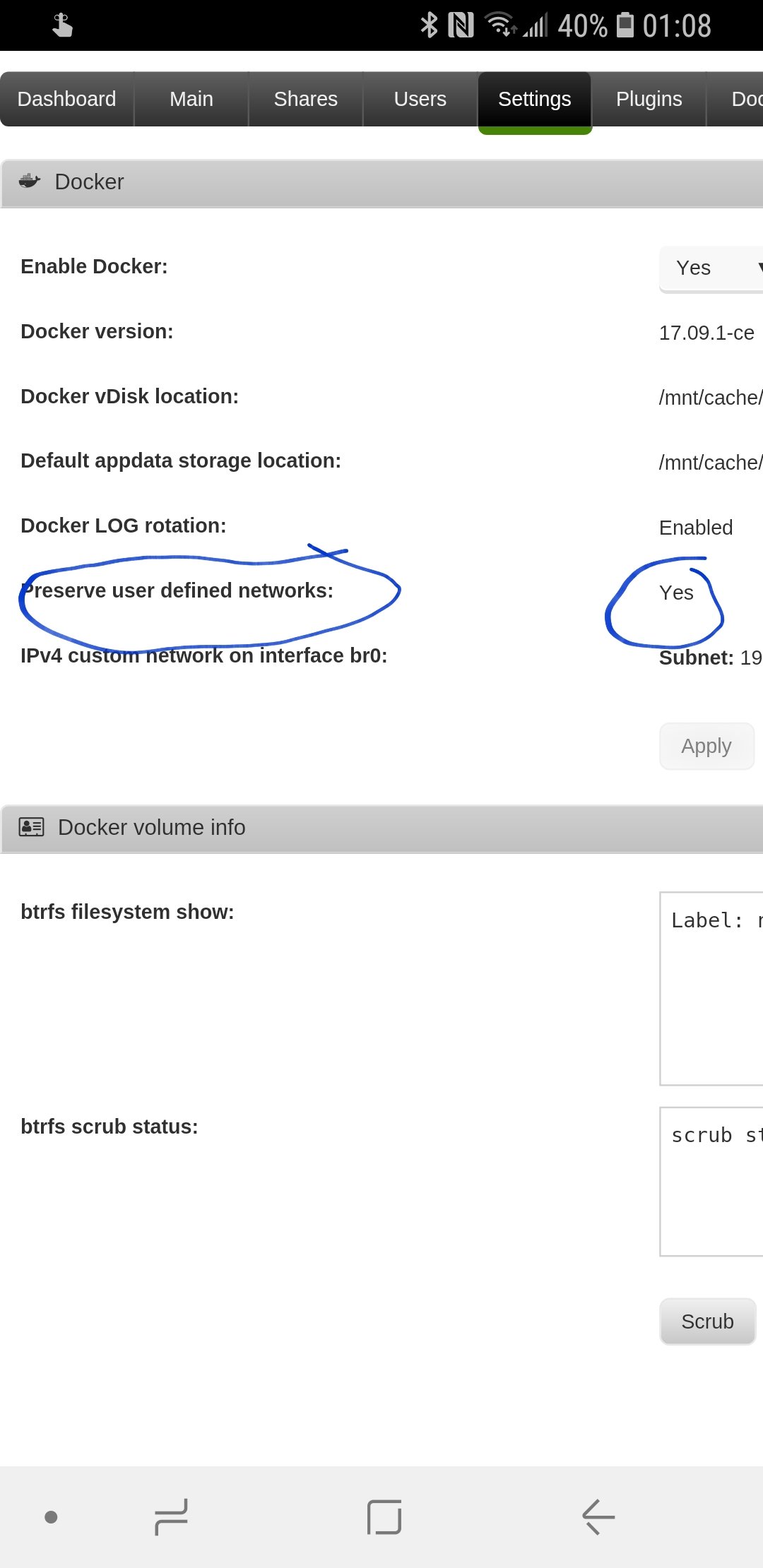

If you are using unraid, create a custom network in command line, then go to docker service settings (under advanced) and
set the option "Preserve user defined networks:" to "Yes". Then in each container setting, do one of the following:
  2) Unraid 6.5.1 or later - in the network type dropdown, select "Custom : [networkname]".
  You would have to do the above for the letsencrypt container as well, so they are all on the same custom network.

Creating a custom network in command line, just four lines above: https://github.com/linuxserver/docker-letsencrypt/blob/master/root/defaults/proxy-confs/_readme#L24
The preserve setting is under docker settings, advanced view (see screenshot). The rest is in container settings. It says "Then in each container setting, do one of the following:" so you need to look for that option in container settings, not docker settings.
I recommend reading the entire document first, before attempting changes so you understand all the steps first.

OMG it worked, thank you @aptalca. I will make a donation. I must say it is extremely difficult for a docker newbie to figure out. No other docker approached this level of troubleshooting. Thanks for walking me through. I may create a user friendly guide.

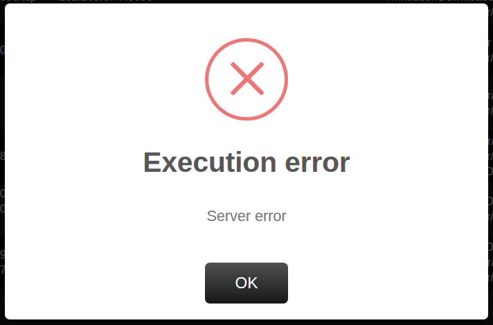

Hello guys.
I'm having a little trouble right from the start. So I installed the docker, but I get an execution error(server error) when I try to start it.
When I try to change the ports I get this error message:
/usr/bin/docker: Error response from daemon: driver failed programming external connectivity on endpoint letsencrypt (562d830479261e90e8ad0a784fb2d05da0e1e122aae19e393fab7bf4d4c5bcc8): Error starting userland proxy: listen tcp 0.0.0.0:445: bind: address already in use.
The command failed.
What am I doing wrong? (I am running on Unraid 6.5.0)

It says that port 445 is in use by something else. Pick a different port
