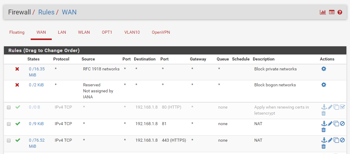

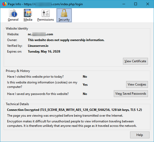

I have been getting a certificate error from the letsencrypt docker.
The cert appears to be self-signed, but shows as verified by linuxserver.io. I have purchased my own domain name, and it is running through cloudflare (caching off) so that I can use DNS domain validation with letsencrypt because my ISP (COX) blocks port 80 so I can't do http validation. Here's my letsencrypt output:
_ ()
| | ___ _ __
| | / __| | | / \
| | \__ \ | | | () |
|_| |___/ |_| \__/
Brought to you by linuxserver.io
We gratefully accept donations at:
https://www.linuxserver.io/donations/
GID/UID
User uid: 99
User gid: 100
[cont-init.d] 10-adduser: exited 0.
[cont-init.d] 20-config: executing...
[cont-init.d] 20-config: exited 0.
[cont-init.d] 30-keygen: executing...
using keys found in /config/keys
[cont-init.d] 30-keygen: exited 0.
[cont-init.d] 50-config: executing...
Variables set:
PUID=99
PGID=100
TZ=America/New_York
URL=mydomain.com
SUBDOMAINS=www,ftp,nc,ari43dou,minio-ari,minio-marty,testing
EXTRA_DOMAINS=
ONLY_SUBDOMAINS=false
DHLEVEL=2048
VALIDATION=dns
DNSPLUGIN=cloudflare
[email protected]
STAGING=
Backwards compatibility check. . .
No compatibility action needed
2048 bit DH parameters present
SUBDOMAINS entered, processing
Sub-domains processed are: -d www.mydomain.com -d ftp.mydomain.com -d nc.mydomain.com -d ari43dou.mydomain.com -d minio-ari.mydomain.com -d minio-marty.mydomain.com -d testing.mydomain.com
E-mail address entered: [email protected]
dns validation via cloudflare plugin is selected
Certificate exists; parameters unchanged; attempting renewal
cronjob running on Sat May 19 14:04:49 EDT 2018
Running certbot renew
Saving debug log to /var/log/letsencrypt/letsencrypt.log
Processing /etc/letsencrypt/renewal/mydomain.com.conf
Cert not yet due for renewal
The following certs are not due for renewal yet:
/etc/letsencrypt/live/mydomain.com/fullchain.pem expires on 2018-08-17 (skipped)
No renewals were attempted.
No hooks were run.
[cont-init.d] 50-config: exited 0.
[cont-init.d] done.
[services.d] done.
Server ready
How can I resolve this so the certs are good?
Thanks,
Ari

I don't see where it says self signed, but verified by linuxserver is weird. Did you perhaps edit your site config and change the cert location to point to the wrong cert? There is a self signed cert in there which is created by the nginx baseimage
9 hours ago, ucrbuffalo said:
I'm hoping someone here can help me out. I'm really starting to run out of any ideas to figure this out...

Did you log into duckdns to verify that the ip address they have is correct?

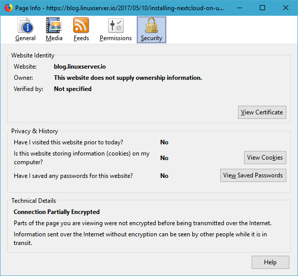

FWIW, I actually also get that same error at blog.linuxserver.io (but not at the base linuxserver.io page).

I'm not sure what error you are referring to. The two screenshots you posted do not contain a shared error amongst them

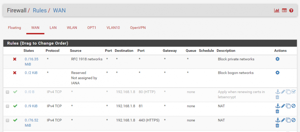

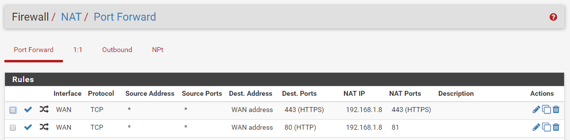

I am using pfsense and yes they are since I can reach my nextcloud from anywhere if I type https:// manually. and this docker is able to renew the certs using port 80, but now I have it enabled all the time. See attached files please. Where can I find the nextcloud config.php file? (Could really use a spoiler function to hide this wall of images :P )
