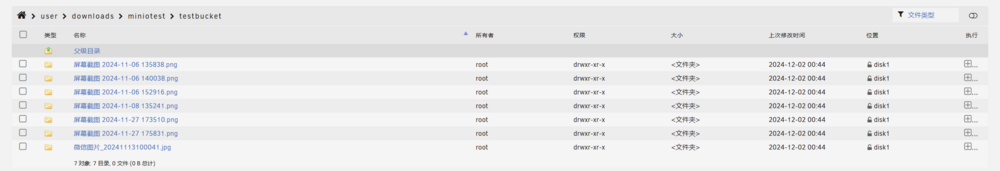

Based on the description from the MinIO app in unRAID and after doing some research, I understand that MinIO conflicts with how unRAID manages disks. Could you suggest some ways to make MinIO run smoothly without using a VM?
I'm currently considering two approaches:
- Adding a full disk as a pool (not in the main array) and letting MinIO use that entire disk (mounted at `/mnt/disk1`). However, I'm concerned about potential conflicts since unRAID still manages pool disks.
- Using the Unassigned Devices app to mount the disk. I believe this approach might be better since unRAID does not manage the disk this way. Am I correct?
Both will work without issues.
