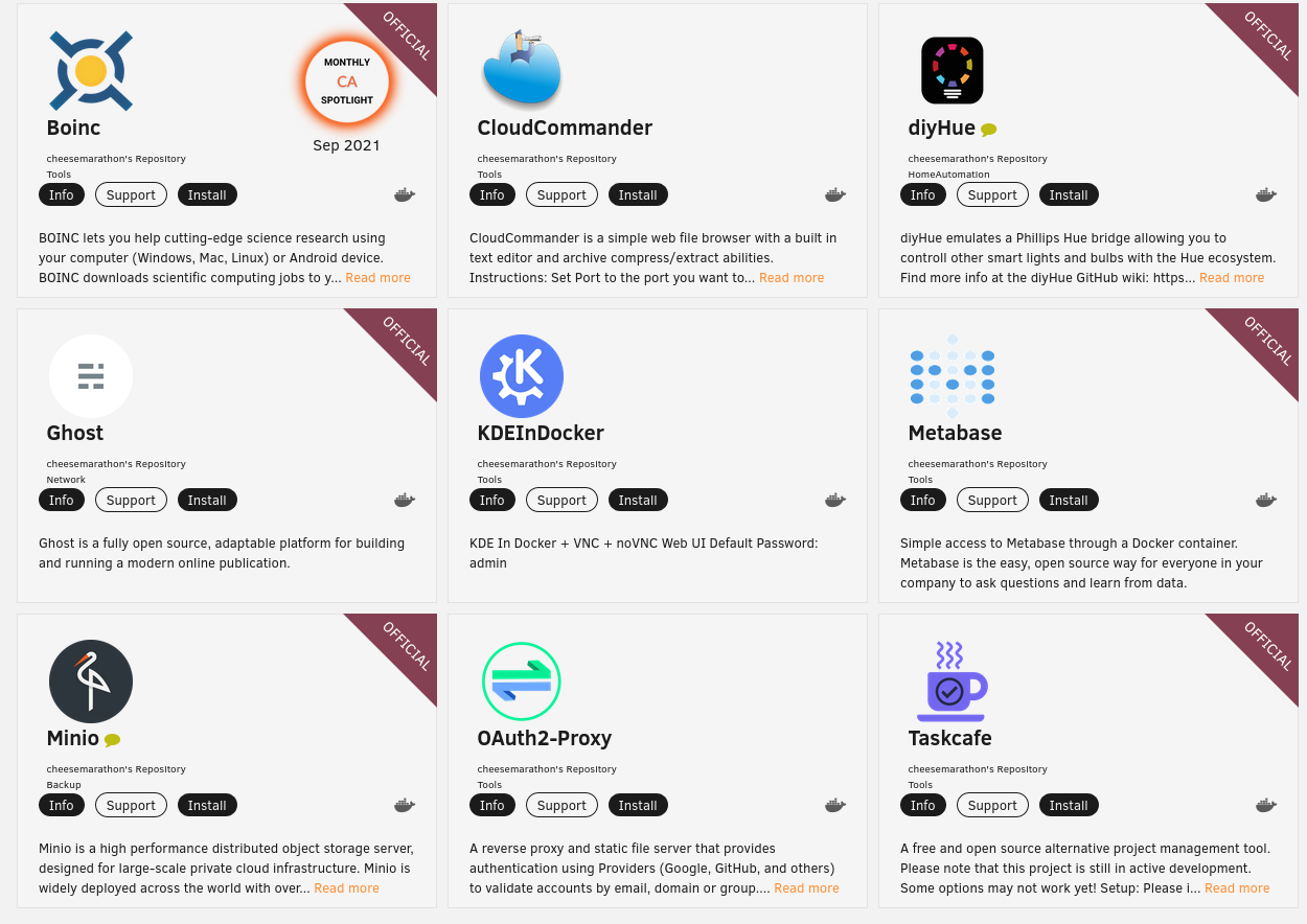

On 7/13/2023 at 1:10 PM, thescorpio32 said:
oh my bad, im using your container 'cheesemarathon repo', couldn't get IBRACORP's to work
10 hours ago, JonathanM said:
Yes those are all my templates. You mentioned you couldn't get one to autostart. Which one could you not get to start. You have none of the templates in your screenshot installed.
OH! - I feel terribly bad I haven't realized this isnt a 'ghost' thread - Sorry I was talking about the ghost container
OK so in the docker screen, tick the switch in the uptime column to enable auto start. Unraid will start the containers in the order they are on the screen. Make sure your database starts before ghost or it will fail to start.
Thanks, I had the orders messed up (ghost before the DB).
