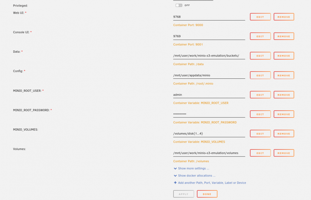

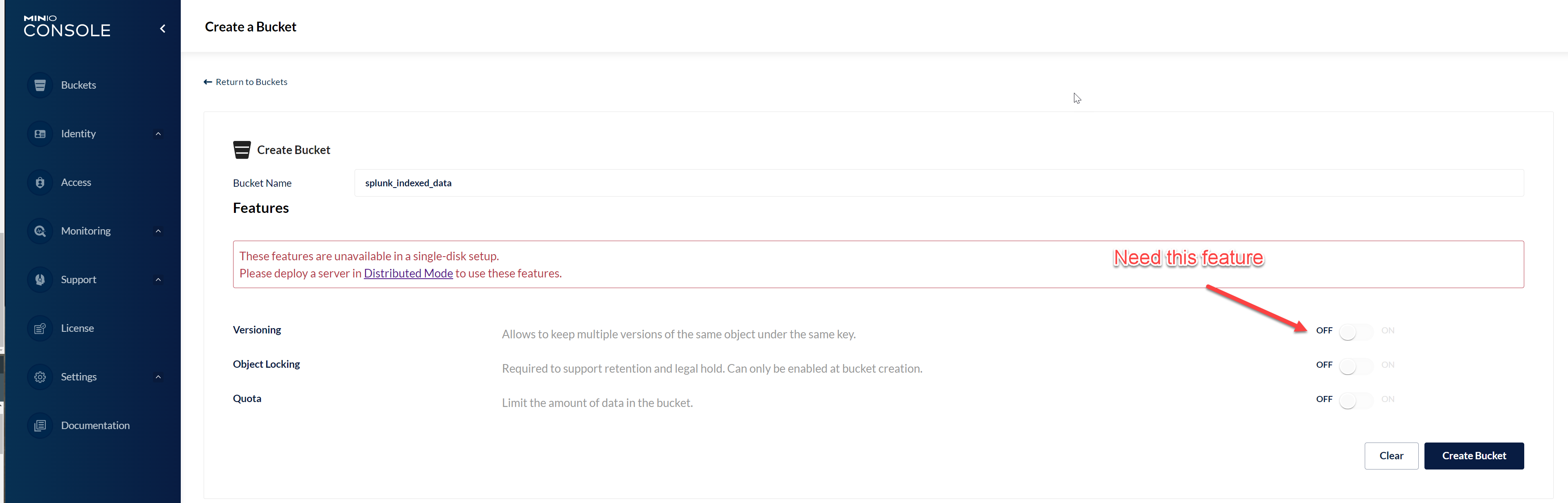

Hi All,
With the minio docker does anyone know how to activate versioning?
https://docs.min.io/docs/minio-bucket-versioning-guide.html
I think I canjust configure it with JBOD so in theory I'm guessing I need to provide the docker container 4x data mounts.
https://docs.min.io/minio/baremetal/installation/deploy-minio-distributed.html?ref=con
Just not sure where I would do this and what config file I would modify to tell minio which disks to use.
I'm trying to get versioning working because Splunk requires that functionality for the s3 SMART Store. I got directed to it based on this error in Splunk.
03-17-2022 13:13:16.487 +1000 WARN  S3Client [1018538 FilesystemOpExecutorWorker-0] - command=list-version transactionId=0x7f164b275a00 rTxnId=0x7f163edfce60 status=completed success=N uri=http://192.168.64.64:9768/splunk statusCode=501 statusDescription="Not Implemented" payload="<?xml version="1.0" encoding="UTF-8"?>\n<Error><Code>NotImplemented</Code><Message>A header you provided implies functionality that is not implemented</Message><BucketName>splunk</BucketName><Resource>/splunk</Resource><RequestId>16DD0C833CC165BD</RequestId><HostId>b41f06a4-5098-478c-8f12-53981d1b3743</HostId></Error>"
13 hours ago, phoenixdiigital said:
Hi All,
Don’t hold me to this as I have not tried it but I think you can creat a variable called MINIO_VOLUMES in the container settings and set it to. https://minio.example.net:9000/data/disk{1...4}/minio
you will also need to change the data variable to just /mnt so it can access all the disks
however be careful writing to specific disks as I’m not sure how unraid will respond to this.
if I had a test unsaid setup I’d give it a try myself but I only have a production server and I don’t want to screw with it 😂
Good luck
Edited by cheesemarathon

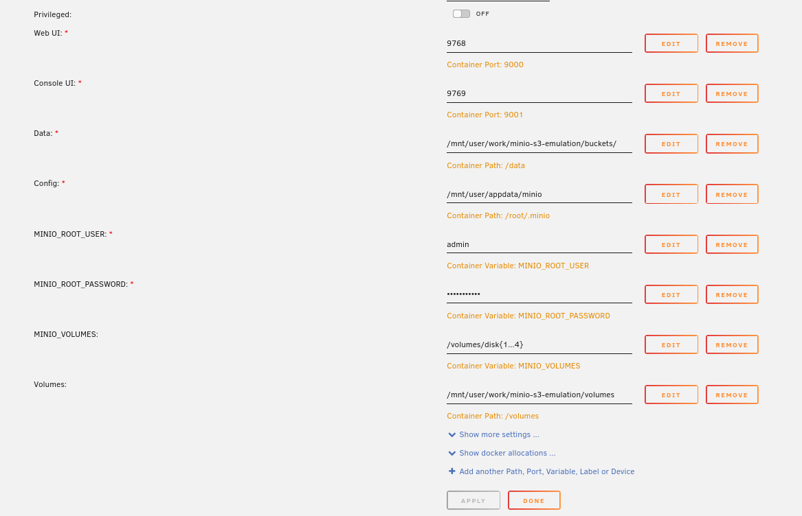

Thanks for the tip. I didn't try the /mnt config but did create the disk1, disk2, disk3 & disk4 into the /data mount.
The end result was just 4 new buckets disk1, disk2, disk3 & disk4.
So I tried this (see screenshot) and it didn't work either. Happy to do more reading/testing if you can point me in the right direction.
Edit: I think it's close based on this - https://docs.min.io/minio/baremetal/installation/deploy-minio-distributed.html?ref=con
Edited by phoenixdiigital
added info

I was watching my single Mino docker with multiple mounts lastnight with Splunk and there were constant warnings in Splunk like this
05-18-2022 22:32:24.593 +1000 WARN  S3Client [2494457 cachemanagerUploadExecutorWorker-2] - command=put transactionId=0x7ff4e0669000 rTxnId=0x7ff4ec475600 status=completed success=N uri=http://192.168.64.64:9768/splunk/_internal/db/c2/26/837~4C740B3B-CD91-4337-BE47-6EE5143CCE76/guidSplunk-4C740B3B-CD91-4337-BE47-6EE5143CCE76/1649801398-1649690860-5951626816833194436.tsidx statusCode=503 statusDescription="Service Unavailable" payload="<?xml version="1.0" encoding="UTF-8"?>\n<Error><Code>SlowDown</Code><Message>Resource requested is unreadable, please reduce your request rate</Message><Key>_internal/db/c2/26/837~4C740B3B-CD91-4337-BE47-6EE5143CCE76/guidSplunk-4C740B3B-CD91-4337-BE47-6EE5143CCE76/1649801398-1649690860-5951626816833194436.tsidx</Key><BucketName>splunk</BucketName><Resource>/splunk/_internal/db/c2/26/837~4C740B3B-CD91-4337-BE47-6EE5143CCE76/guidSplunk-4C740B3B-CD91-4337-BE47-6EE5143CCE76/1649801398-1649690860-5951626816833194436.tsidx</Resource><RequestId>16F0330008CD9A87</RequestId><HostId>3acb2a2c-41e2-45a6-952e-f32626479b3d</HostId></Error>"
It performed pretty badly across the board with other warnings too. Probably because all 4x "disk mounts" on the single Minio instance were on the UnRAID array so likely had additional overhead as data was being mirrored by minio and paritied by UnRAID. I ended up turning it off again.
Definitely keen to hear of your full setup. Maybe I'll try again.
I'm really just doing it so I can test out Splunk configs/behaviour with S3 SMART Store for my day job. Customers use real S3 stores so won't experience the performance issues I've seen.
