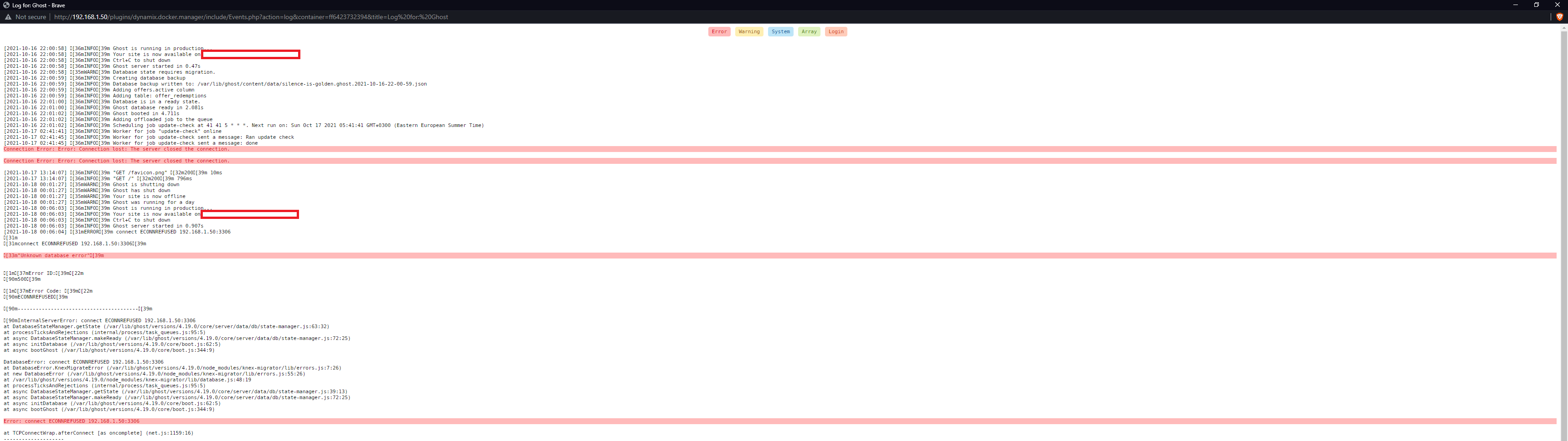

Hey CM.
Saw an update to the minio docker earlier today and hit the button to apply the update. Logged into the minio docker a short while later to check some settings and found that all the buckets were missing, add bucket button greyed out, no users, etc.
The log file had a warning that the version of minio was 2 days old and advised running the command 'mc admin update'. Attempted to run that command in the console but just got an error that the command mc was not found.
Dropped to an older version of the container (minio/minio:RELEASE.2021-11-24T23-19-33Z, I just kinda picked an older version at random) and everything is back to normal.
Is there something that needs to be done w/ the latest version of the minio docker to get it to function properly? Or maybe just a problematic update?
Thanks again for all your hard work.
okay, decided to try the latest then work my way back thru the tags. latest would not work, nor would the release from a day ago (minio/minio:RELEASE.2021-12-18T04-42-33Z), but the release from 10 days ago (minio/minio:RELEASE.2021-12-10T23-03-39Z) works fine. I skipped most of the hot fixes, and .fips versions (whatever those are).
