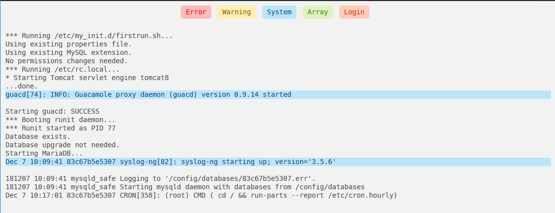

i did as you suggested, but that didnt seem to fix the issue.  links are to pastebin. Thank you for looking into this.
I just tested a clean install of this on my Unraid machine and it worked fine. I don't see anything that jumps out at me in your logs. Can you post your guacamole.config file and a screenshot of your Docker's configuration.

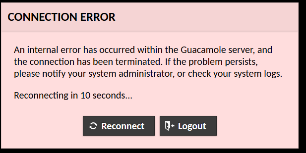

3 minutes ago, tamito said:
I tried to setup guacamole to VNC to firefox. However, I got a lot of java error in catalina.out. I totally follow the guidance from this source https://technicalramblings.com/blog/remotely-accessing-the-unraid-gui-with-guacamole-and-vnc-web-browser/ . It used to work before.
What was the error message you received on the screen when you tried to connect? What do your connection settings for this connection look like in Guacamole?
This is what I got.

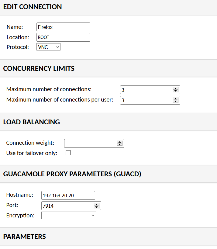

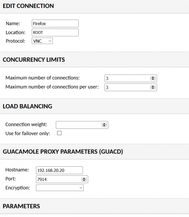

My connection setting is below.
I can use VNC viewer to access my Firefox docker. So I believe I may miss some setting in Guacamole.
You're probably going to kick yourself when I tell you this but move your hostname and port from the "proxy parameters" section down to the "parameters" section. That will fix it.
Oh I need to kick myself. I got it. I put in the wrong place.
