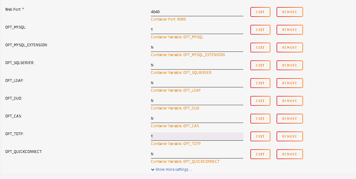

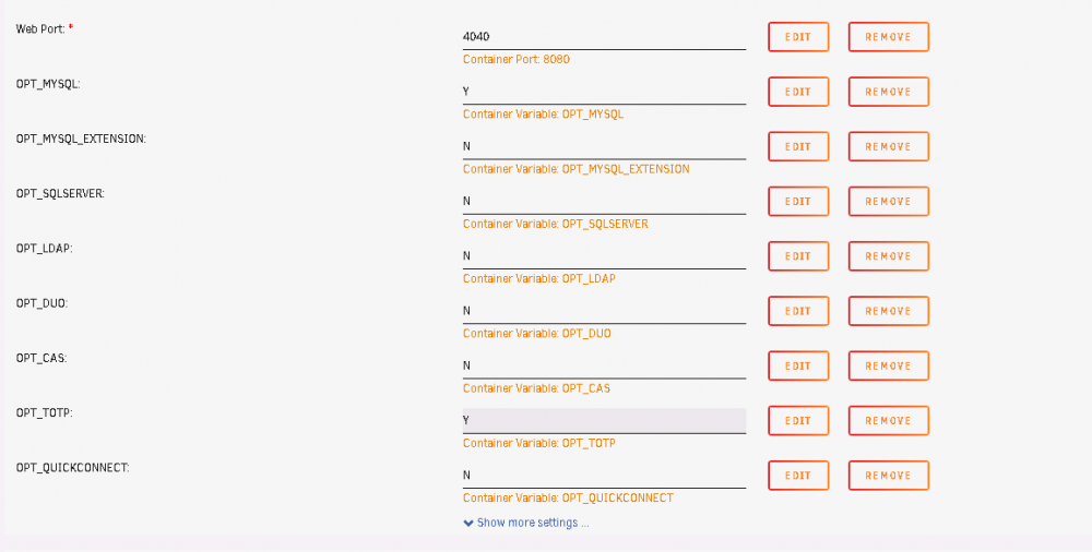

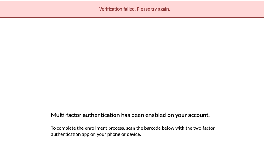

I am having an issue trying to enable TOTP on Guacamole.  I set the flag to 'Y', cleared cache, and got to the TOTP enrollment page.  When I try enrolling the screen snaps and the error "Verification failed. Please try again." shows at the top of the screen.  I have tried resetting the container, trying Google Authenticator and Authy (both on Android FWIW).  I looked at the container logs but cannot seem to find anything that indicates a problem.
After setting the flag to "Y" in the configuration, do I need to edit guacamole.properties?  I cannot seem to figure it out.
Thanks in advanced
Thomas
Edited by trb037
added screenshots.
@trb037 Do you have the latest version of the container? There was a problem some time ago where TOTP wasn't working correctly due to folder permissions. Can you please post your catalina.out file from right after you've attempted to login?

I don't see anything obvious. What browser are you using? Have you tried clearing your browser's cache or reload the page with ctrl-f5?

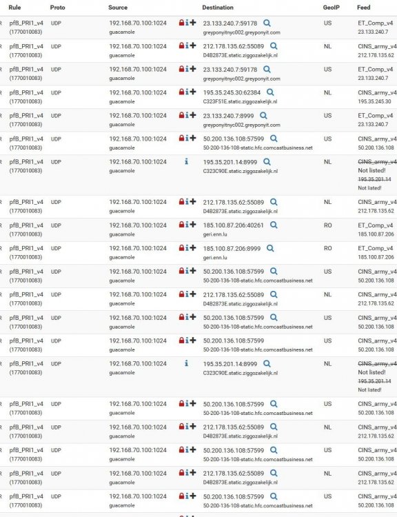

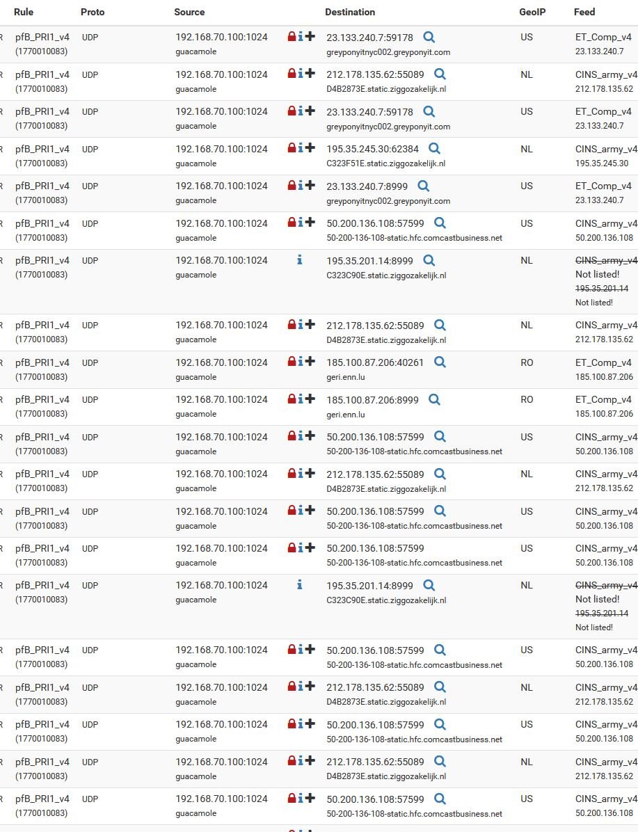

Anybody has this issue where Guacamole docker try to access these IP? My firewall blocks them.
I’ve not seen that. The ports don’t even correspond with anything Guacamole does. Sure you haven’t been hacked or have some kind of malware?
