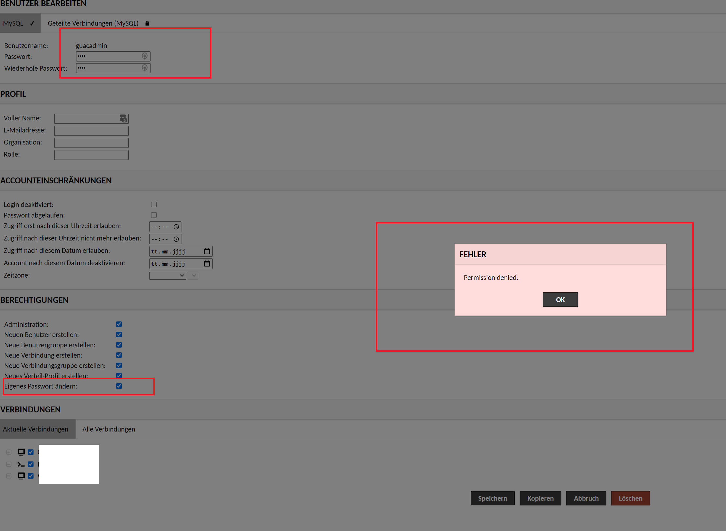

I would like to rename or disable guacadmin, how to do so?
I cant even seem to be able to change the standard password, it just says permission denied.. xD
Edited by nuhll
I would think that the user you're trying to do this with would need the proper permissions: Administer system, Create new users, etc.
@nuhll You would need to have at least one user that is able to administer system, create users, and create user groups.
This is logic. I created "test" and gave him all rights.
Okay, if ound the problem.
You NEED to be logged in as the 2. user before you can change the guacadmin account (you cant change your own password it seems)
You can change your own password if you have the “can change own password” permission. The guacadmin account should be able to change its own password unless you removed that permission.
Nope.
Edited by nuhll
Nope.
Did you try a longer more complex password? I changed my guacadmin password a long time ago so I know it’s possible. I used a rather long complex password though.
@nuhll Have you tried logging in as guacadmin and then going to Settings and then Preferences? You can change the password there.
The screen i shared IS while logged into GUACADMIN.
When i log into my 2. user i can change the password of guacadmin tho, but this is very unintuitive... ;)
Edited by nuhll
To change the logged in user’s password you have to go to the Preferences tab. It makes sense for security purposes so someone can’t blindly change the logged in user’s password without knowing their current password.
Actually this doenst make any sense, but when i k now it i can work with that.
You cant change your own password because of security reasons if you dont know your own password, but you can change all other passwords without knowing theirs... xD
anyway, thanks for the help, i simply disabled the guacadmin. :)
