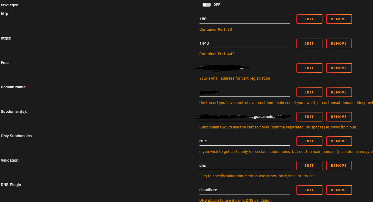

Swag docker settings:

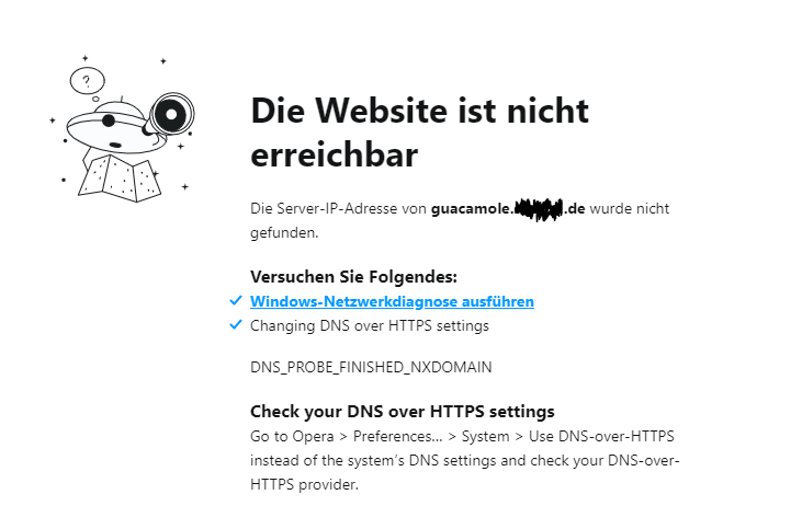

@stFfn The error you’re getting has to do with DNS. It stands for “non-existent domain”. Somewhere it’s misconfigured. I would recommend trying with a CNAME and point to your primary A record. In fact, for my domain I use Cloudflare. All my hostnames are CNAME to my primary A record which gets updated when my IP changes. It is my only A record.

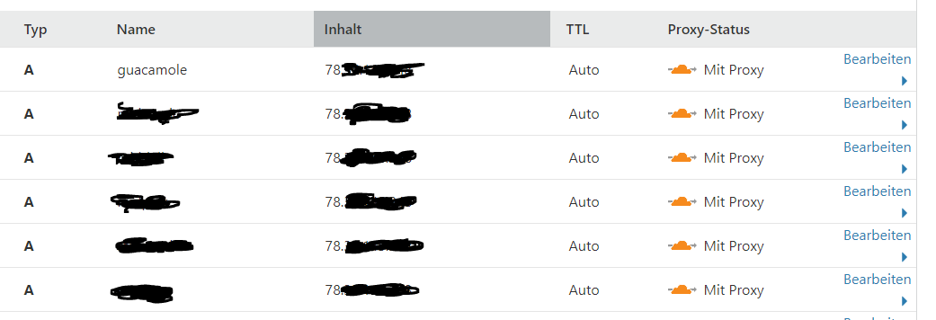

the guacamole.domain.de is definitly set on cloudflare and it has an a record to my Internet IP like all the other dockers that work.

I don’t know. It’s either that or you mistyped your domain name in the address bar. Only way Chrome would give you that specific error.

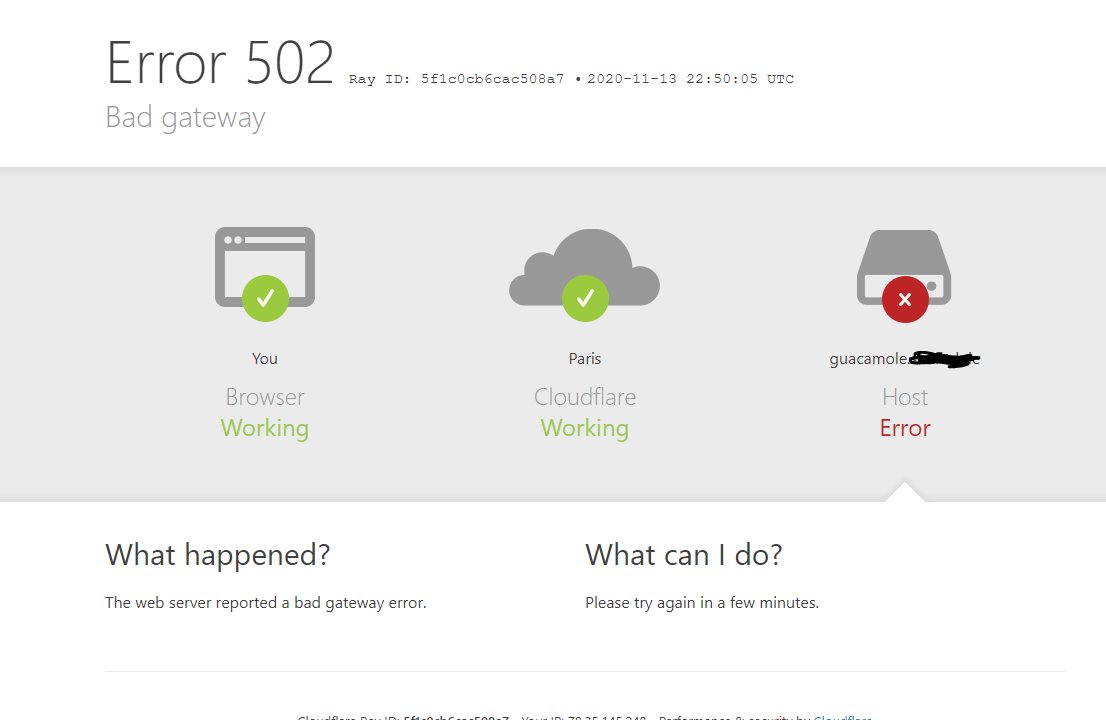

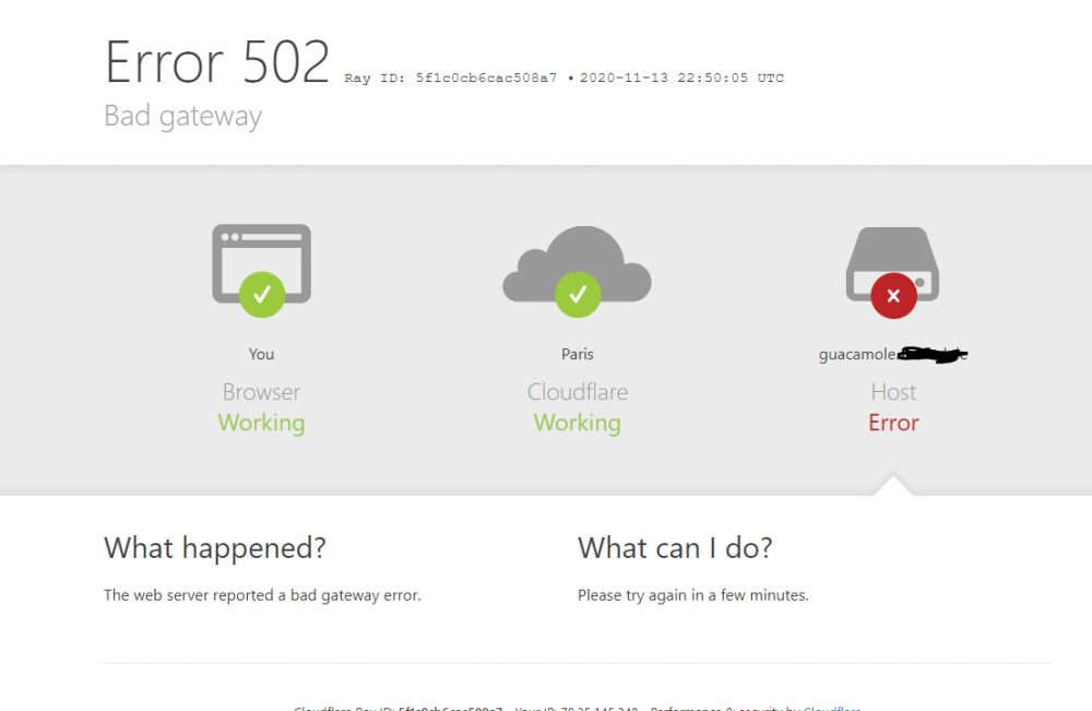

and somehow im getting this error today...
5 minutes ago, stFfn said:
there is no typo because i always copy past when doing stuff like that to prevent mistakes.
That means your reverse proxy isn’t working. As far as I know the Docker DNS that Swag uses only works for a custom network type. Not for br0. On mine I had to point it to my Unraid server’s IP address and Guacamole port.
