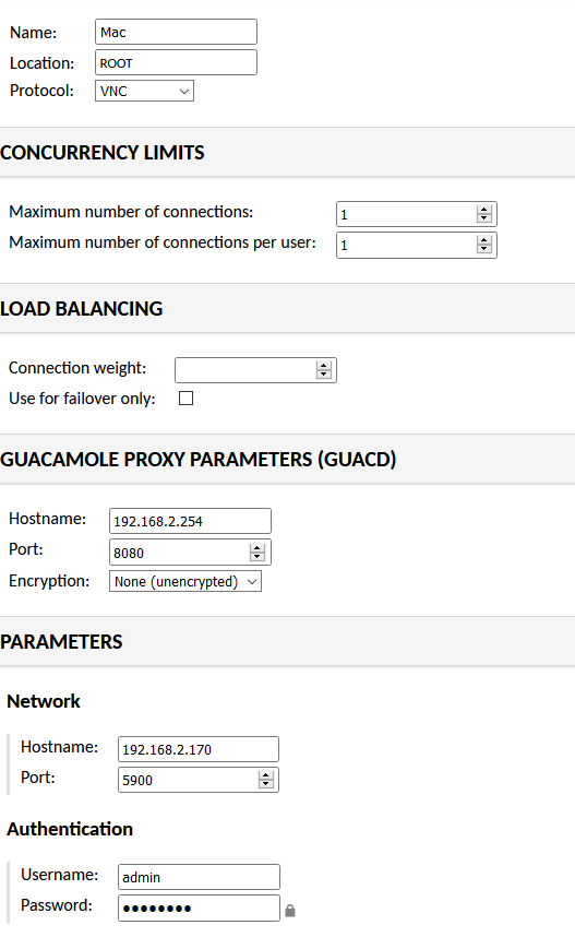

2 minutes ago, joshallen2k said:
I’ve installed guacamole and got it working with a win10 VM over rdp. Where I am stuck is connecting to a Mac VM. I watched spaceinvader one’s video where he shows setting it up for different VM’s but he doesn’t cover off Mac (although claims to in the intro).
I have turned on the screen sharing in the Mac VM, but not sure what needs to be set for guacd proxy parameters, and for the network parameters (host and port). Can someone help? Thanks so much
Mac’s screen sharing is through standard VNC. Normal port 5900.

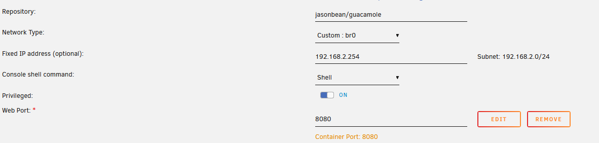

Here is my docker settings as well as my connection details inside guacamole. Something with this setup is not working.

@joshallen2k To be more exact the proxy parameters are only needed when guacd itself is located separately on a different computer or container. Since it is located within the same container as the client (web GUI) those settings can always be empty.
Perfect. That worked. Case closed. Thank you.

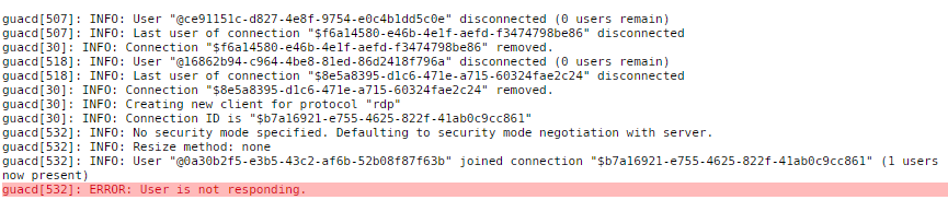

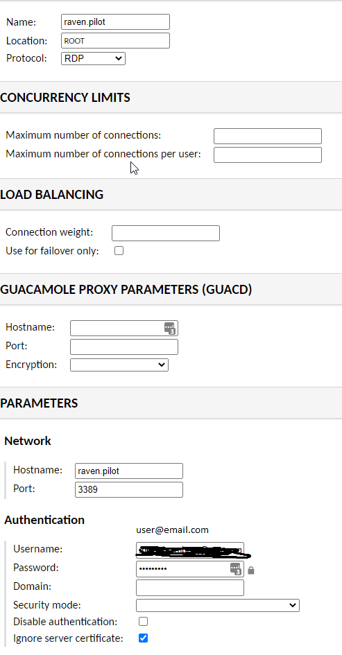

So I tried to setup this today using Spaceinvaders guide. The problem is that network limitations are not really discussed in that video and I believe it causes a lot of problems for many. I first set it up using bridged network. But in that mode I WOL packets did not work but all my other connections to my remote machines worked. So I tried to setup in a separate network with "allow custom" networks in docker enabled. But now I can't connect to my main computer anymore. RDP connections to my work laptop worked both with bridged and separate network so what gives? The work laptop is domain joined so settings are a bit different but it seems kinda of weird? This is the error I get when I try to connect. Both my laptop and my phone can connect to my main computer without a problem at all while guacamole struggles.
Settings:
Why is it like this?
Hoping someone can help.

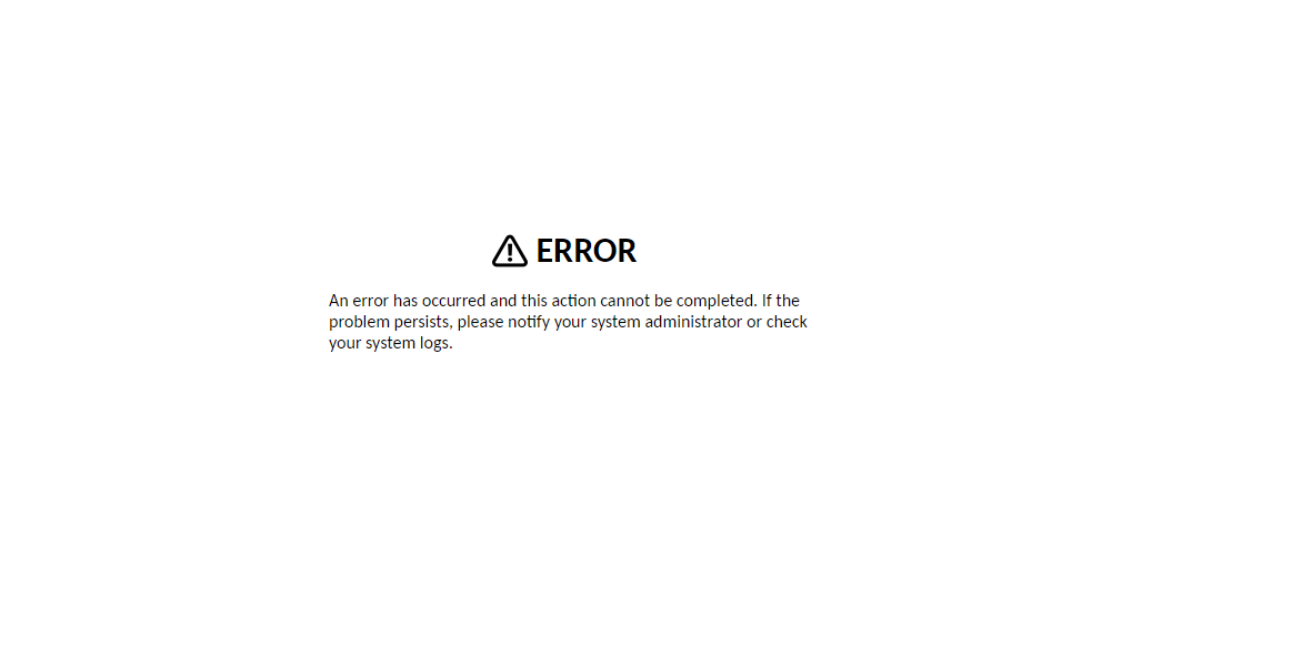

Today I edited the container and added a path to a Share for RDP to enable file transfer, did nothing else and now it wont start again.
Restarted, etc nothing works..............................................
I am no linux wiz kid so I cannot understand what caused this.

@Michel Amberg may tried ip instead hostname, i use it on custom bridge and can connect to an rdp desktop, but i use ip instead hostname

Sorry I meant path not patch. Super strange though, I only added a path to a share so that I could use file upload and download in RDP, changed no other setting. after adding the path and clicking I could no longer use Guacamole.
