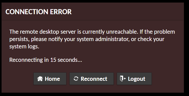

Hello,
I was using AG with no issue and recently have ran into this concern
I can connect to everything else but this one system. I can't see to track down what the concern may be. Anyone else have this concern?
guacd[758]: INFO: User "@5835a4e1-fbd6-4273-a68c-b90cb9634f11" disconnected (0 users remain)
guacd[758]: INFO: Last user of connection "$bc849b57-11d4-4807-83b1-39f9b0482739" disconnected
guacd[30]: INFO: Connection "$bc849b57-11d4-4807-83b1-39f9b0482739" removed.
guacd[30]: INFO: Creating new client for protocol "rdp"
guacd[30]: INFO: Connection ID is "$0b6b9bd1-1933-4d62-81a3-065b121a6a41"
guacd[775]: INFO: Security mode: NLA
guacd[775]: INFO: Resize method: display-update
guacd[775]: INFO: User "@491f6ba2-db58-42e9-adcd-30d53c12f8e7" joined connection "$0b6b9bd1-1933-4d62-81a3-065b121a6a41" (1 users now present)
guacd[775]: INFO: Loading keymap "base"
guacd[775]: INFO: Loading keymap "en-us-qwerty"
guacd[775]: INFO: RDP server closed/refused connection: Connection failed (server unreachable?)
guacd[775]: INFO: User "@491f6ba2-db58-42e9-adcd-30d53c12f8e7" disconnected (0 users remain)
guacd[775]: INFO: Last user of connection "$0b6b9bd1-1933-4d62-81a3-065b121a6a41" disconnected
guacd[30]: INFO: Connection "$0b6b9bd1-1933-4d62-81a3-065b121a6a41" removed.
guacd[30]: INFO: Connection ID is "$c4cf9241-1f9f-4654-8db4-305ccbb9228f"
guacd[792]: INFO: Security mode: NLA
guacd[792]: INFO: Resize method: display-update
guacd[792]: INFO: User "@5cff0582-cef0-415e-9bdf-ea8e431fd464" joined connection "$c4cf9241-1f9f-4654-8db4-305ccbb9228f" (1 users now present)
guacd[792]: INFO: Loading keymap "base"
guacd[792]: INFO: Loading keymap "en-us-qwerty"
guacd[792]: INFO: RDP server closed/refused connection: Connection failed (server unreachable?)
EDIT:
It seems that Windows Firewall prevents the connection now (maybe a windows update).
Disabling Windows firewall or allowing RDP via the workstation firewall resolves this concern.
What is strange, in the past, Windows firewall did not need the RDP exception set (enabled) to make the connection to the workstation via AG/RDP.
Anyone else see this change as of recent?
Thanks,
Edited by bombz

10 minutes ago, Taddeusz said:
@bombz What do the connection settings look like? You want to make sure the settings under "GUACAMOLE PROXY PARAMETERS (GUACD)" are empty and the hostname or IP address you're connecting to is in the "PARAMETERS" section.
Hello,
Yes that is correct.
Hostname = internal IP of system
Port = RDP port
Confirmed -- "GUACAMOLE PROXY PARAMETERS (GUACD)" are empty
I was messing around with the local workstations 'Windows Firewall'
It seems:
  • Disabling the local workstations firewall allows AG to connect
  • Adding the RDP exception to the windows firewall (while the firewall is enabled) works as well
However, I am worried that may be a potential security risk of the sort.
Thoughts?
@bombz It should be fine. AFAIK exposing the RDP port is the only way to connect to a Windows machine. Otherwise it's going to be blocked just like you've experienced. There's always risk to everything but as long as the machine is behind a router firewall and not connected directly to the internet it should be fine.
Fair enough.
Find it odd the change required on the workstation side, never had to have RDP exception enabled on the local workstation in the past and was functional with AG.... It makes sense it needs to be, was puzzled was all of what changed recently.
Thanks again for the support and fast response, I wasn't sure if this thread was 'dead'
Appreciate it !

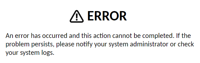

Trying to overachieve here and get Guac working with a separate MariaDB. I followed the spacer invader mariadb nextcloud instructions to make a guacamole user and db with all the privileges. Then I copied and pasted the schema instructions into mariadb console with the db selected and it seemed like it worked. Then I did the same to create the guacadmin user.
But when I go to WebGUI of Guac I get an error.
I've got guacamole.properties set as:
guacd-hostname: localhost
guacd-port:     4822
mysql-hostname: x.x.x.x (unraid server)
mysql-port: 3306 (port MariaDB is running on x.x.x.x)
mysql-database: guacamole
mysql-username: guacamole
mysql-password: <password>
What am I missing? The container log doesn't show the error.
Here is my docker command:
root@localhost:# /usr/local/emhttp/plugins/dynamix.docker.manager/scripts/docker run -d --name='ApacheGuacamoleNoMariaDB' --net='br0' --ip='<x.x.x.x>' --privileged=true -e TZ="America/New_York" -e HOST_OS="Unraid" -e 'TCP_PORT_8080'='8080' -e 'OPT_MYSQL'='Y' -e 'OPT_SQLSERVER'='N' -e 'OPT_LDAP'='N' -e 'OPT_DUO'='N' -e 'OPT_CAS'='N' -e 'OPT_TOTP'='N' -e 'OPT_QUICKCONNECT'='N' -e 'OPT_HEADER'='N' -e 'OPT_SAML'='N' -e 'PUID'='99' -e 'PGID'='100' -v '/mnt/user/appdata/ApacheGuacamoleNoMariaDB':'/config':'rw' 'jasonbean/guacamole:latest-nomariadb'
f680bbad75f308849fd002e1e88f1853a6fd4d407c104218fc044bf23571fa1c
The command finished successfully!
If I set OPT_MYSQL to N then it works fine. But I like the idea of a separate MariaDB like all my other containers.
Figured it out... my docker is on br0 on a separate ip within my LAN subnet. By design, it can't ping any other docker including mariadb. Guess I need to add a rule for MariaDB or figure out another way.
Edited by bigbangus
@bigbangus Do you have your container’s network type set to a custom network? If so you probably need to have “Host access to custom networks” enabled in your Docker settings.
Edited by Taddeusz
Yup that fixed it. What do you recommend as best practice here on how to set this up? Am I opening up a security risk here by enabling that? At this point just following space invader's video for the setup, but open to ideas since I'm using external db.
