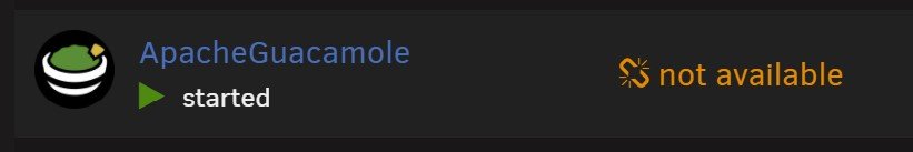

Solved I think
Where Unraid typically says "Up to date" next to Guacamole(under version column) today it says "Not Available."
I see lots of talk above about updates etc and I don't particularly want to break things.
Any Advice on how to proceed?
All the thanks,
Blaine
EDIT: I ran "check for updates" again and it solved it. None the less; is it considered stable enough to upgrade to 1.4? @Taddeusz thank you, thank you for all your work on this mate. 🙂

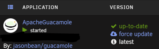

All good here - Unraid
https://registry.hub.docker.com/r/jasonbean/guacamole/
Repository: jasonbean/guacamole

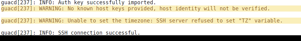

@Masterwishx Did you create the key in the open OpenSSH format with the ssh-keygen utility? According to the Guacamole documentation it must be in the OpenSSH format.
i made a key in putty-keygen *.ppk for putty then converted to 3 type that putty can convert :
openSSH, OpenSSH new and OpenSSH .com .
Tryed them to put in Guacamole but after asking for password and im entering im getting -  internal Guacamole Server Error ...
Yes , i tryed and its not worked , but tryed now and its working  without public key entered.
should i enter also public key of server?
its connected but without a public key included
@Masterwishx A little out of my knowledge. Maybe someone else can chime in. I’ve only ever used username/password for SSH.
